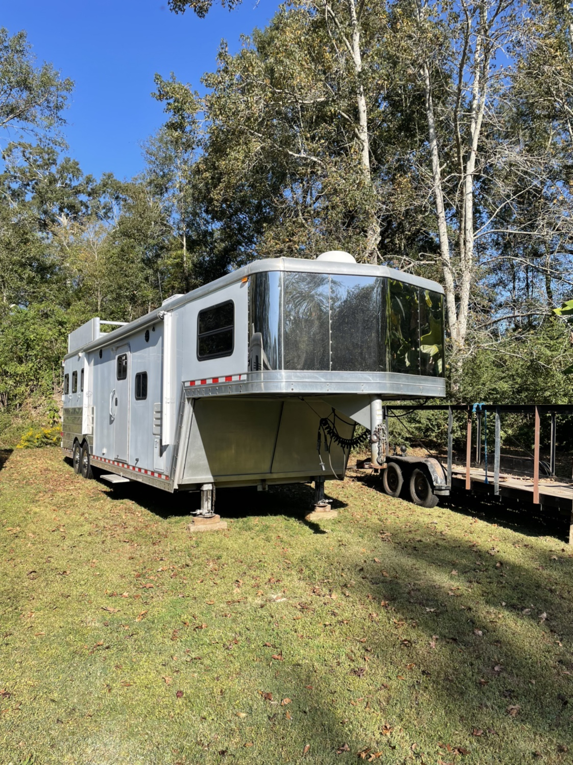

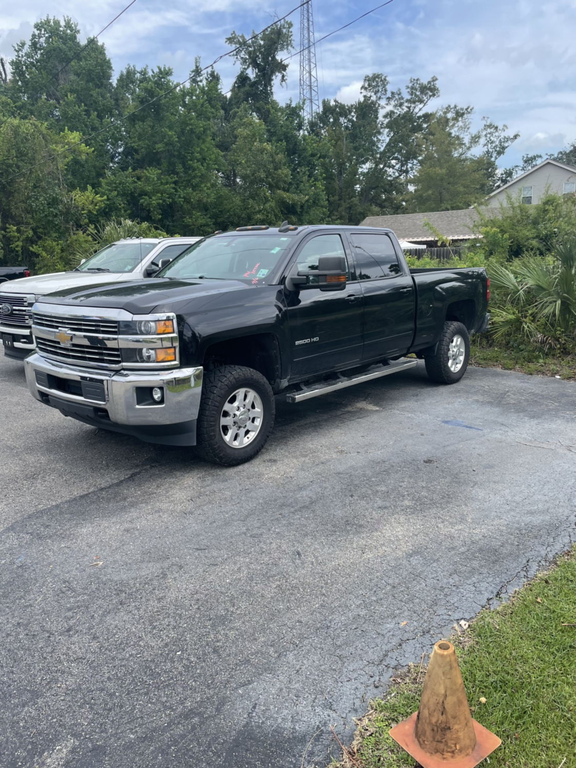

We may have the opportunity to use the trailer in the attached picture- 3 horse with living quarters. We will pull it with our 2015 Chevy 2500 with the 6.0 gas and 4.11 gear. I attached a picture of the trailer, trailer tag and truck. Not sure what it weighs, hopefully one of you know. Too much for the truck?

From the picture it looks like your truck is a short bed truck. Is there room for the trailer to swing as you make a turn? The 6.0 and 4.11 gears will pull the trailer with no problem. I have a 2005 GMC 2500 HD 4x4 and used it to pull a 28 foot 14,000 pound gooseneck over 300,000 miles. My 3500 GMC dually pulls it much better then 6.0.
I agree that you need to check the tongue weight. The trailer has 2 7200 pound axles so you should be well under 26,001.
The weight of the truck is 9500 plus the trailer's 14400 equals 23,900 pounds is well under the 26,001 that would require a CDL.
