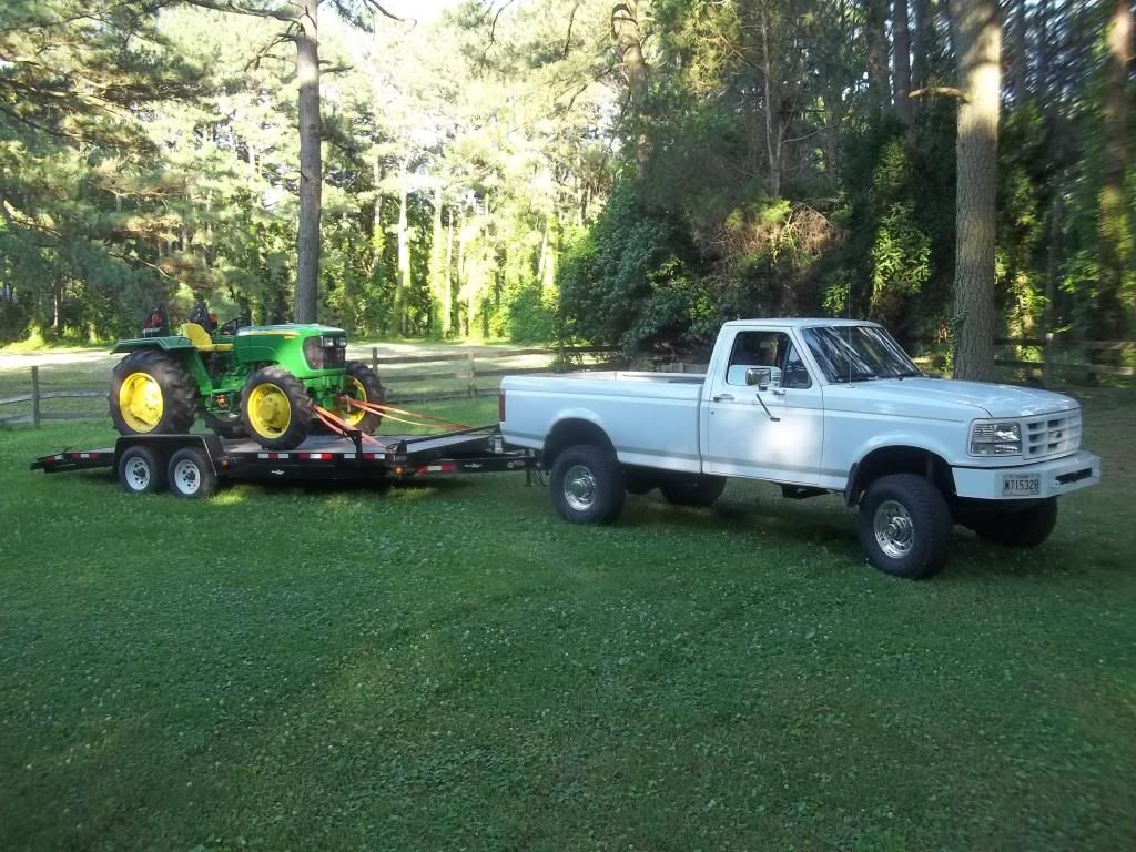

i have a down2earth car hauler. i thought i had pics of just the trailer, but it appears i do not
also had a 17.5ft fatherlite 7K lbs it weighed 1400.

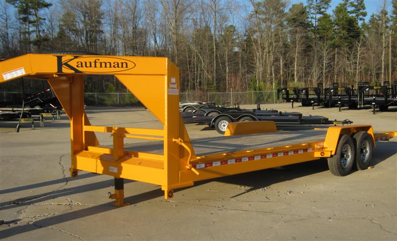

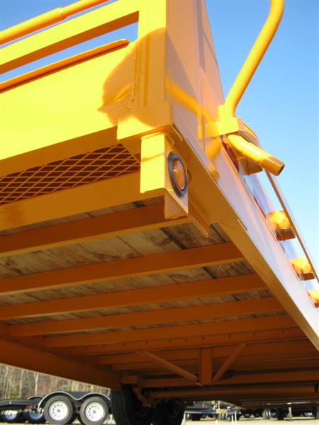

I need a gooseneck, so this one from Kaufman is on my wish list. :thumbsup:
12-19-11 041 (Medium).jpg 12-19-11 011 (Medium).jpg 12-19-11 014 (Medium).jpg 12-19-11 028 (Medium).jpg
15K 15,000 GVWR / 24 ft. Equipment Tilt Gooseneck Trailer - DELUXE - Kaufman Trailers
Or 17K 17,000 GVWR / 24 ft. Equipment Tilt Gooseneck Trailer - DELUXE - Kaufman Trailers

the axle ratings seem a little low to support a load of 10,000- my trailer is similar to what you are looking for (tilt ) , but lists 6 k axles and has 8 lug wheels and it lists the trailer load rating of 10k lbs.
firewood 2013 001.JPG I agree that getting a little more trailer than you think you need- is a good idea

I have the 24 Kaufman 10 foot fixed trailer for 2 years now. Best trailer at a great price IMO. Look close at other trailers. Kaufman sends out tractor trailer loads of no decal trailers. The other dealers and manufactures but there decals on them. I have been very happy with mine and have owned and pulled several trailers for 25 years. Tilt is the only way to go.

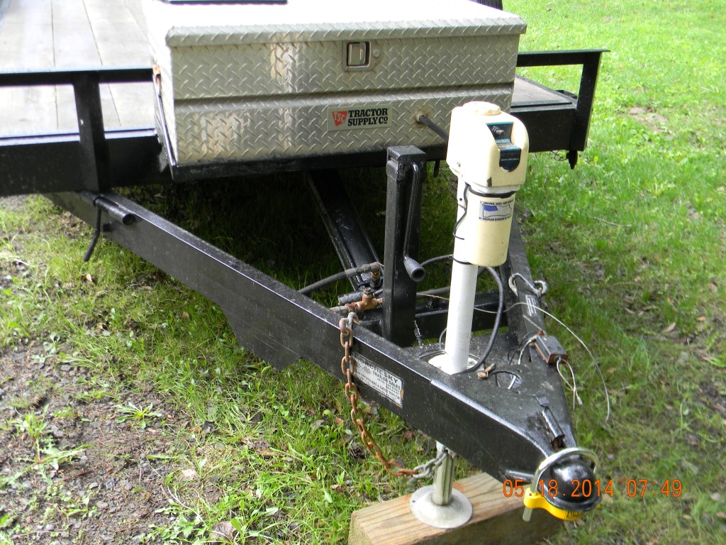

I am looking at all brands. I've had many trailers over the years. Even built several myself. I've been very happy with the full tilt over the past 8 years. It's still in great shape. I've had to repaint it every couple years or so. Replaced all 4 brakes complete, replaced the rims and upgraded the tires last year. I really don't want to sell mine but do need to upgrade my weight rating and maybe add a couple feet in length. Thanks for all the comments so far. I am taking all into consideration. Attached a few pics of my H&H full tilt.
