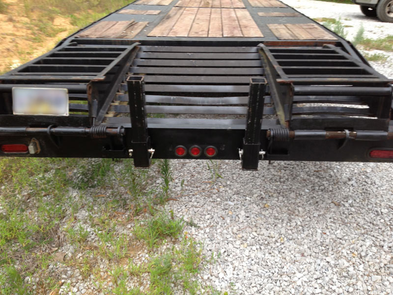

Here is what I added to my 10 ton gooseneck. Couldn't add jacks to the side, because it would've been over the legal width. These have worked great, loaded a 18K dozer and no more lifting the rear of the truck, or worse, having the ramps fold up into the ripper.
272381d1341640901-jacks-rear-trailer-eliminate-dip-img_0218.jpg IMG_0217.jpg
I also don't think slide in ramps would work form my trailer and loads. Those type ramps get pretty heavy when you want to load 18-20K.
