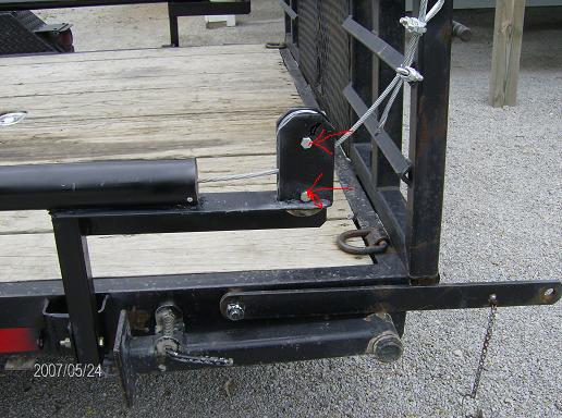

My 16' trailer uses legs instead of jacks, just swing them down when loading & back up to store. Legs are a couple inches off the ground when empty, you can back up or pull forward if there is too much weight on them when loaded to swing them back up! ~~ grnspot
