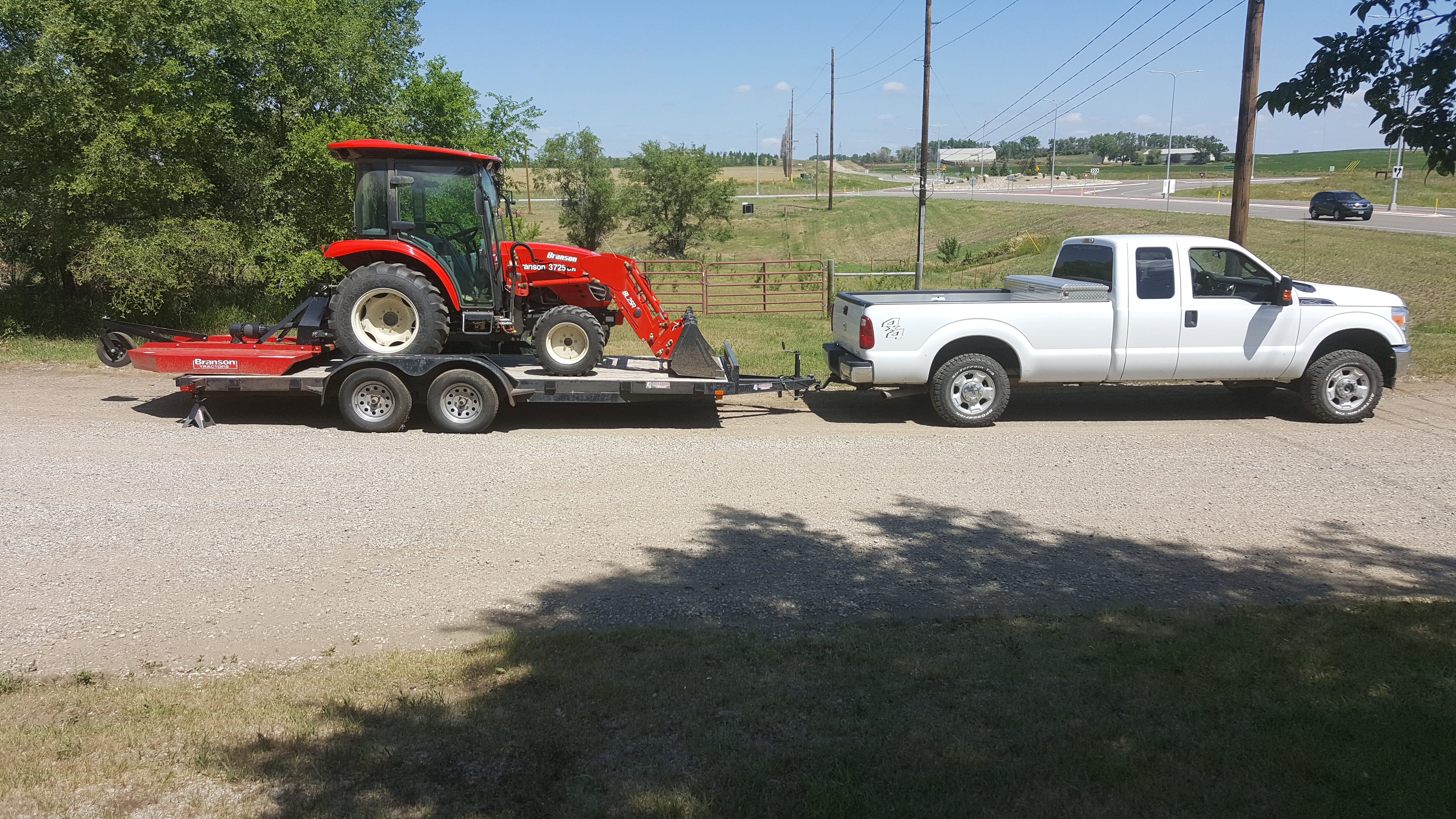

I have an 18' car trailer. The only time I have any length issues is when I put my 6 ft brush hog mower on the 3pt hitch. Then the mower extends past the back edge of the trailer by ~ 2'. If I had a 20' deck, it would be better, and a 22' would be perfect.
My next trailer will be a 24-28' deck over gooseneck, so I can set a couple of attachments on the trailer and still load the tractor.
   / Trailer purchase #12
Closing out this thread with info in case someone else is in my same boat I was. I ended up getting an L3901 and it is ~13 feet long with my front end loader attached. I found a used trailer with two 7000# axles that looks a little beat up, but was a reasonable price at $1500. So, if anyone else is trying to save money on a used trailer, you can readily put a CUT with FEL on a 16 foot trailer. Yes, the 20 foot trailers are more versatile, especially if I want to put the tractor on the trailer with implements on the 3 point hitch. However, I'll take the savings of $1700+ for getting the used trailer over the extra length for now. Thanks again for everyone's input.
