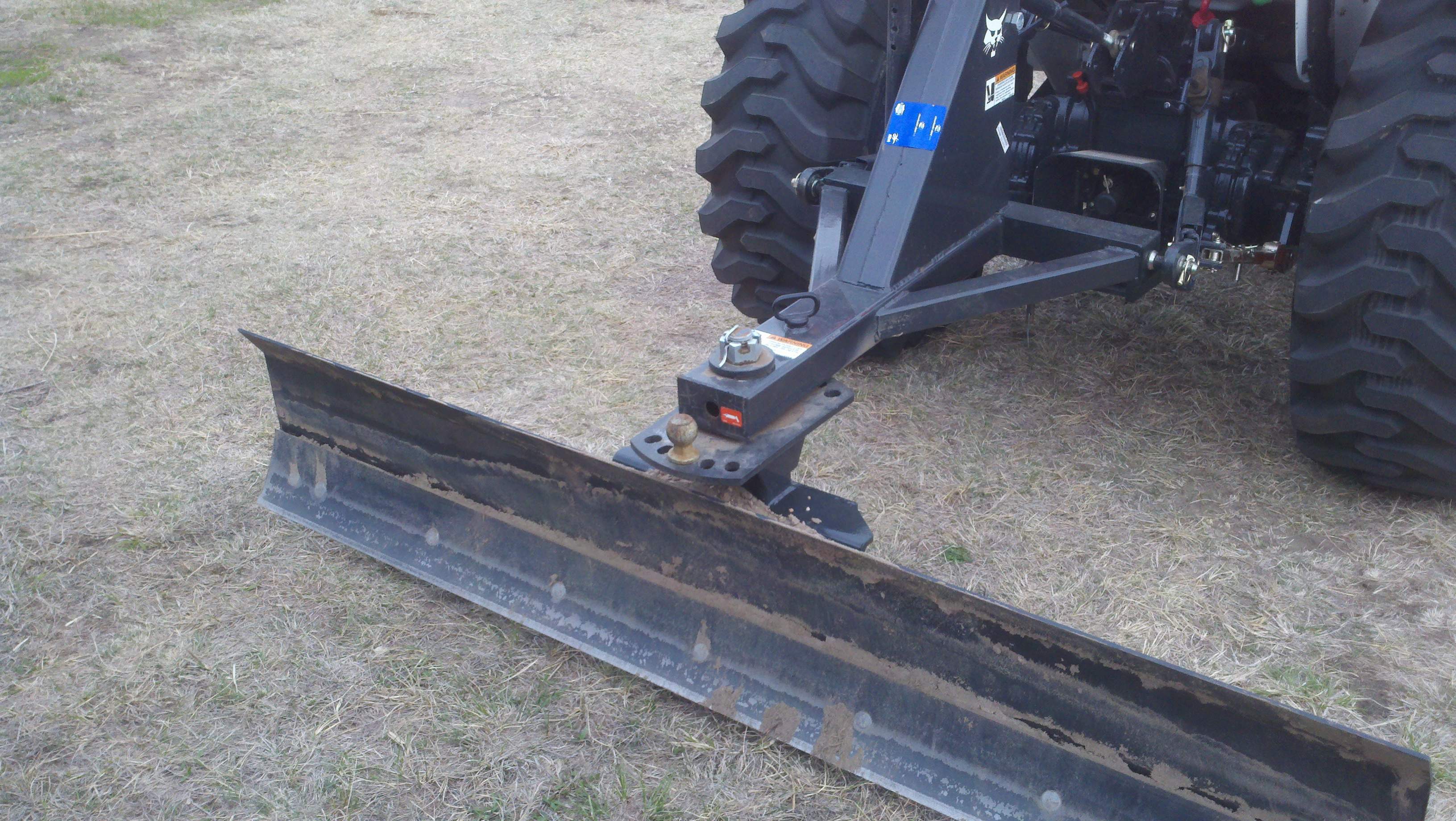

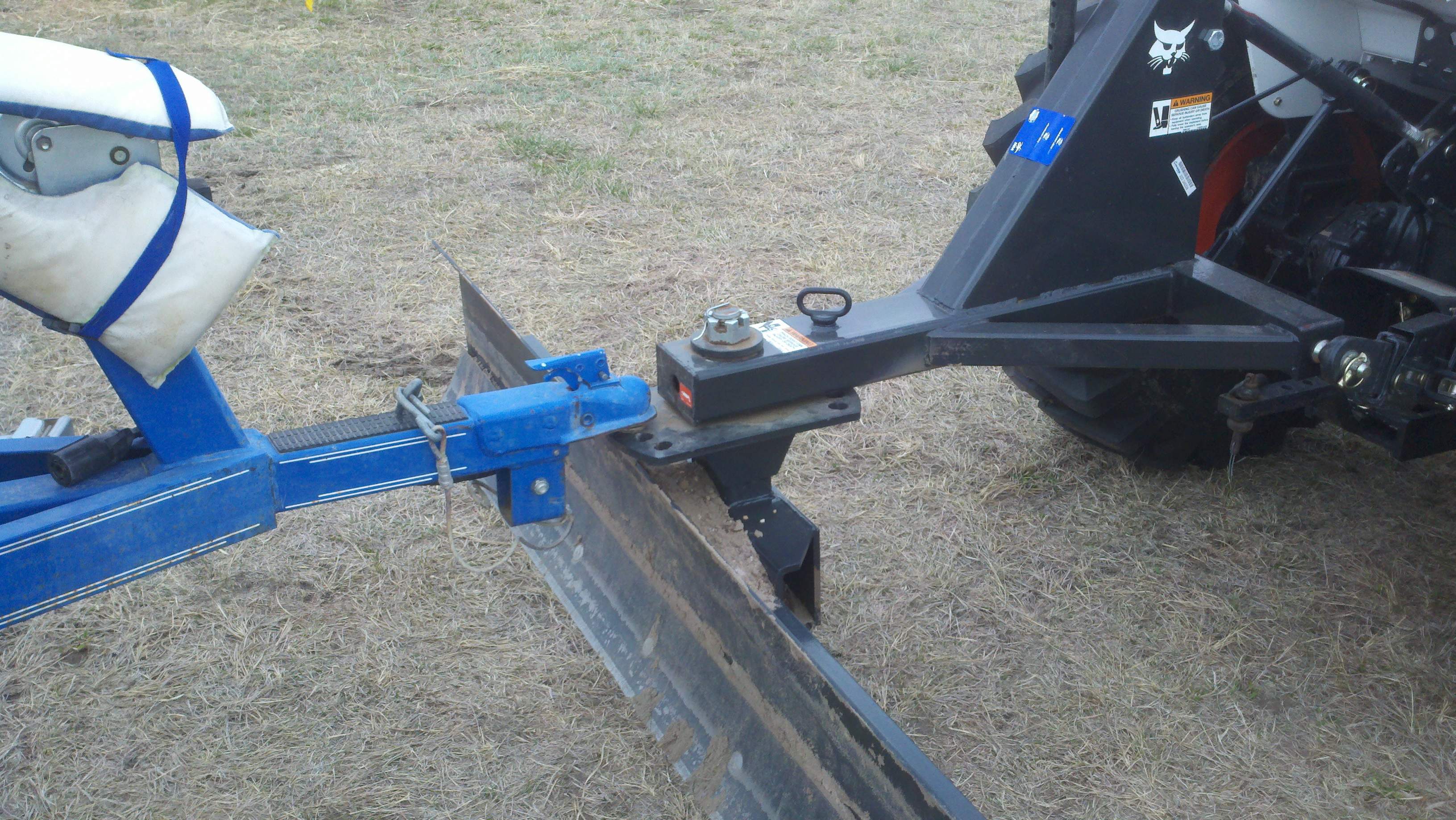

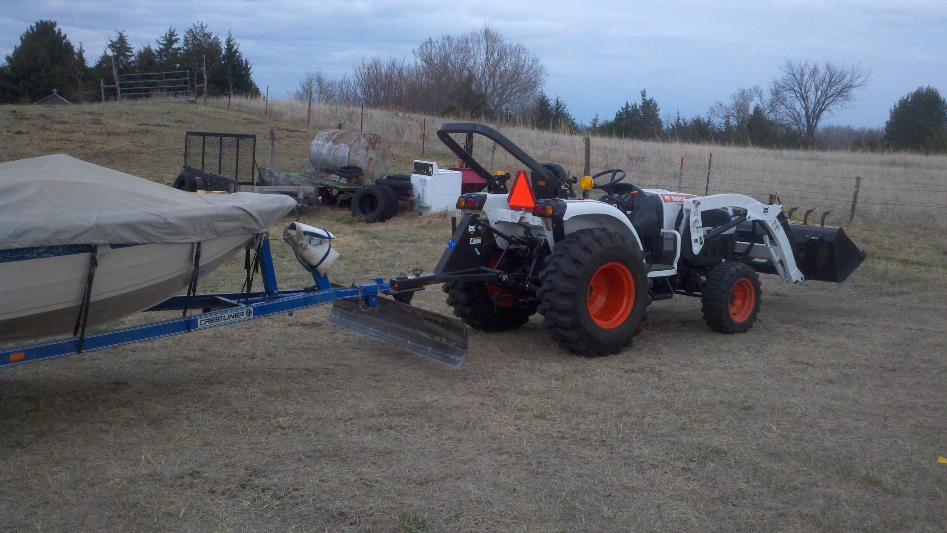

fast and easy trailer mover my rear bobcat blade has holes for differant angles i just hand screwed a trailer ball in center hole just remove if i need to spin blade throw ball in tool box works great.

Dang I forgot the pic's. this was just a fast and easy way of moving trailers. And it work great.

Wow ! that's to easy. Never thought of that, my rear blade has the same setup with the holes on both sides.
I'd probably flip the blade around for a little less weight on the 3pt.
I think my rake is the same as well.
JB.

Finally, an impliment that comes with a trailer hitch! That's reason to buy one right there..
   / Trailer mover
Yeah couldnt belive how easy it was, I just happened to have blade turned backwards but on mine it will work either way I just hand tighten trailer ball so i can remove it easy. I was always going to weld a reciver hitch on my box blade but guess now i dont have to . I also keep ball in tool box so i can put it on pallet fork if i want to agian i just hand tighten.
