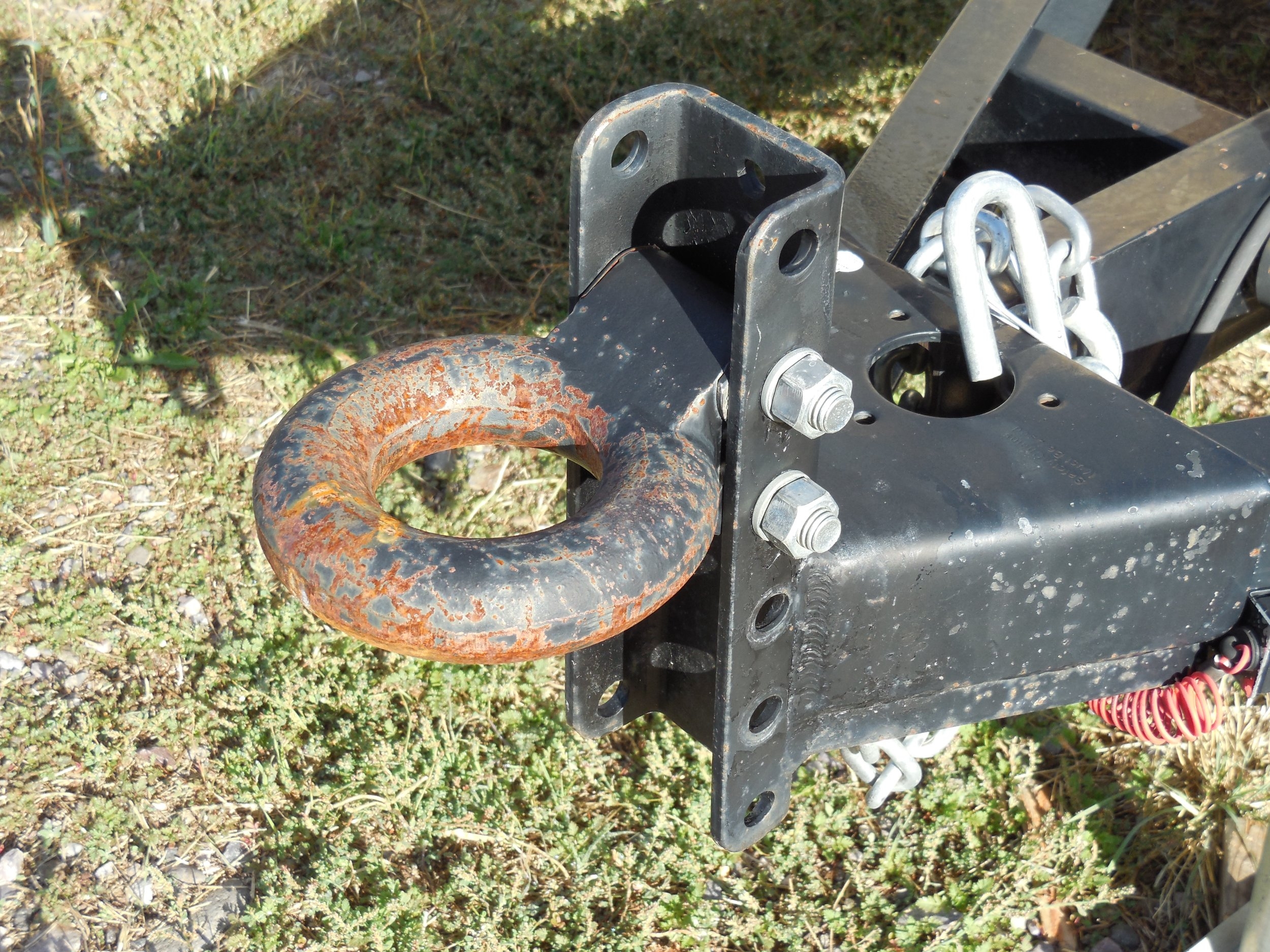

The junky stamped coupler wasn’t holding up on my wood splitter so I cut it off and went with a pintle ring. I purposely got the adjustable height one so I could remove it for extra security. View attachment 821649

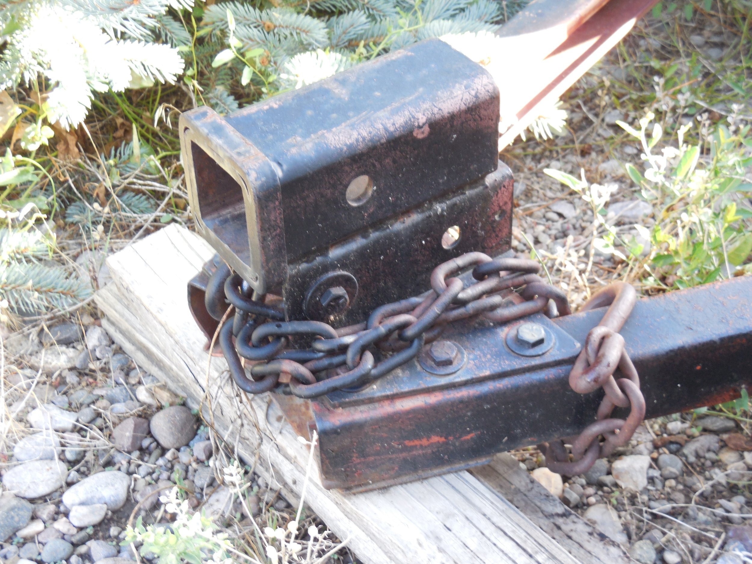

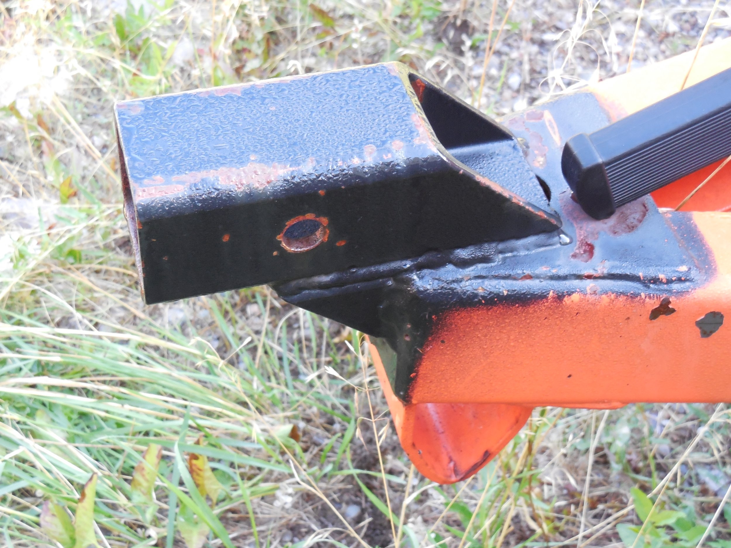

I use the adjustable version on larger trailers. On little ones the miserable ball couplers get replaced with a simple piece of receiver tubing.
Still get about 2-1/2 inches of height adjustment capability by using weld-on tow rings with a small tab (instead of store bought straight ones) with the ring welded to the top of the 2-inch tubing. Or bottom, if turning it over.
Also, using the receiver method allows using extensions of whatever length is desired. I have 24, 48. and 60-inch pieces of tubing for the purpose. Simple 2x2 1/4" tubing with the 5/8" holes drilled at the ends. And a collar to be able to reattach the tow ring, of course.
If, for some odd reason, I'd want to use a regular coupler, I could stick one of those into the receiver tubing. But that hasn't happened in 15 or so years.
If, for some odd reason, I'd want to use a regular coupler, I could stick one of those into the receiver tubing. But that hasn't happened in 15 or so years.View attachment 821792View attachment 821793View attachment 821794
Part of the reason I wanted the adjustable rail is it’s the same as my other trailers. I could borrow a 2-5/16 ball mount from one of my other trailer if I needed to. Usually I just pull the wood splitter with a regular trailer ball through the pintle hitch ring. I can just lift it up with the ball on my equipment that way without having to get off to latch it. I only do that off-road obviously. Part of my problem with the previous ball hitch is firewood was damaging the latch handle and the pintle ring fixed that.
