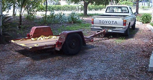

How often do you plan on towing, and how far? If it's once or twice in a lifetime, and it's only 15-20 miles or so, you can get away with alot smaller trailer than you would think. I've towed my BX23 with an 8' Ditch Witch trailer, model S2A. I towed it with the Hilux pickup shown in the photo. It's a single axle, no suspension, tilting deck trailer with a tongue that's about 6' long, and 2900 lb capacity. The 6' tongue allows the backhoe to sit over the tongue so the tractor fits.
Did I make it 20 miles back and forth between my house and the Kubota dealer two times? Yes. Did I drive the truck like it was a racecar or weave in and out of traffic? No. Did I leave lots of room between me and the person in front of me, and look very far ahead to see what was comiing up? Yes. Would I tow the BX23 a long distance with this trailer using the 1/2 ton Hilux? No. Would I tow it a long distance using a larger 3/4 ton truck? Maybe.
My point is, if you are only going a short distance once in a while, you don't need the heavy industry type infastructure. You can get by with lighter duty equipment.
