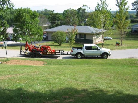

Just bought this trailer. 6.5 foot x 16 foot, with a 2 foot dove tail. Dual brakes, electric, brake away ( I pull on the freeway) and as you can see I have a bit of room to spare, but I can also adjust for where the tractor sits for tongue weight. Oh that is a Sport Trac, 4 wd, 6 cylinder 3.0 I think, Reese frame hitch. Pulled fine today
