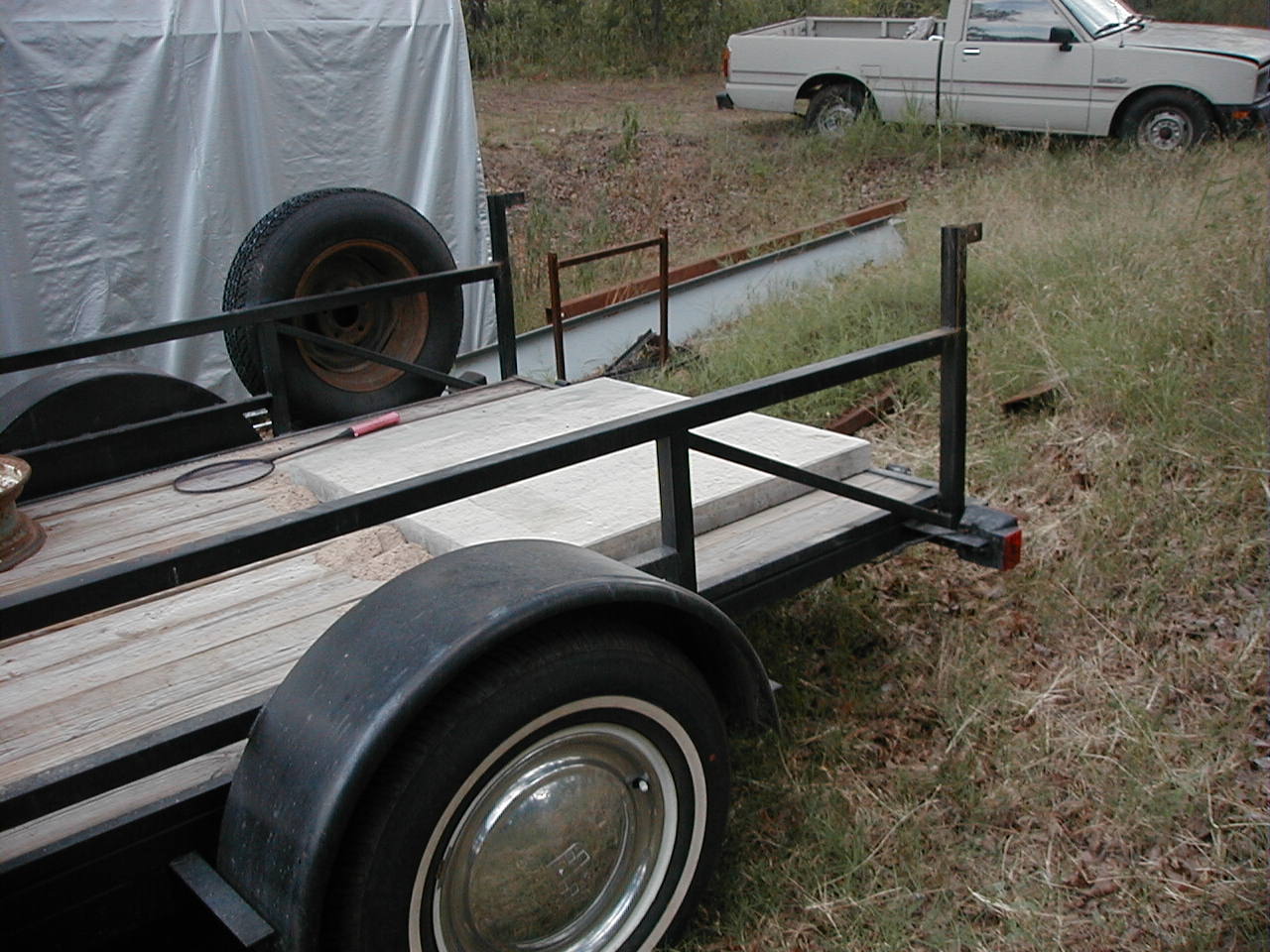

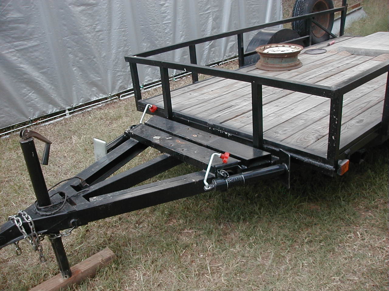

I have a 6.5' X 12' All steel with dual 5000lb axles for sale right now.
Asking $1300 Neg.
Located in New Bern, NC
