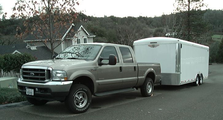

I have a 20' 9,990 pound GVW enclosed car trailer. It is 10 pounds under 10,000 lbs for a good reason. 10,000 GWV rating (not what you've actually got on it) is the lower limit to require a commerical drivers license. There have been a few threads here on TBN about this CDL topic.
Make sure to get both trailer axles with brakes.
Tow with my F250 Diesel. Standard hitch, no issues with tongue weight.
Attached pix is of both rigs. Not sure you can read the license plate. It should be familiar though.

Very nice looking trailer. Sure beats the one I tow around.
Egon /forums/images/graemlins/grin.gif
   / Trailer capacity/size?? #9
I see that you have a H&H trailer. I have two, 18' enclosed and a 22' GN lowboy for my tractor. I am thinking about trading up the flat bed for a deck over. I really like there trailers.
   / Trailer capacity/size?? #10
</font><font color="blue" class="small">( I see that you have a H&H trailer. I have two, 18' enclosed and a 22' GN lowboy for my tractor. I am thinking about trading up the flat bed for a deck over. I really like there trailers. )</font>
I really liked the H&H over the other choices I had when I bought it. It has a lot of nice "standard" touches, the gravel guard in front, the LED clearance and tail lights, the torsion bar suspension. And really important, the rear opening is bigger so taller cars will fit. I was looking at Woodys and they won't fit the smaller openings of the 7,000 GVW trailers. I didn't get a Woody--should have they have really gone up in price. But, it fits my taller Model A just fine.
