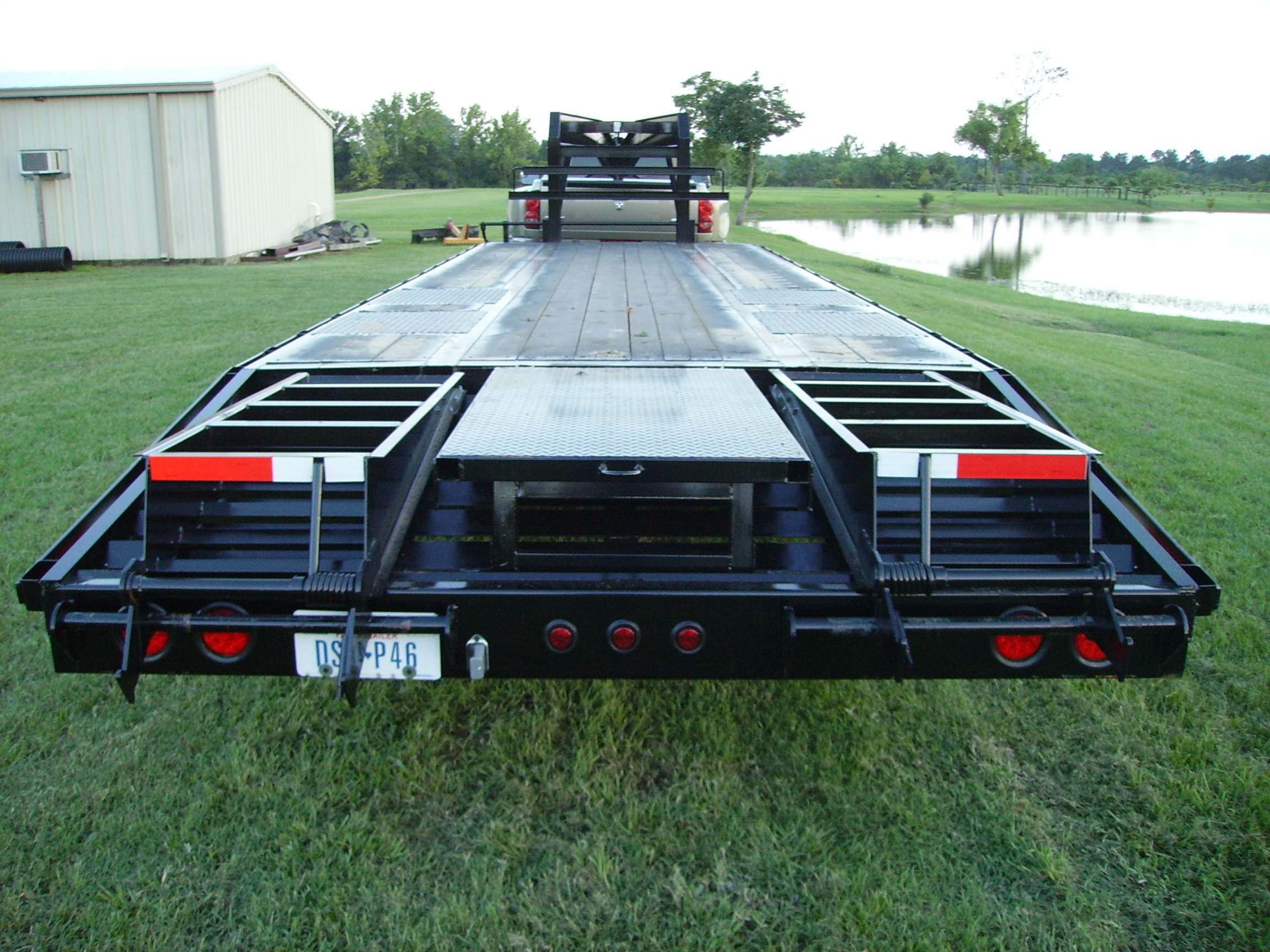

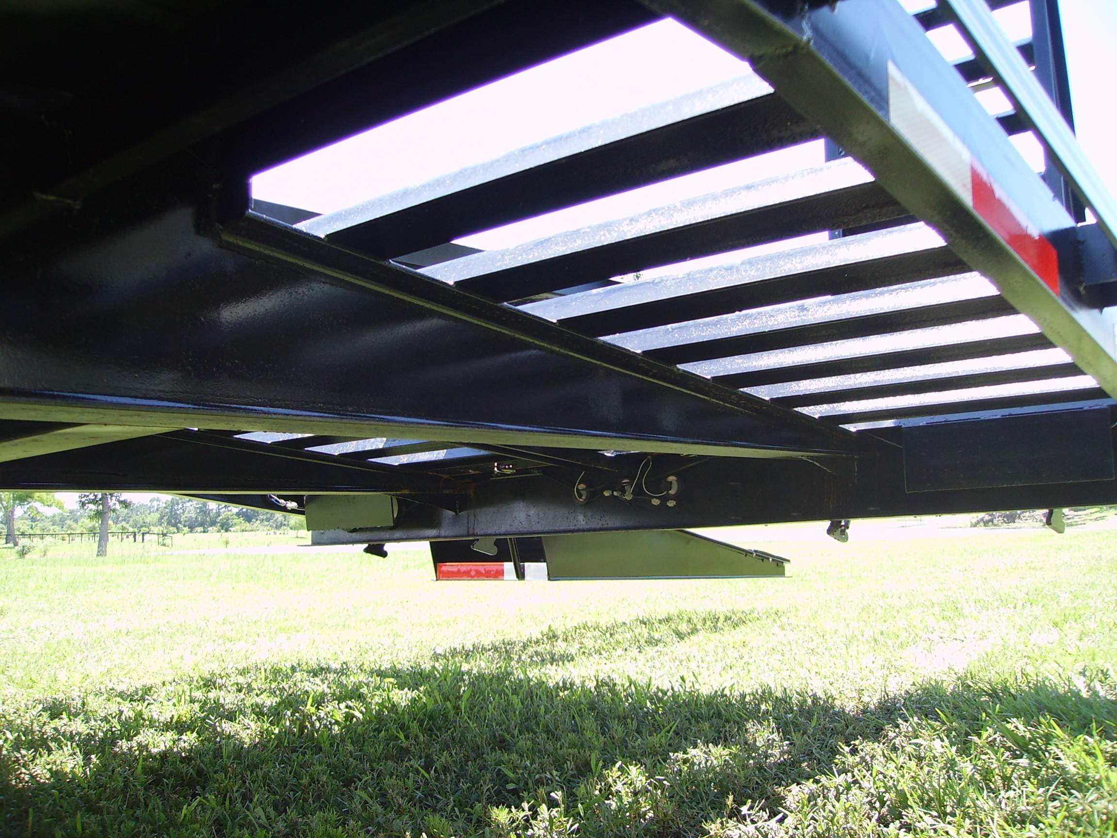

Had my trailer for 5 months now and i bent the bumper pulling out of a ditch, it has 8" channel for a rear bumper, I am cutting it off and installing 4"x8" rect. tubing. Here some before pics, didnt take any pics of the bent bumper, didnt have a camera at the time.

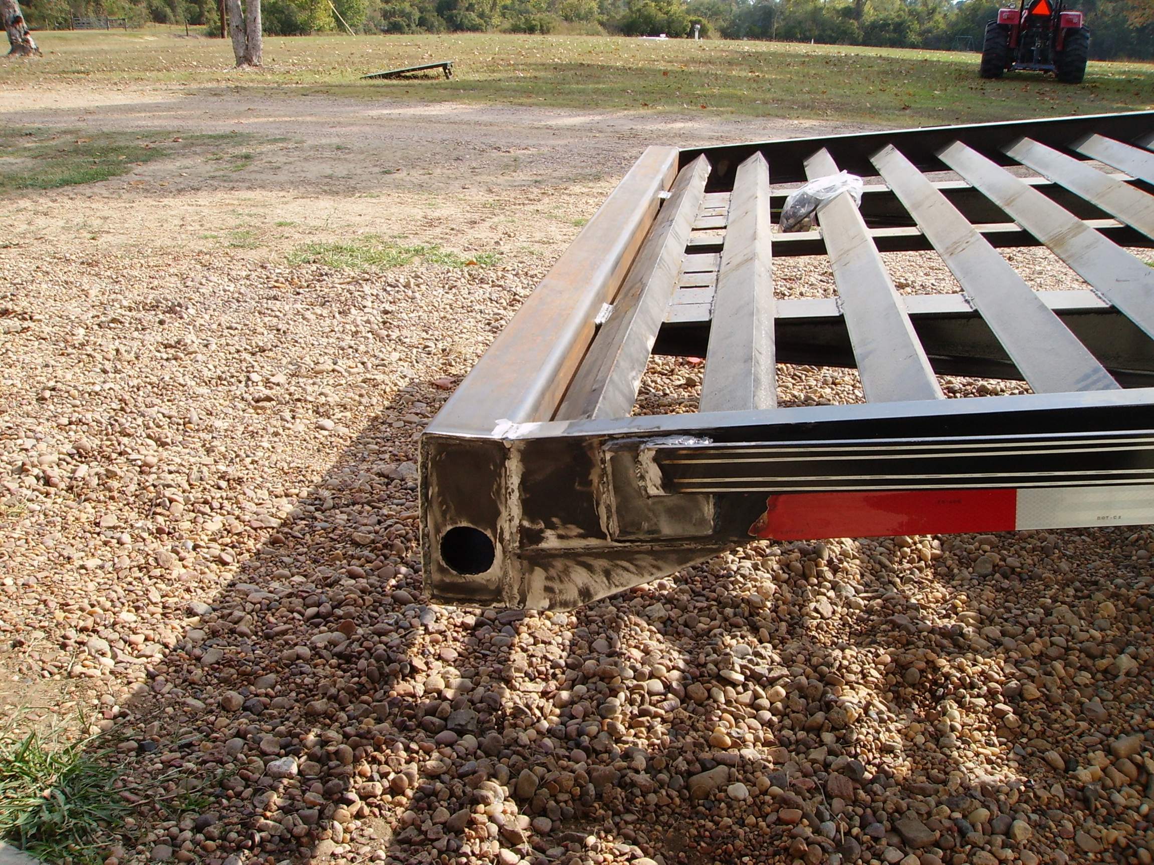

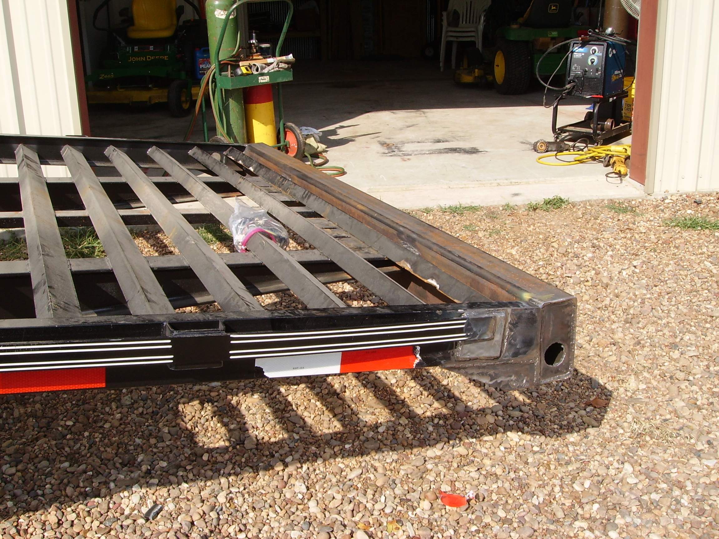

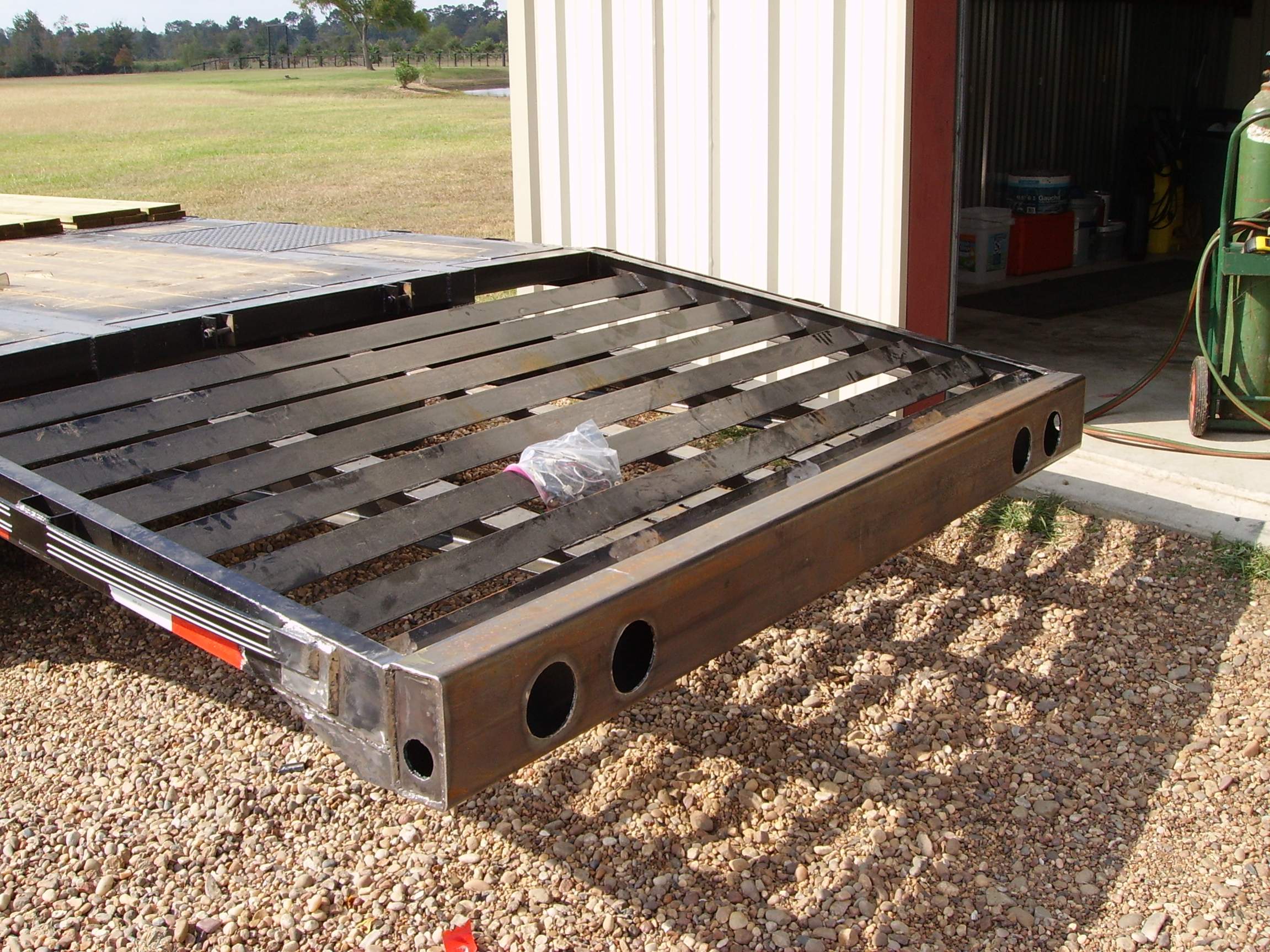

I got this far on it as of know. Plan on working on it some during the week and on the week end.

i assume you cut the bracket/round stock holder for the ramps off the other one and youll be useing the same mount on the back of the new one?
did you free hand the round cutouts?
/ Trailer Bumper
Making new brakets also, they welded the bracket to the round bar, i am going to make it slide through and pin it in so it can be removed when or if i need to. Yes i free hand the round cuts, I am not a pro at cutting, the rubber mounts will cover any era's.

Its a Longhorn trailer 30', its a low profile type, it sets somewhat lower than a regular dove tail gooseneck, the flat bed is 31" from ground to top of the boards, not sure how far the dove tail is from the ground, a normal trailer sets around 34" to 36". I looked at the Kaufman trailers, just went with the Longhorn. The Kaufman trailers looked well built and had good paint jobs under the trailer and on the outside, when i ordered mind it was only primed from the inside of the main frame underneth, then primed and painted on outside, and painted it with the boards on it, so i know all the metal dont have paint on it, they primed it without the boards not sure why the painted it with the boards on?? The heavist load i had so far was my Mahindra 5500 4wd, and my cousins 5055 JD, it was a tight fit, or it might of been my 5500 with 10 round bails, it felt about the same.

Looks good.
You going to do an 'eyebrow' or something around the tail lights ?

Yes, I will put an eyebrow over the light bar, and i am installing two license plate lights, and i will put 2" angle iron over them also.

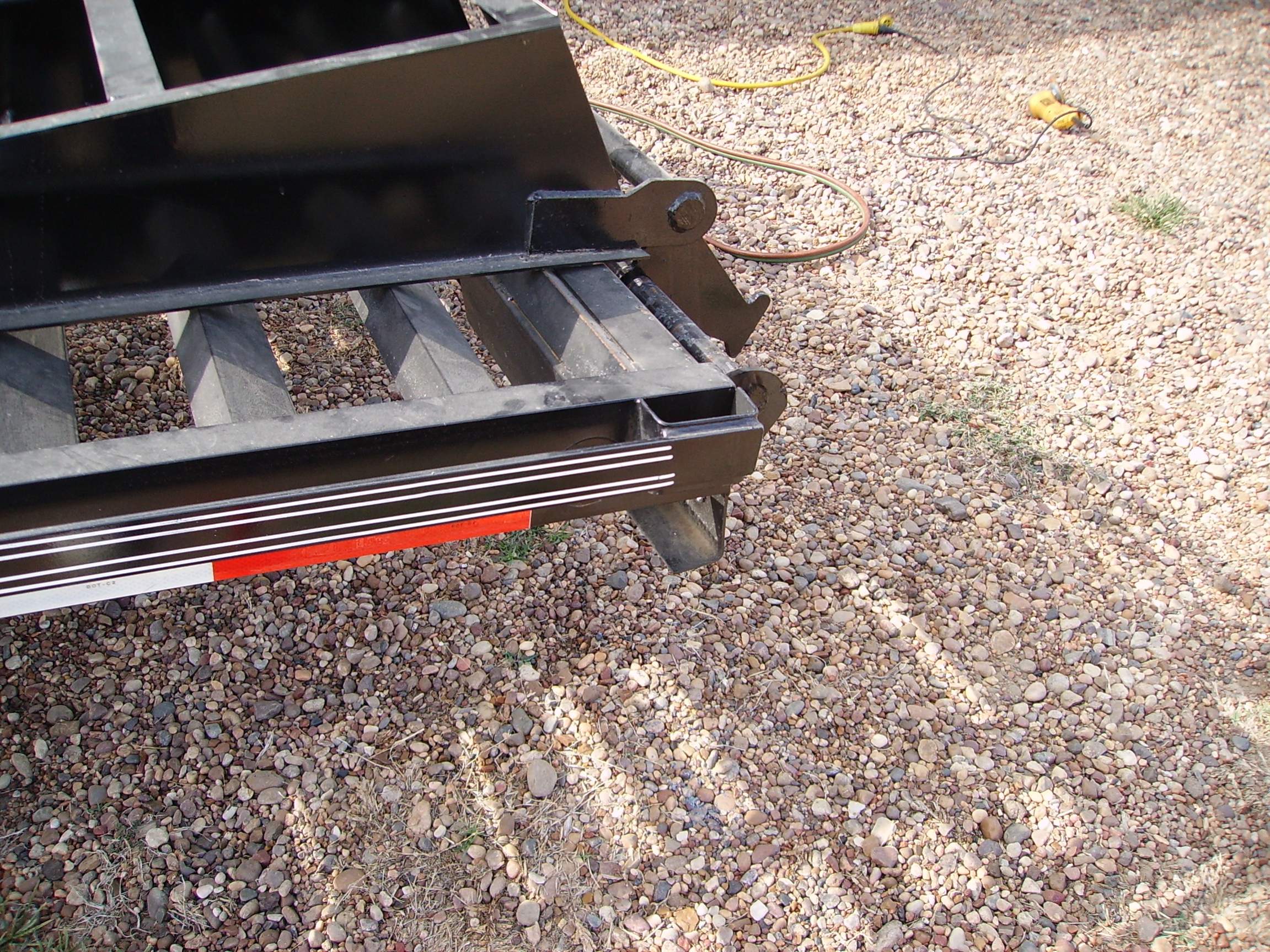

Worked on the trailer today, welded pat eyes for ramps and more bracing under main frame and bumper, drilled and tap 1/4" 20 bolt threads for license plate and license plate lights and light bar. This week end i will be buffing and grinding to prime and paint.

Nice work. Is there going to be a issue installing the lights? Also, did you opt not to do the trailer hitch receiver at this time?

Re-using the orginal led lights, they are rubber mounts. I made a wiring harness for inside the bumper, using a regular 4-plug male and female, if any problems i can pull the harness out to work on it, all the lights just plug in. Not going with the reciever hitch, i dont think its legal to double pull in Tx, least i havnt seen it. But it was a good suggestion.
