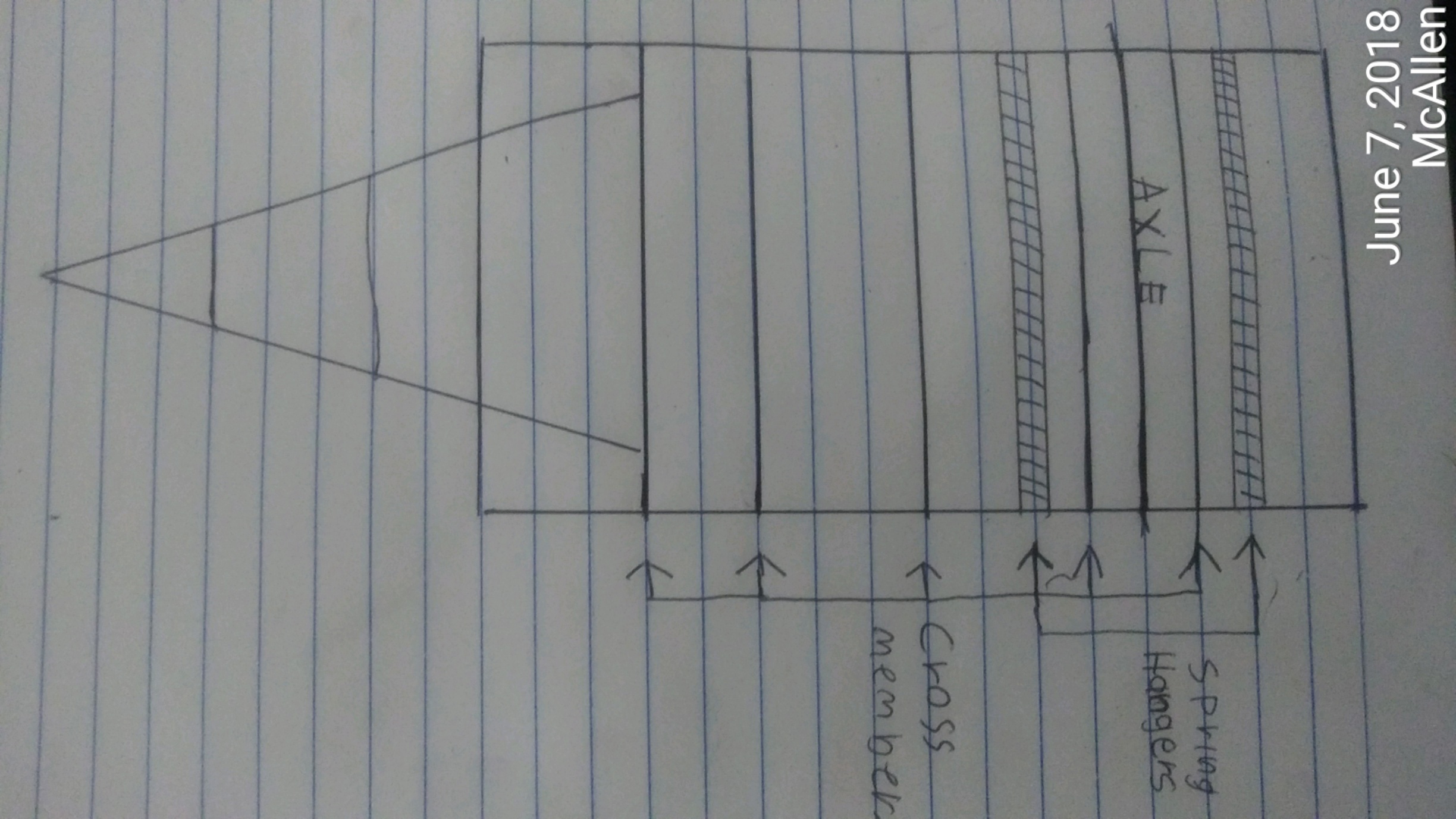

I need some advice for the build of a small 4.5 x 8. 3,500# trailer to haul the sprayer that I will be building.
The plan is to build it out of 4" 5.4# C channel, since i don't plan to build a top rail for the trailer.
First problem I encountered. The C channel, has a flange of only 1.584" and the spring hangers are 2.25"

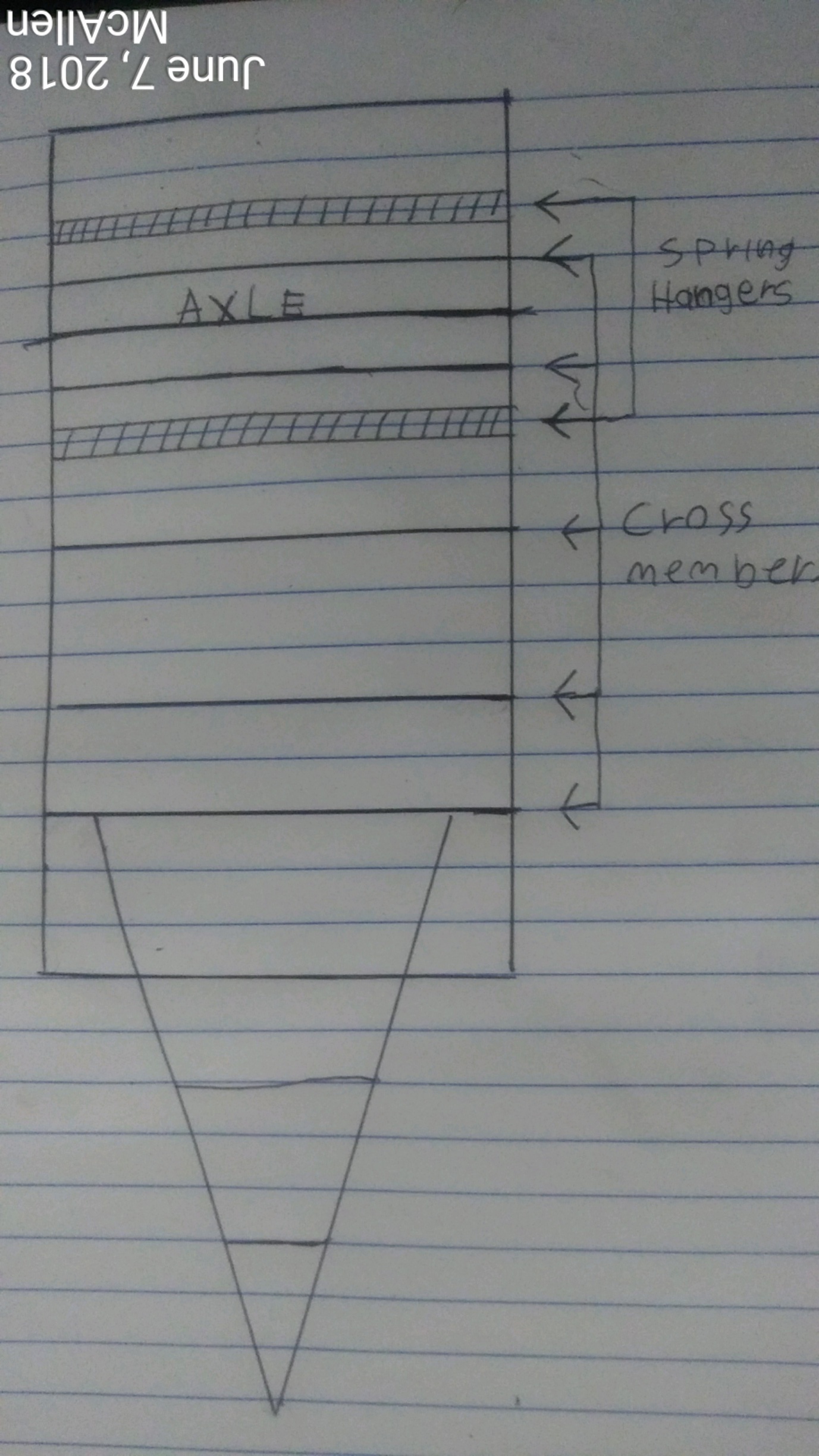

My Idea was to weld a C channel with the flanges facing up across the frame than weld the hangers on the web of that channel.
Here is an ugly drawing of mine

Unless that's metal laying around I would face the bottom flange of the channel with some 2" x or 2.5" x 1/4".. You're only talking 3 to 4 feet per side. Using that 4" channel is just going to be added weight you don't really need.

When I built a small trailer for snow machines I used 2x4 1/8" tube and made the hangers. If you want to stay with c-channel then I would use the store bought hanger brackets. They make the same thing for the rear but with a bushing in it for the shackles. I think I would wait on building the trailer until after you build the sprayer unless you are sure you know where the weight will be located. Axle placement is pretty critical to get the correct tongue weight.
   / Trailer build #4
The simplest method would be to box in the channel where the spring hangers will be located. A 4" long piece of 3/8" flat would be adequate by each hanger.
Hanger manufacturers recommend only welding at the open ends of the hangers not on the radius bends.

I like the boxing in idea.
I have seen some trailers where a piece of 2" angle ties into the frame and hanger, and spans clear across to the other hanger.
I have also seen some where the spring hangers have been welded to a piece of angle the long way, plus maybe a foot, and then that is bolted or welded to the rest of the trailer frame. Doing that would also allow you to move the axle later for balance?

Just make a bracket that looks like the Lexus car symbol and weld it to the side of the lip with the top welded the the inside bottom of the top lip.

I think the angle iron along the frame holding the two hangers one side and another one for the other side would be the easiest to make.
I am thinking 4" x 3" unequal leg. What thikness should i buy 5/16 3/8 or 1/2
The springs are 25 1/4 long
Is 36" per side decent enough?
