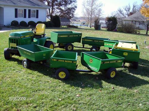

That's not all of them! I have two more Older model JD carts, plus the 10P that I use the most. I collect them to go with my JD garden tractors.
My parade lineup this year:
317 "Special", L/60 "Custom", 15 cart, 10 cart w/30 cart, 80 cart w/JD pedal fire truck, 8HD cart w/20 pedal tractor, 7 cart w/4020 pedal tractor,5 cart w/ pedal tractor cart & 50 cart w/ #8 JD cart replica.
