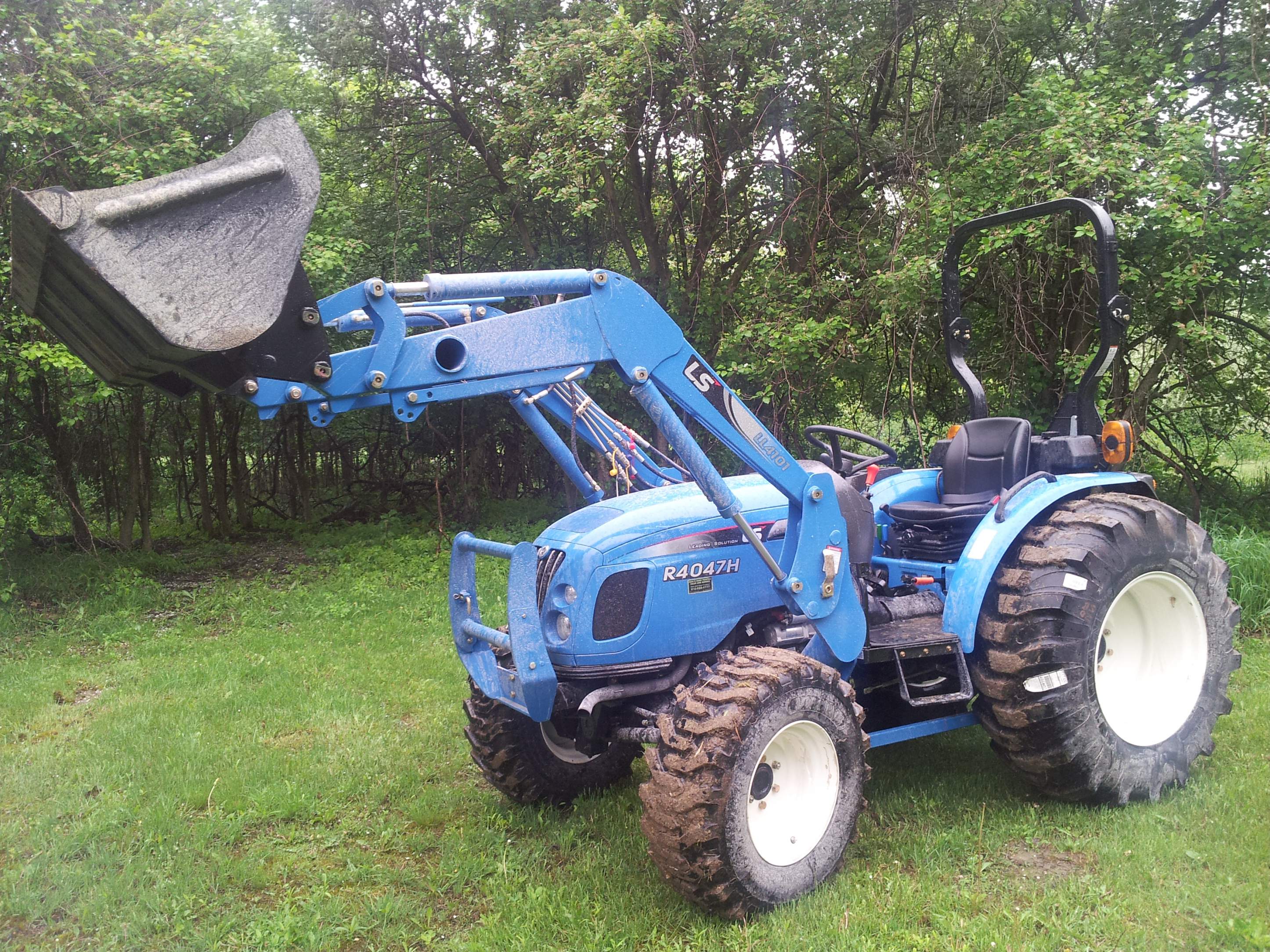

Here she is... the tractor I should have bought back in February in the first place! :confused2: As soon as I got it off the trailer, I removed the seat stop brackets, and I'm already working on a few other mods as well :cool:
So, after making all the calls, I called the dealer that I bought the 4041 from (big thanks again to Paul's Tractor of Clio, Mich). I told him how much I hated the Shuttle. I told him that I wanted to get into a HST. Told him I had around 50 hours on it now, and that I understood I'd take a hit if I traded it in. He simply said, "what did you pay again in Feb?" I told him $19,200. He said, "I'll buy it back minus $1000." So, he gave me $18,200, which is near what I owed on it anyhow, and pretty dang fair considering I've had and USED it these last few months. He got me into the R4047H for $21,760. I know he is not making any money on the deal, and just wanted to make a customer happy, and it speaks volumes about his character.
Anyhow... I decided to stay with LS for 1 because of that dealer, and 2, because as you can see from the little spreadsheet comparison I did, no one else can compete with the price. The LS is still the undisputed "bang-for-buck" champion in my book.
And ironically, the little issues I had complained about with my R4041, dealing with the loader acting strange, going limp at full dump, etc... those are not present in this new 4047. Even the Quick-Attach levers operate much more smoothly than the 4041. It could have something to do with the 4041 had sat in the lot during the winter perhaps, as this one was ordered for me and arrived on the truck earlier this week. Speaking of that, his lot had easily 2-3 times the new LS tractors as he had before. He says he's selling a ton of them, and having a hard time keeping them in stock. Good for him, and good for LS!
Oh, here's a shot of the beautiful HST pedals LOL... can't believe how much I missed having a Hydro, and how glad I am to have it back :D
