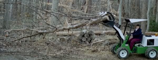

I agree on the 4 in 1. To do it all over again, I would buy the 4 in 1 in an instant and go invest into a good rock rake which will be much more versatile than the PT grapple bucket. If you already own a bucket, why buy another on with a grapple on it?? Even if I had 4 in 1 and the cash in my pocket for the PT grapple, I would not buy it, but rather buy a rock rake type of grapple. With that, you can do all of the carrying that we see in 14's pictures, but also sift rocks from dirt, pry roots loose and a bunch of other things.
