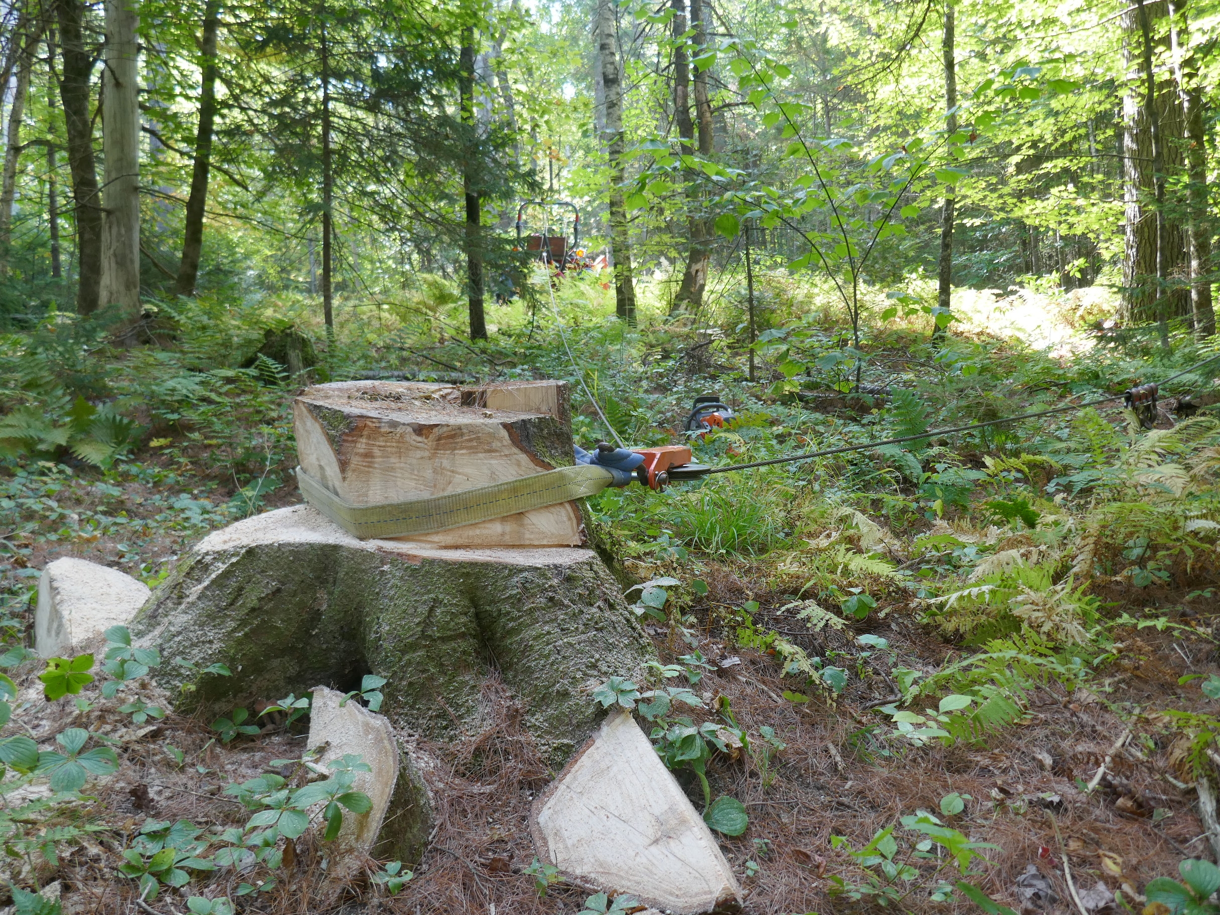

I had a dead fir on the side of the road and adjacent to the power line. These are notorious for becoming blowdowns and in this case a potential power outage. So I wanted it on the ground before winter. It was pretty straight but being dead and on the power line made me decide to use my winch for insurance. There was a good lane to drop it into with a stump from last winter in the middle of it. I used the stump as a snatch block anchor after cutting the root flairs. I did not want the strap to slide up on the taper when tension was applied. I put very little tension on the cable to start. Just enough to make sure the cable stayed seated in the snatch block sheave and would not jam on anything when I started to pull. Looking towards the tractor which is on the road side.

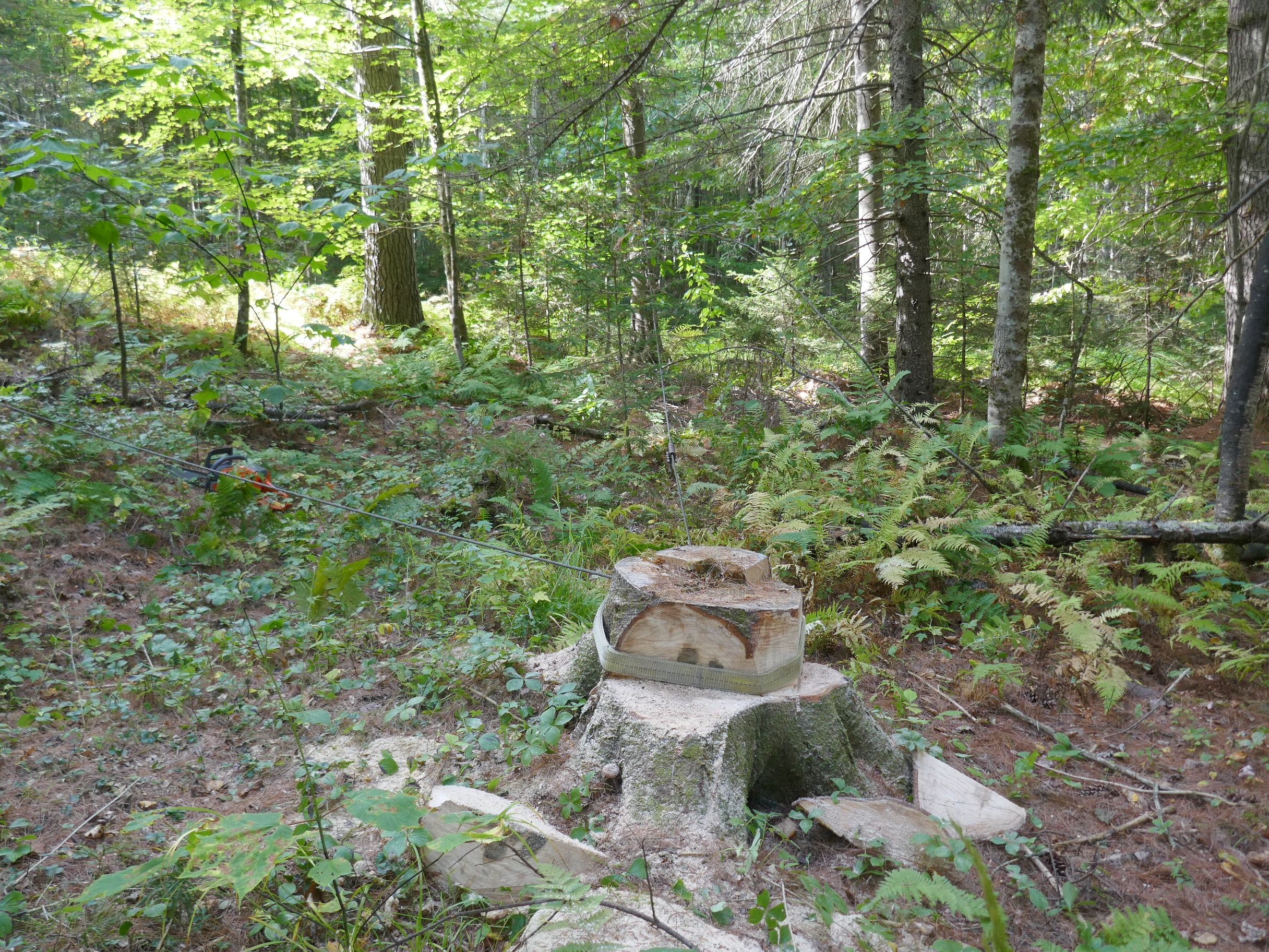

Looking towards the tree - in the center directly behind the stump.

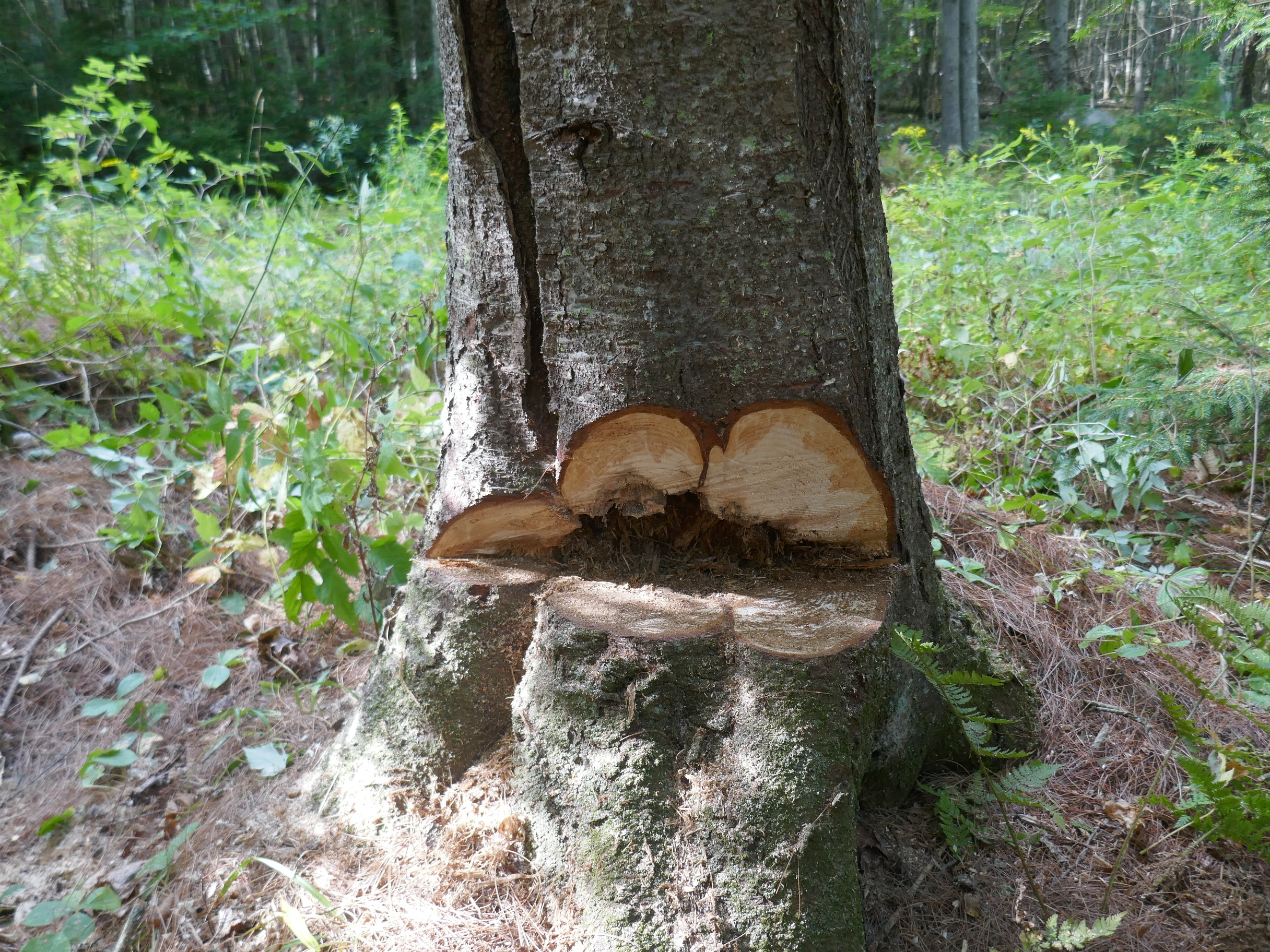

I made the notch cut. You can see why these become blowdowns. Not much structural integrity in the base at all.

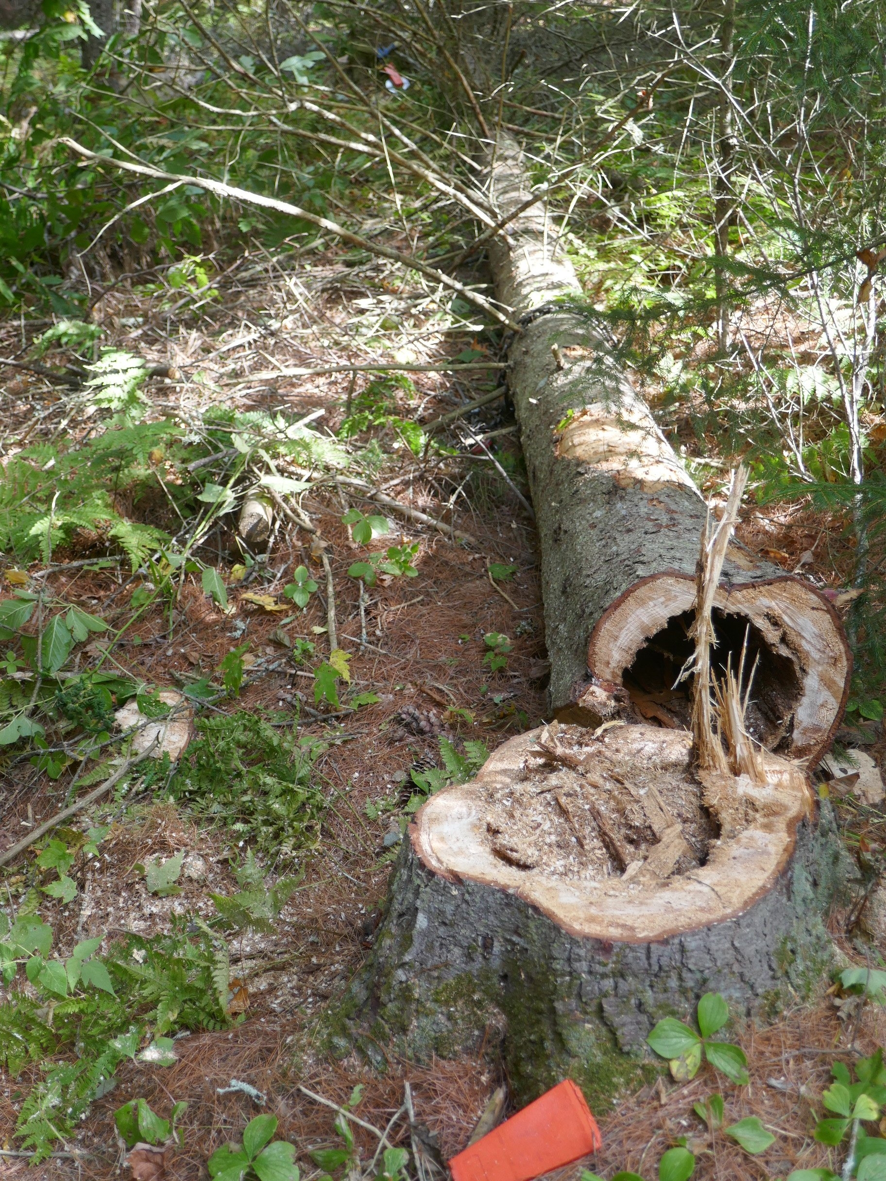

Made the back cut and a slight tug with the winch to get it through the surrounding canopy and down.

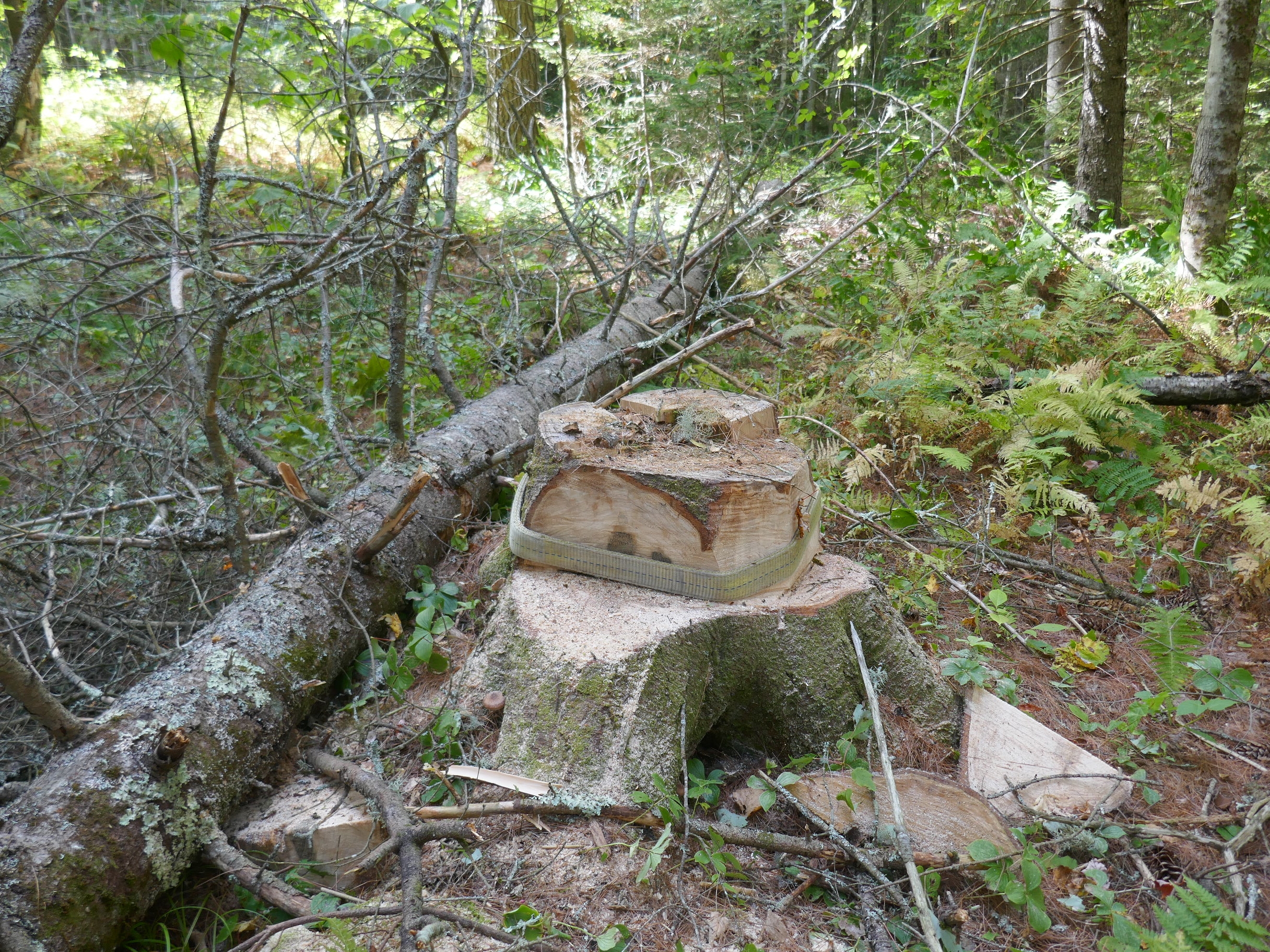

On the ground. Looking towards the stump.

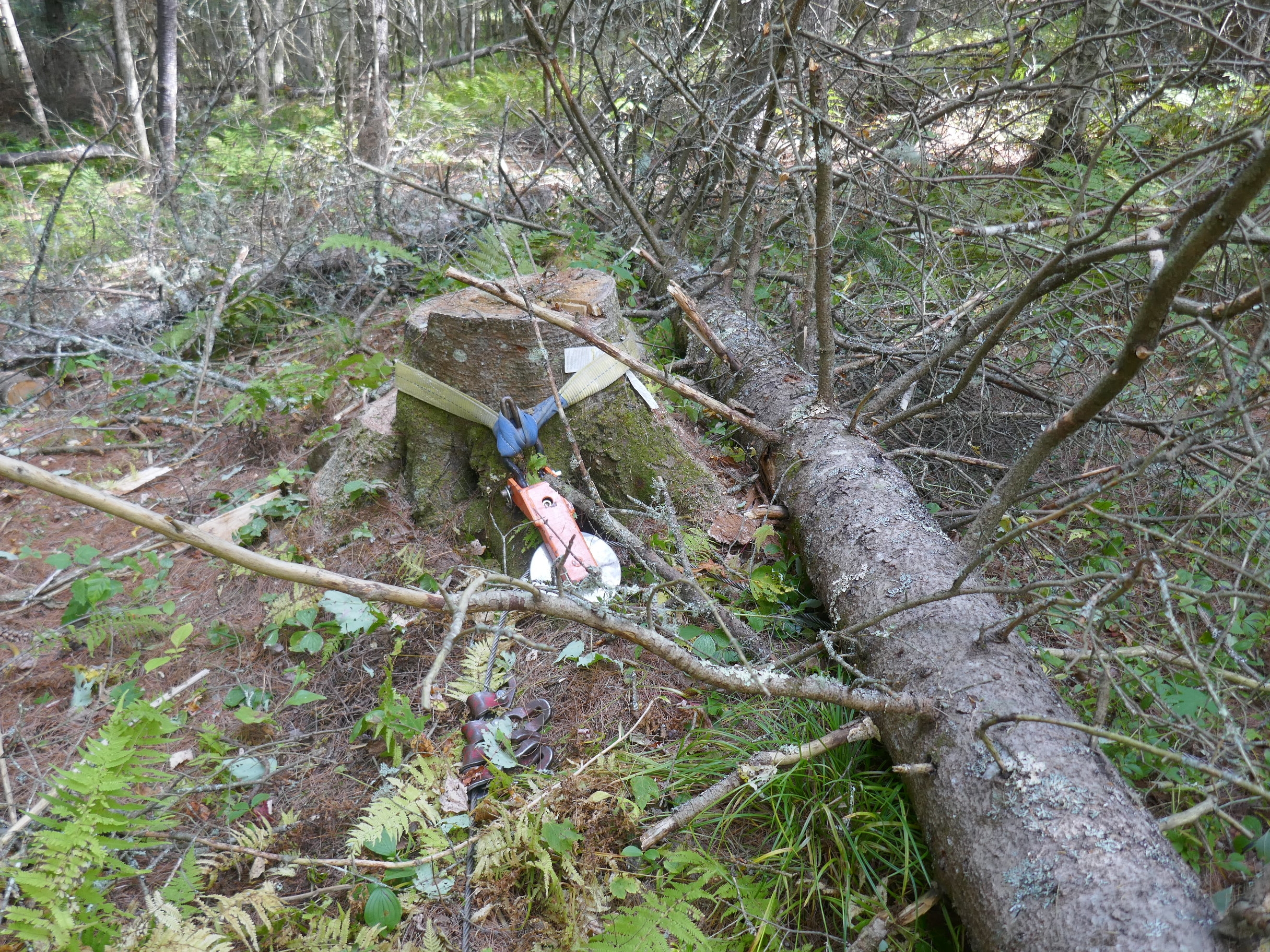

Towards the top which broke and folded up.
