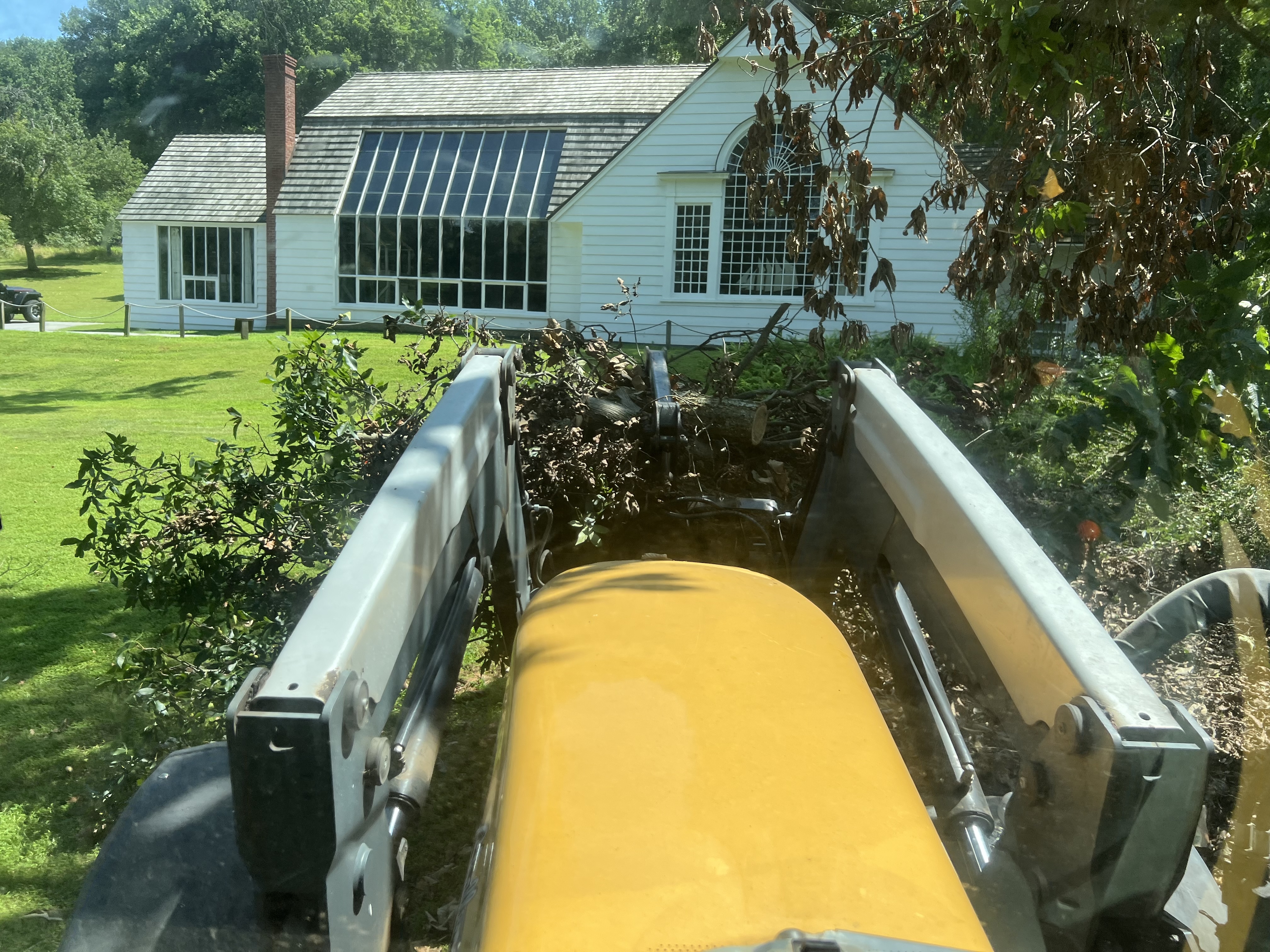

Cleaning up 2 fallen trees for a Customer from a storm last week.. Started today. Hauling tops & leafy branches to wood pile.
We’ll be into the logs tomorrow.
It’s nice to have work other than hay or mowing when there’s rain in the forecast.

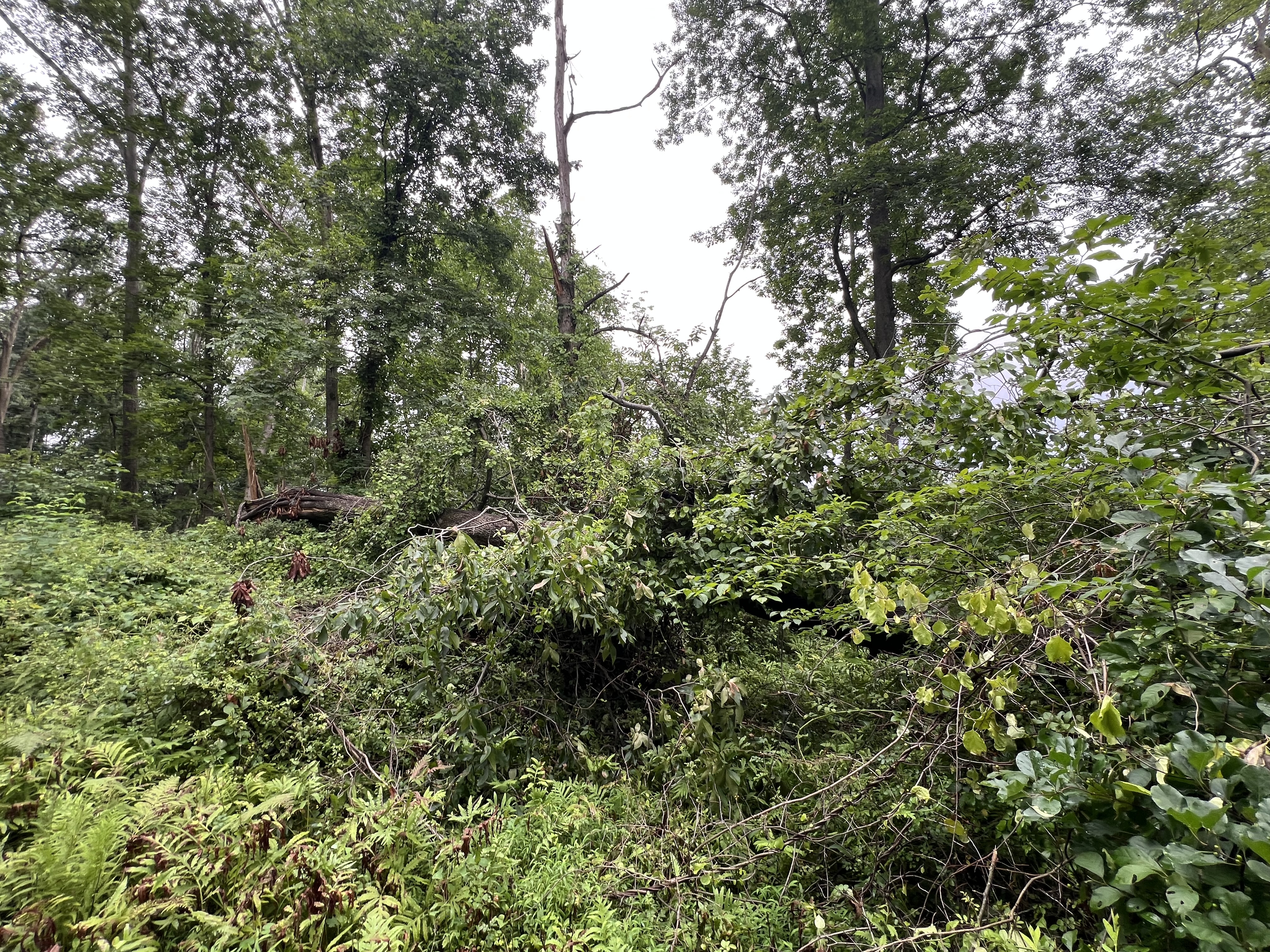

Added Day-2
What a mess Trees on top of trees, lodged into other trees surrounded by vines & stickers. Easy-peezy, right? lol
Ass end is 36” diameter. Snapped off about 5 feet up.
