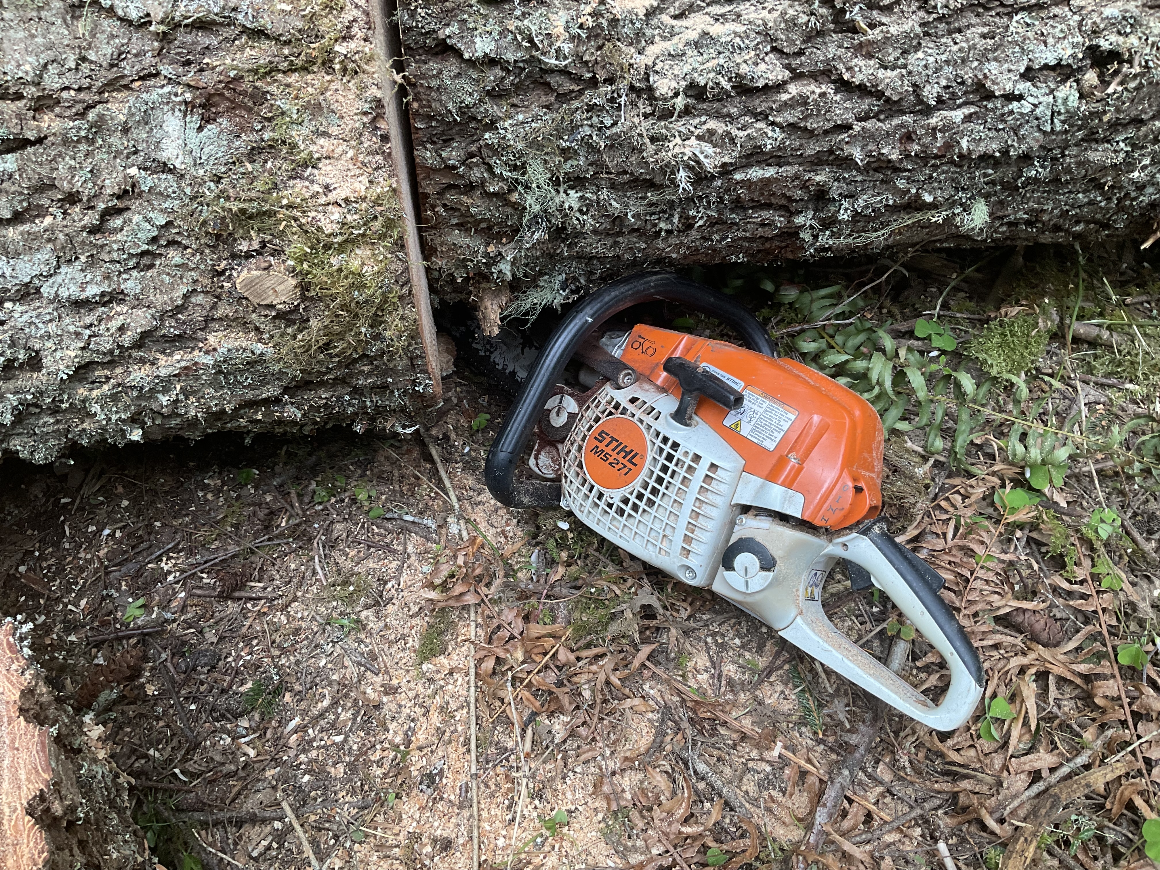

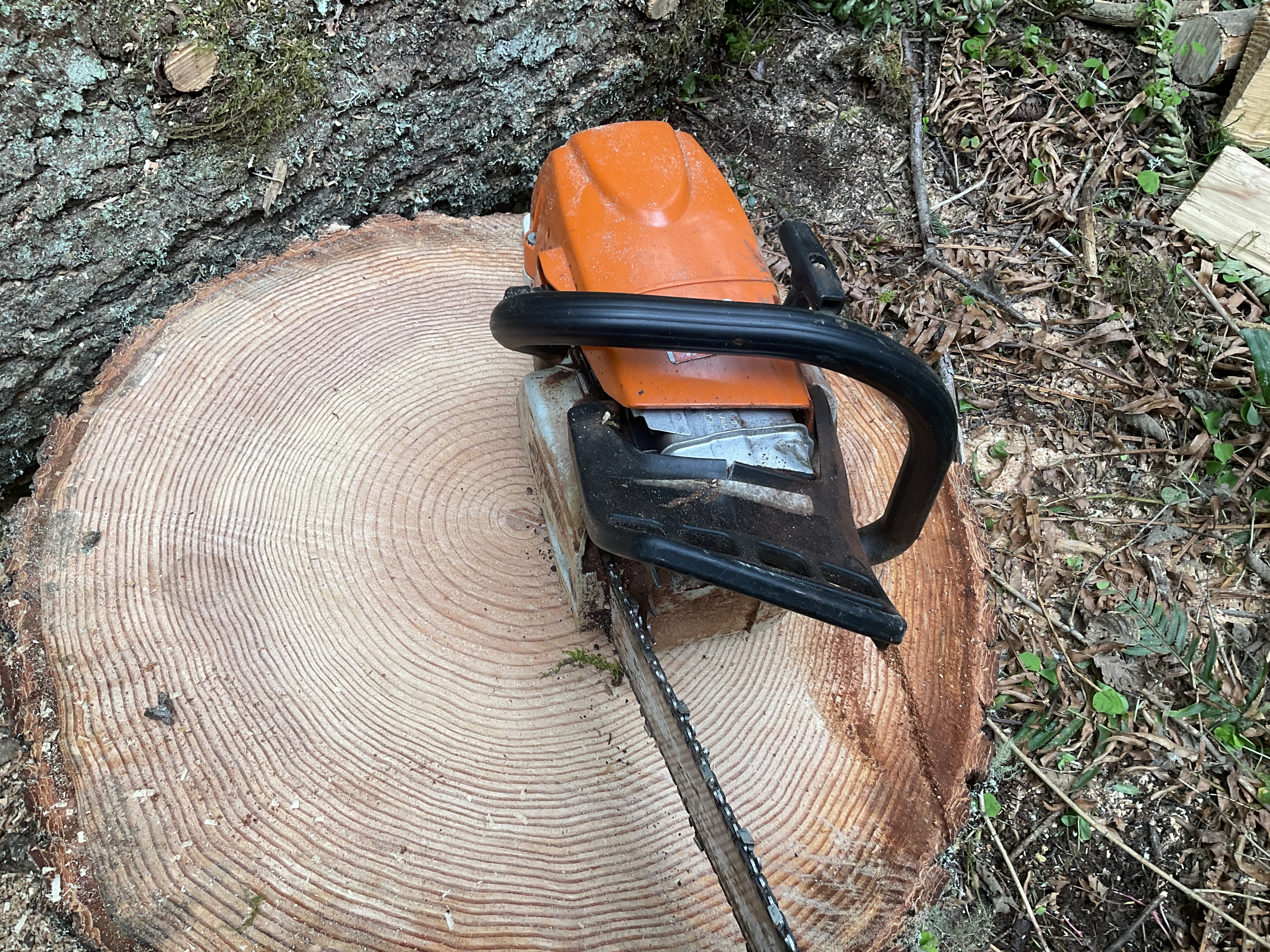

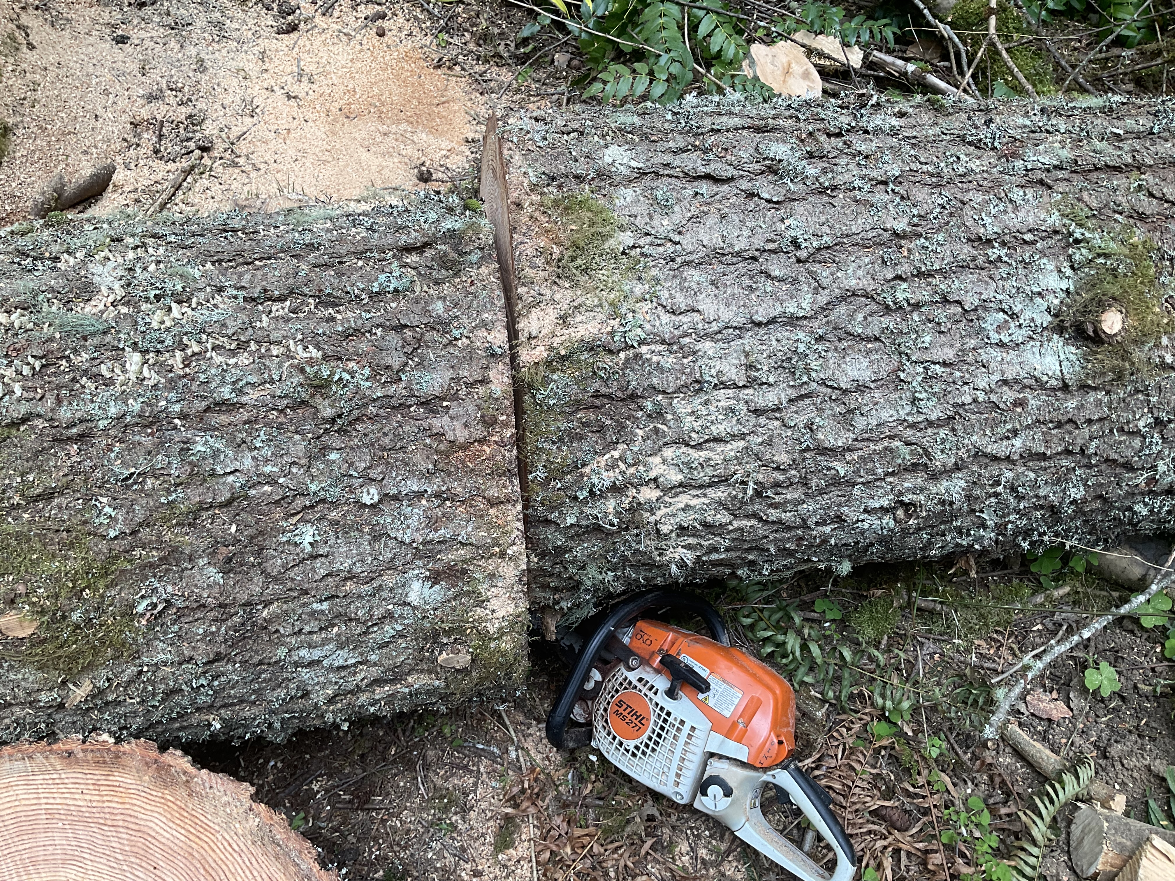

I would show you mine but my saw would not cooperate,
Fortunately it just bent the bar and cracked the kick back handle! New bar $60. And some JB weld and back it yesterday!!!👍🏻

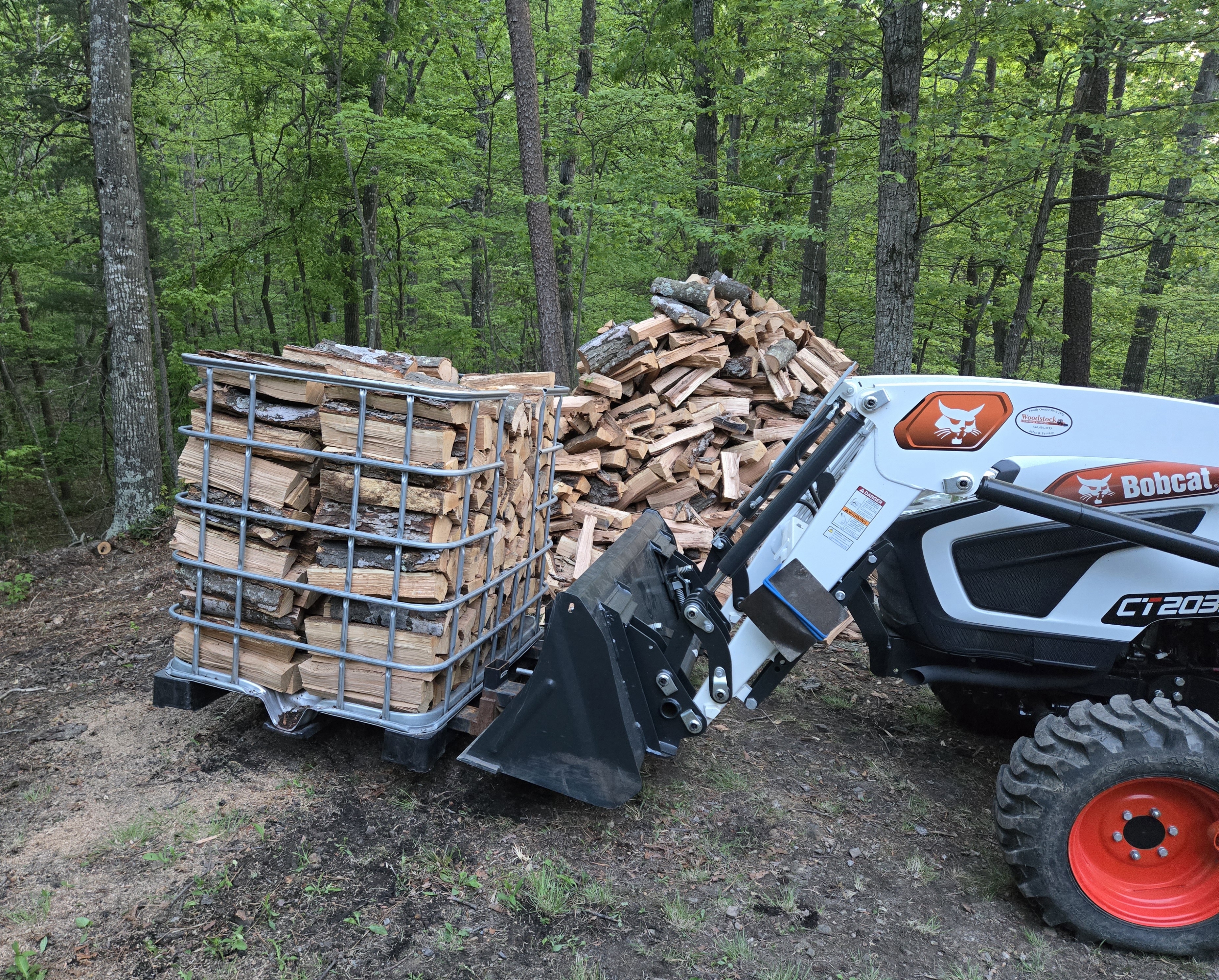

Up up and away! This was about all the loader wanted with the Vevor bucket forks I borrowed from a neighbor. I'm gonna keep my eye open for a good used QA fork attachment. I figure it's an honest 1/3 cord, perhaps slightly more. Mix of Red, White, and Chestnut Oak. View attachment 3414192
I'd be concerned for the bucket using bucket forks with a load like that?!
That being said, if you plan to stack them, I would not remove the opening like I do.
I've been wondering about stacking with them cut - so far, I've left the top ring uncut, which results in regular head-bonks... but I've been wondering if - when full of wood, it's not like there's much outward pressure on the cage; it's not like it's a water tank... the vast majority of force goes directly down onto the floor of the tote, unless you're stacked. And, if it's stacked with the upper tote actually being on the lower cage, is it really going to be bad to have a gap? Would tossing a couple 2x4's or even 4x4's to act as a header be better?
I'd kinda like to get rid of the top of my tote "doorways" but I do stack a few totes in my barn during the winter.
Also: when I cut the tote cages for the "doorways" I cut at about a 45° angle and briefly clean up the edges with the abrasive to reduce chance of encountering sharpness...
I was a little concerned as well. The bucket held up fine for the short distance I moved them. I don't plan on moving them again with that set-up though. I didn't trust it and kept the bucket low and my hand on the lever to drop the load in a hurry if needed. I just got a text about a legit QA pallet fork attachment and will likely pick it up in the next few days. It will also bring the load in close to the tractor which will reduce the strain on the loader and make the tractor less tippy. It felt like ALL I wanted to ask of both the tractor and the loader with it stretched out in front of the bucket.
With the IBC cage filled with wood I think you could probably double stack it ok though I'd stick with keeping the opening fairly narrow and maybe add a short length of light chain across the top of the opening to keep the ends from spreading it they were inclined to. Like you, I suspect most of the force will be down, not out. Nothing says the top layer has to be full either. Maybe try it with a half full one and see how it looks/feels.
