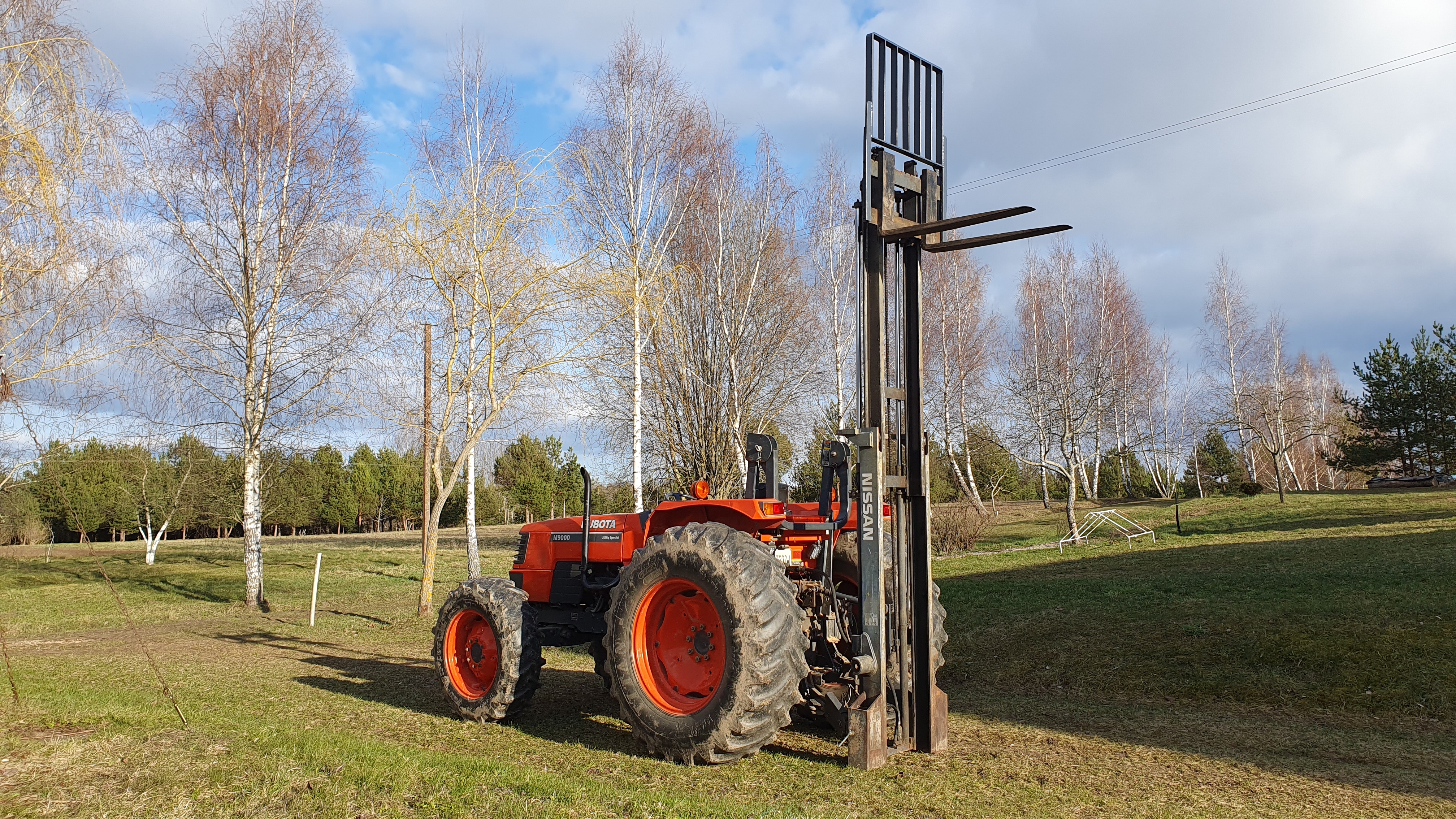

I have two attachments - (1) 3pt pallet forks with a grapple (shown in a video some posts ago) and (2) 3pt forklift. Both are with standard professional forks, what means they are made of hard steel. Since my tractor is equipped with just one hydraulic port I wouldn't be able to use a grapple mounted on a forklift despite it fits.
And yes, rear axle is the strongest part of a tractor, and I take advantage of this :)

Not quite like that.
Yes, the aux port I use for a grapple cylinder on the pallet forks.
But in case of a forklift I use that port for two long lifting cylinders of it.
I don't have a possibility to tilt the forks up or down in either attachment with a hydraulic top link. Instead of it I made two top point brackets welded differently. On the pallet forks when you lift a pallet or whatever one top link bracket allows it to tilt forks up and to prevent cargo from falling while driving. With the other bracket you can lift a cargo just straight up without tilting according to parallelogram rule. That allows to load/unload a low trailer. In order to pick up the load from the ground the forks are lying horizontally in both cases.
Not sure if I could explain clearly :)

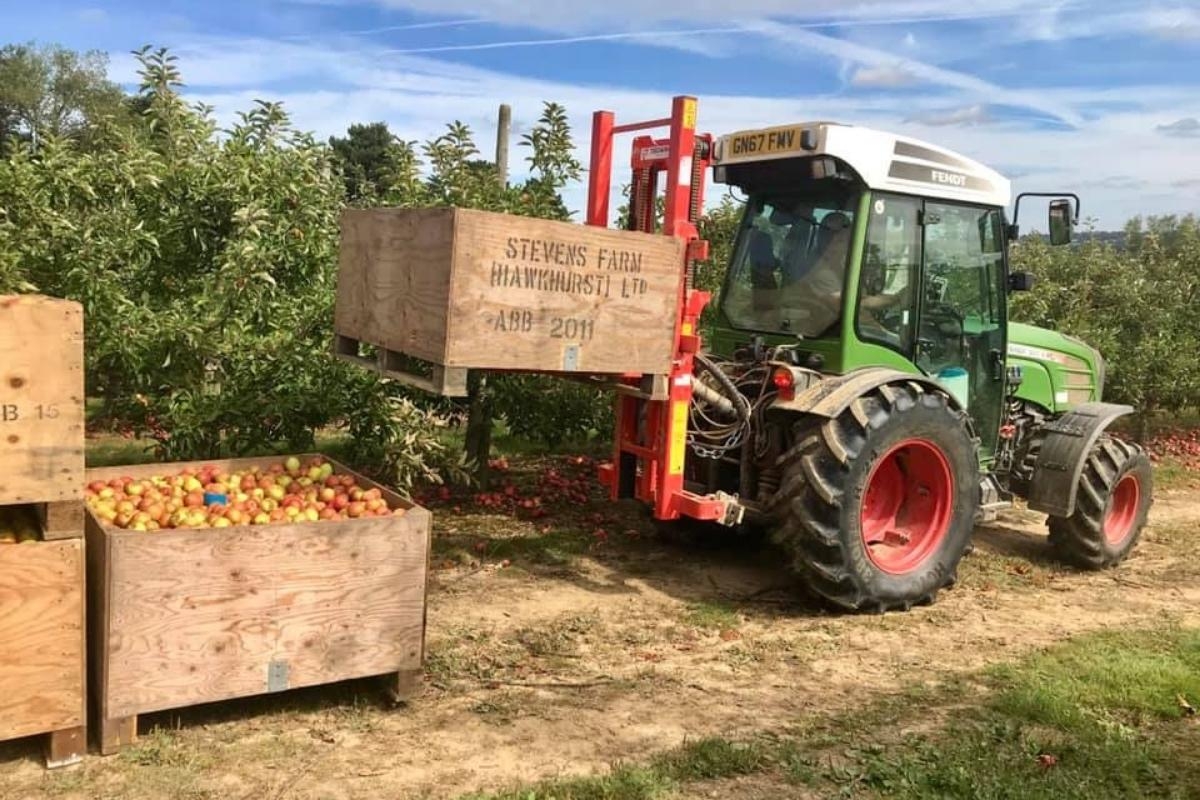

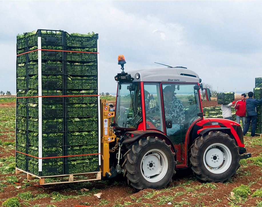

This is one of many purposes for a 3 pt forklift attachment.
Loading totes full of vegetables or fruit directly to a semi truck parked near the field.

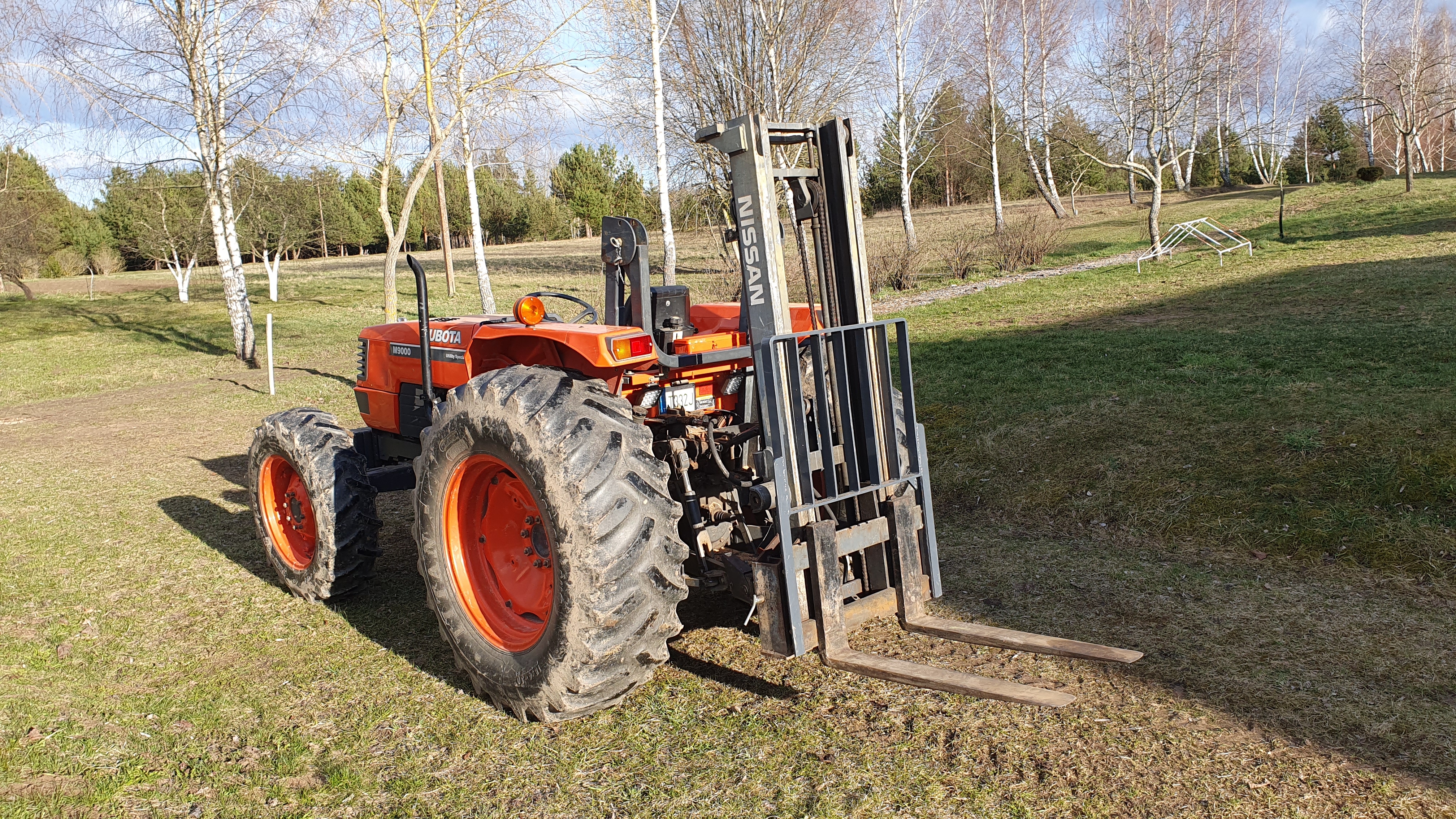

I just took the pics of my tractor for you. I'm sure you knew such adaptations :)
You may see two long vertical cylinders just beside the stem.
It's taken from old commercial forklift, that's why I call it a forklift.
You may see two long vertical cylinders just besides the stem. It's taken from old professional forklift, that's why I call it forklift.
That's pretty cool. I'd actually never seen a rig like that on a tractor, but it makes sense someone would've thought to build that. Very nice!
   / Tractors and wood! Show your pics #24,959
It's heavy, weighs 1 tonne. Attached to the lift arm balls in the middle of the stem. The protruding parts are only two forks. It is able to lift and bring 0.5 T off the ground. With the wheels mounted at the bottom of a stem it would carry 1.5 T.
Very important for me is that it occupies not much place in a garage.
I didn't come up with this. There are many others who do the same.
