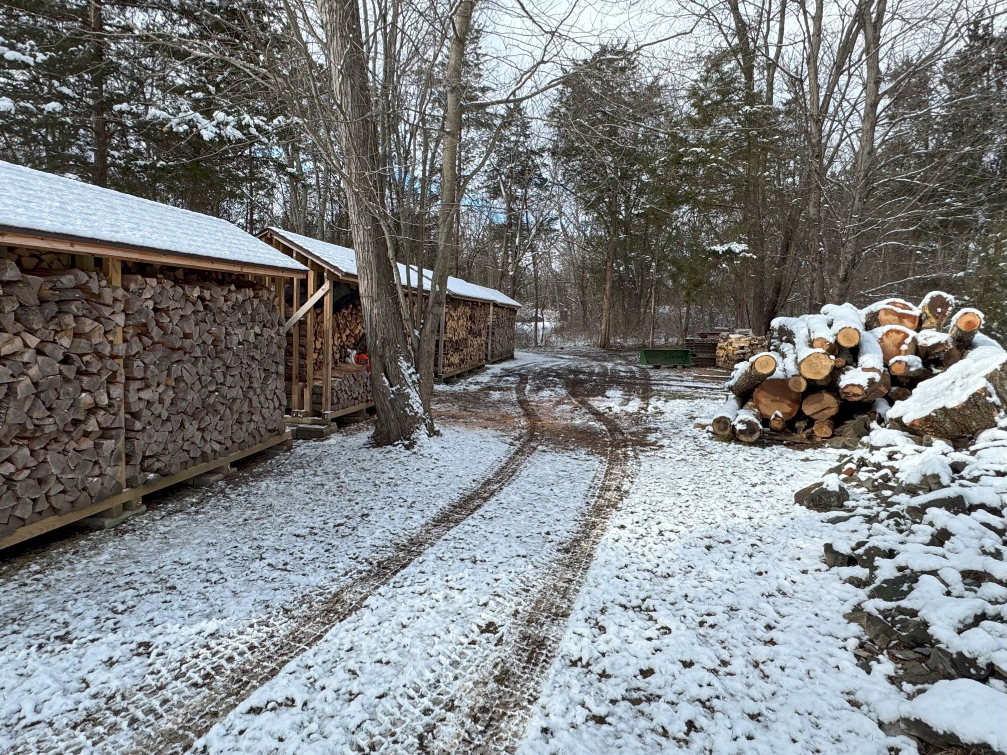

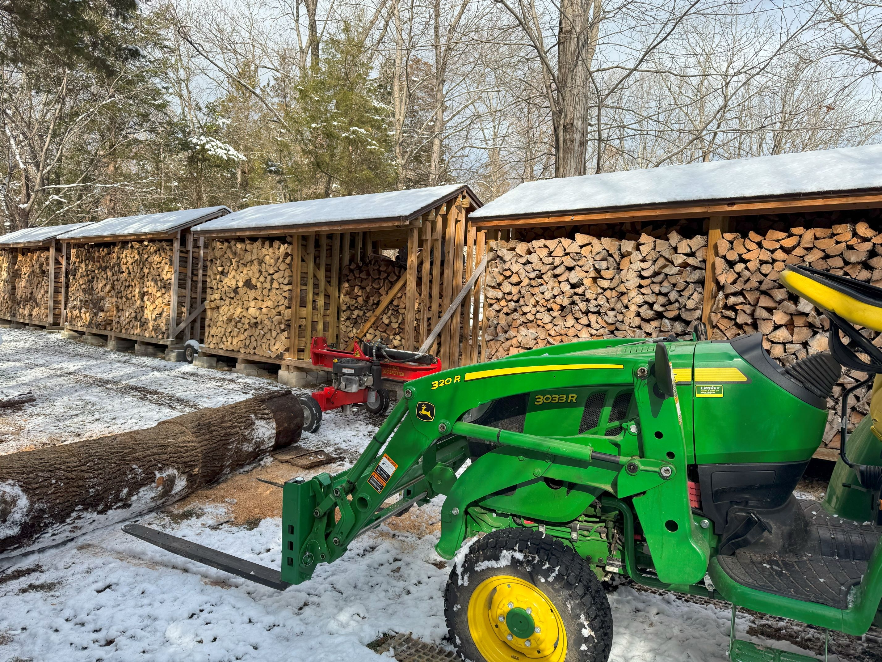

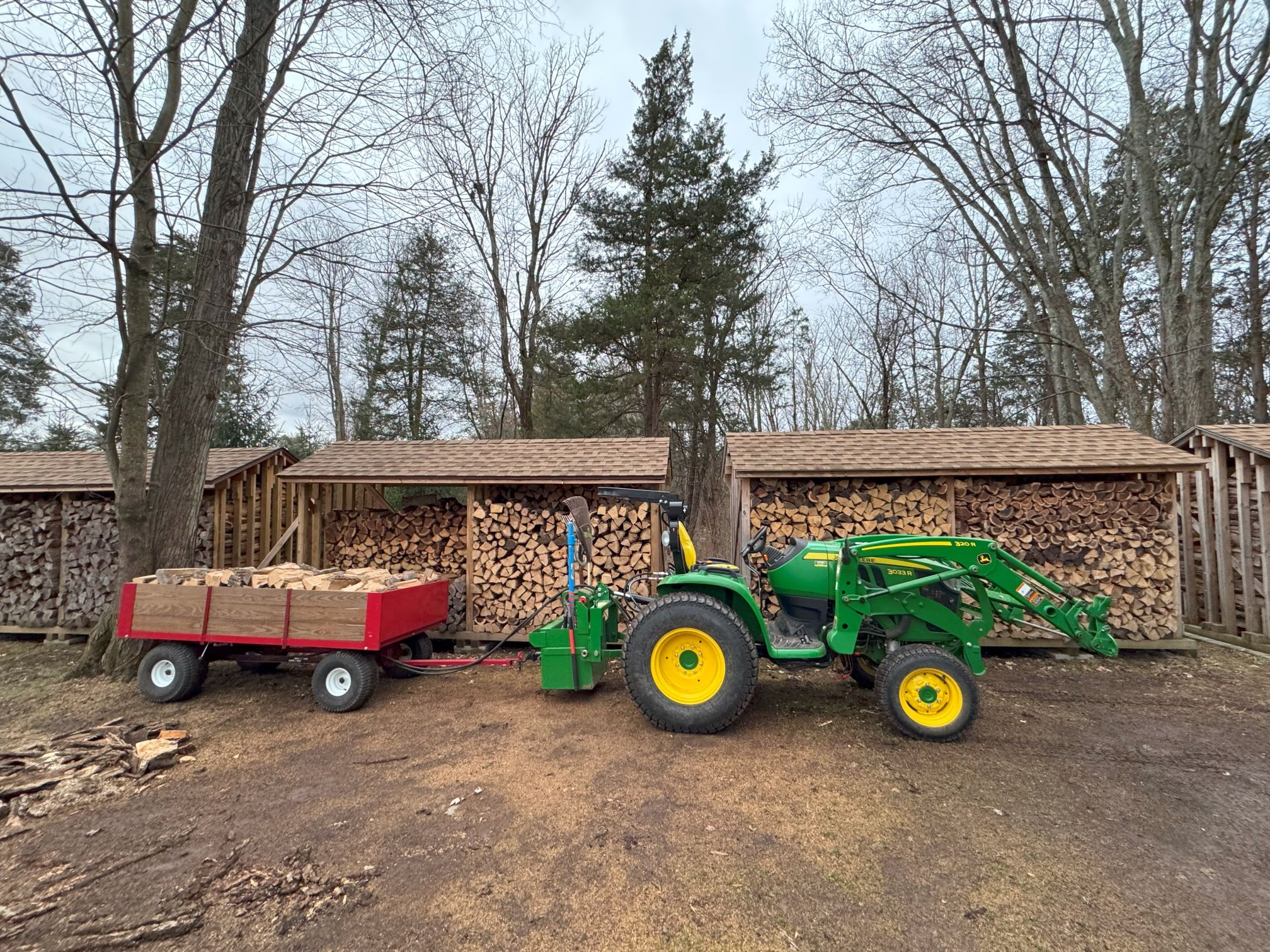

I guess this is supposed to be a photo thread, but since the site still blocks most images taken on newer phones ("file too large"), I always have to wait until I can be at a computer to convert and resize them.

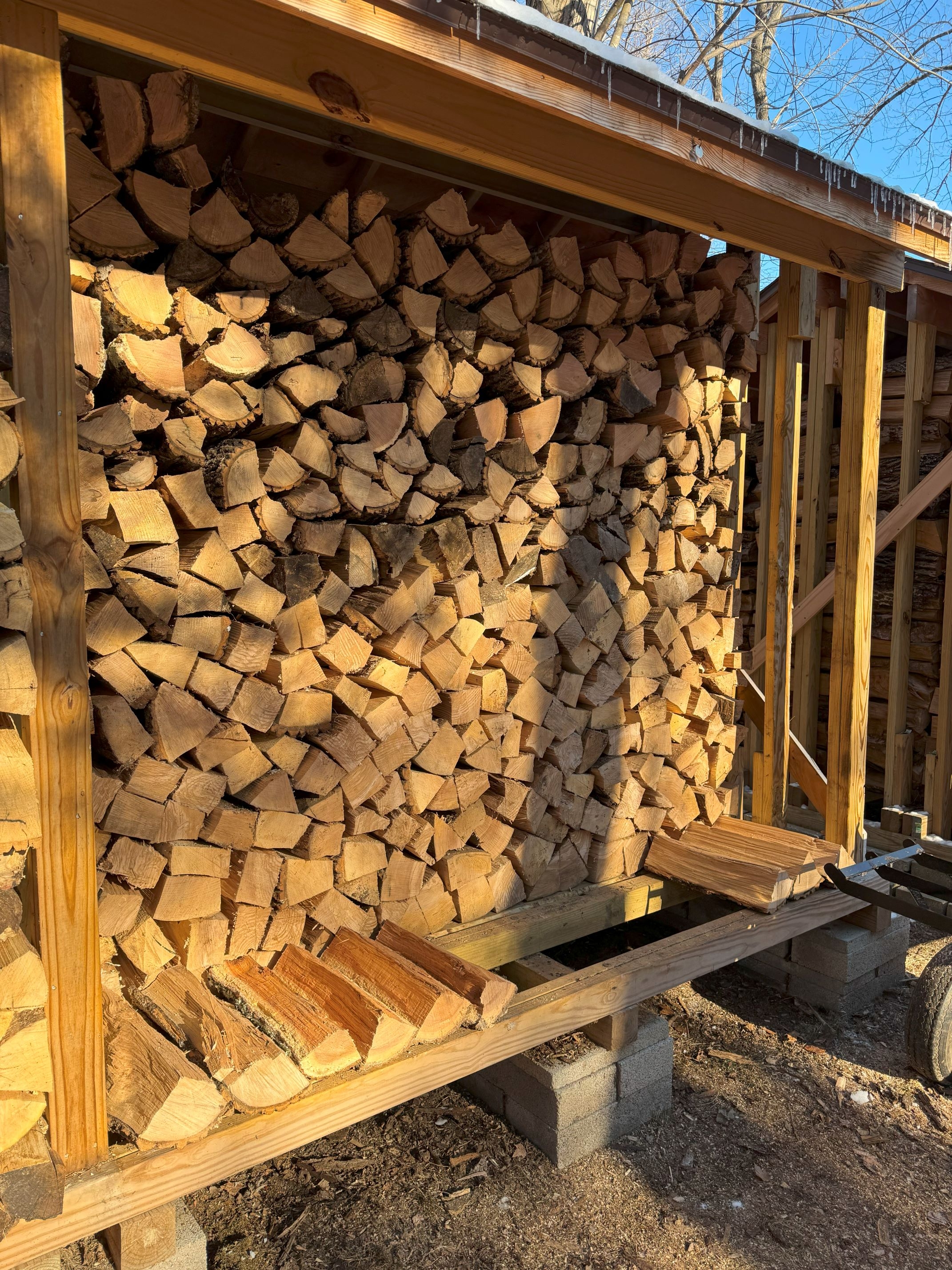

Here's a few from this past weekend. Moved more up to the house on Friday, then split a little over a cord between Saturday and Sunday, a little more than half of which was red oak, the remainder mostly ash, with a little walnut.

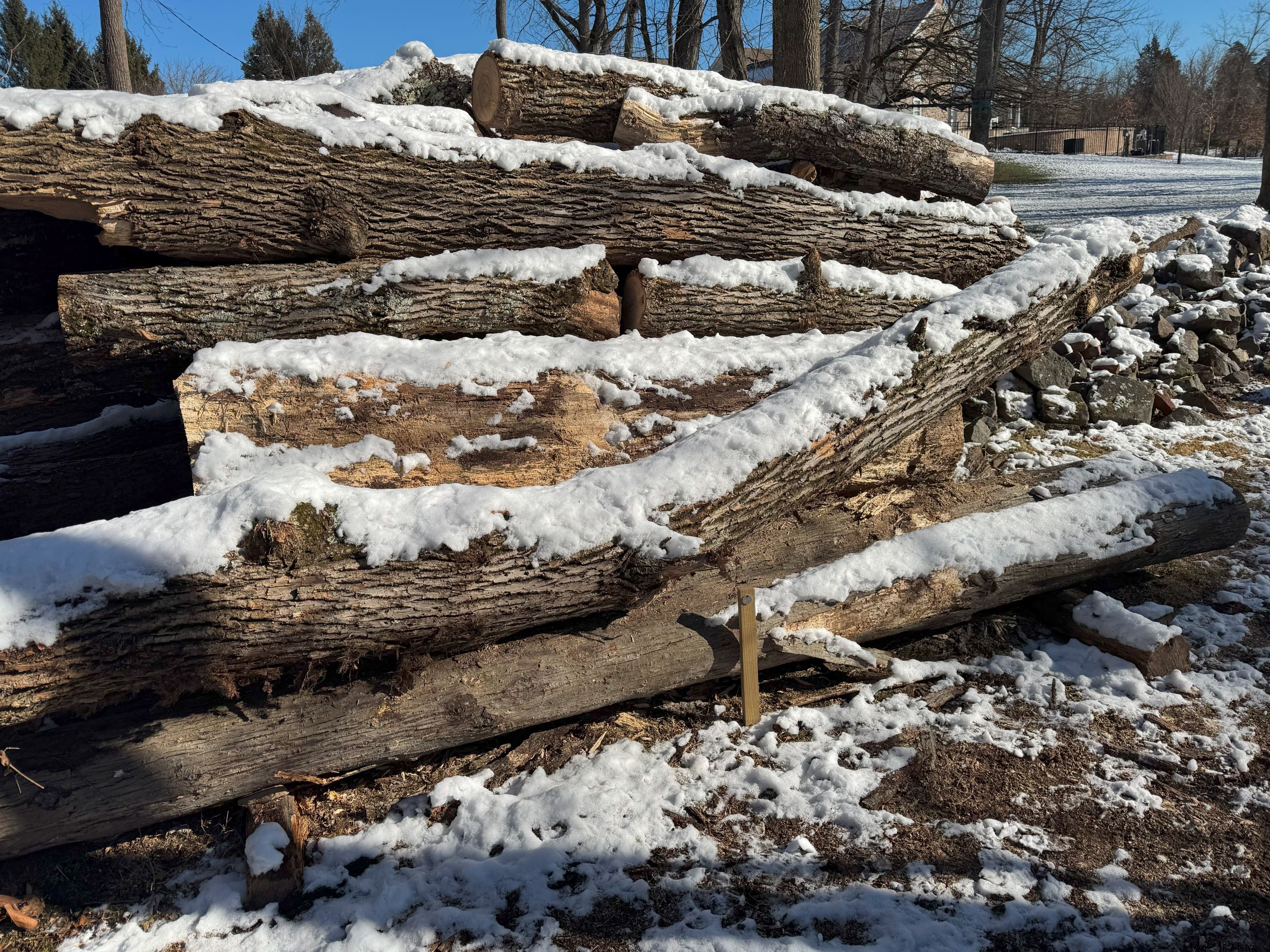

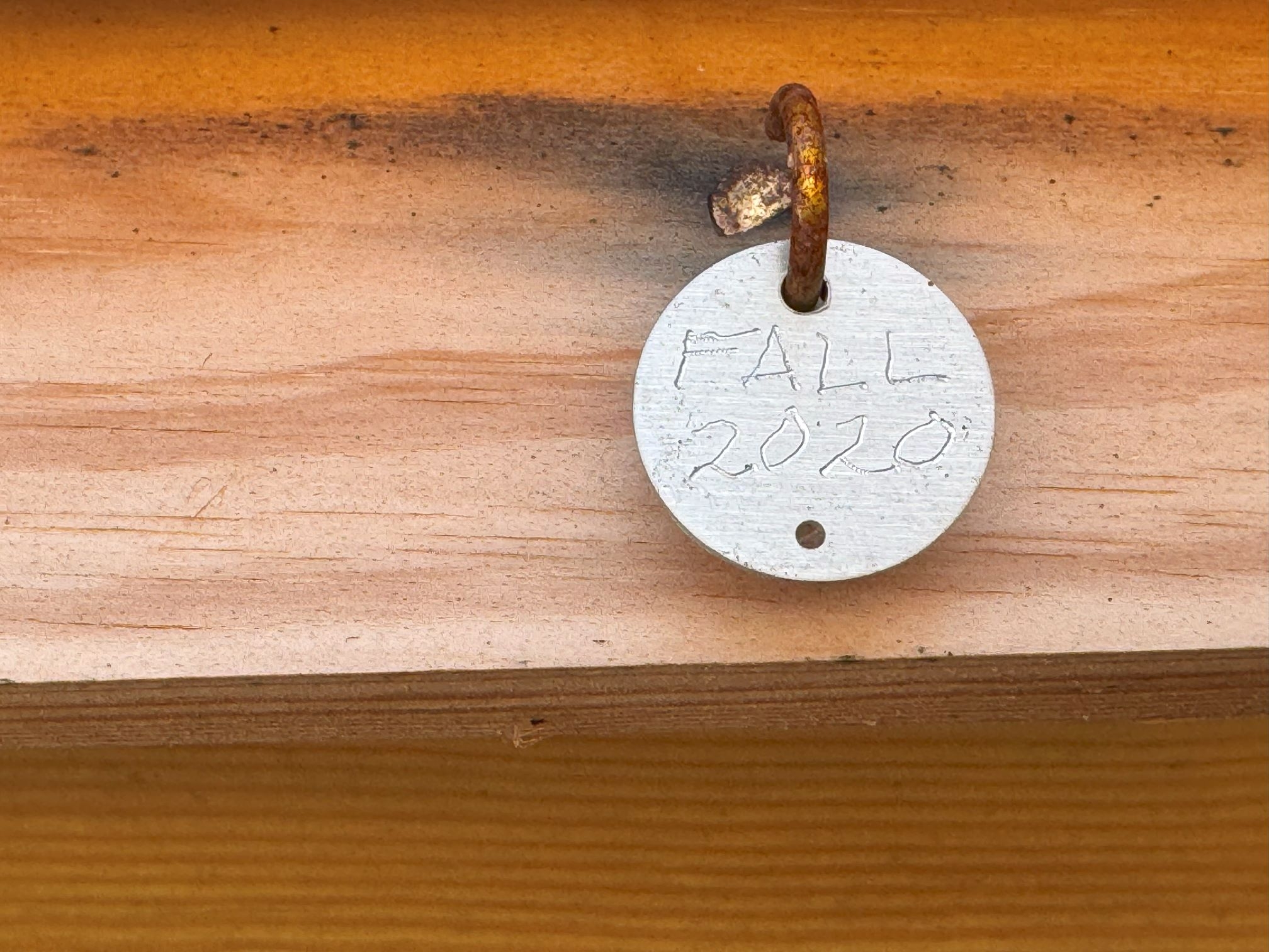

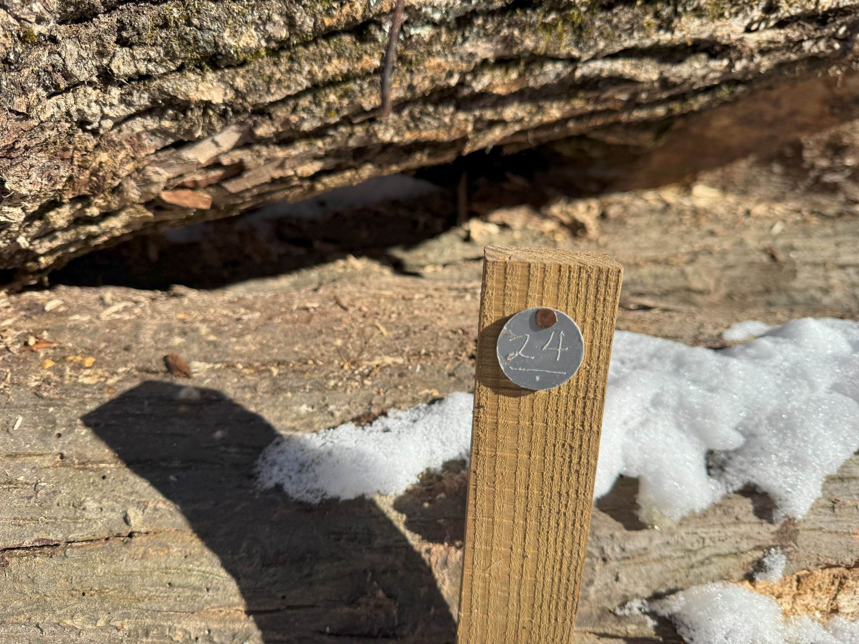

Pro tip: label your stock for easier FIFO rotation. I put a stake in the ground in front of each log pile, telling me what year the logs were harvested, as my "backlog" (pun?) can stretch 2 - 3 years. Then when I split and stack it into a shed, I hang a tag above the crib with the year and season it was split and stacked, where it usually sits and dries 3 - 4 years before burning:
And on the bark up vs bark down debate, I don't really care much which way mine faces, when stacking under a roof and sitting 3-4 years. But you will notice I always try to place the bottom row as bark down, when the pieces came from rounds small enough to actually have bark on each split:
Other than you guys out west burning softwoods, or someone burning exclusively ash, you should really try to get at least 3 summers of drying on all wood, after splitting. Wood does not dry in log form, I can split logs that have been stacked off the ground for 2+ years, and they're still wet inside. Only count time once split, and don't believe any wood seller who tells you the wood was "seasoned in log form". It just can't properly dry anywhere near what a modern stove requires, in log form.
