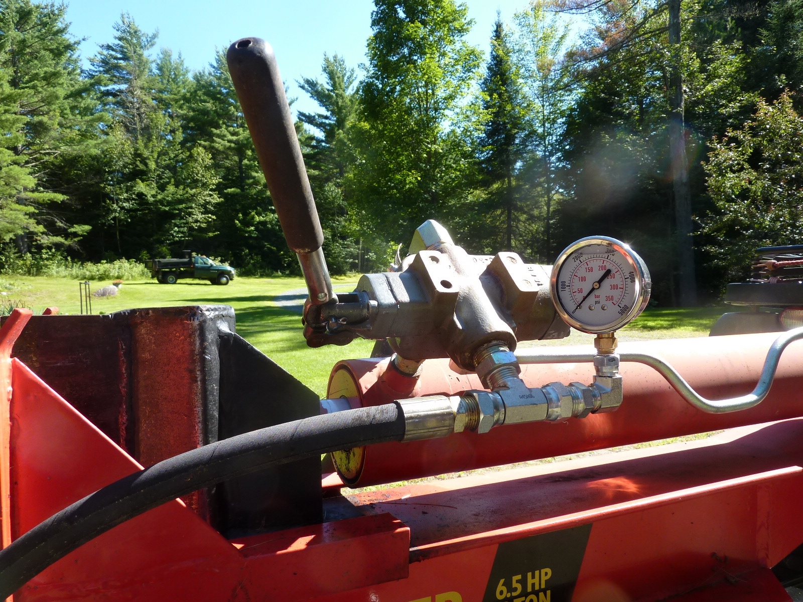

When I got my first powered splitter in 2013 I put a pressure gauge on it out of curiousity of what it really takes to do the job. It was the common 22 ton splitter with a 6.5 hp B&S motor on it. Peak pressure was 3500 psi to give 22 tons.
I was surprised that most stuff ( 80% I'd say ) split before the pressure got to 1000 psi - so less than a third of that 6.5 hp is used on average.

Gordon - Most pieces don't seem to strain any splitter I've used at all.
The other factor besides pressure is the size of the cylinder. A 5" diameter cylinder puts 56% more pressure on the log than a 4" cylinder at the same PSI

My first splitter was a Northern Tool advertised as 16 tons with a 5 hp B&S 4” cyl. It will split an 18” round of oak (red or white) with a 4 way attached and it’s been doing it for 26 yrs.
Your experiment has shed light on why it can which l initially always doubted.
A 14” gnarly or knotted round it will do w the single wedge.
