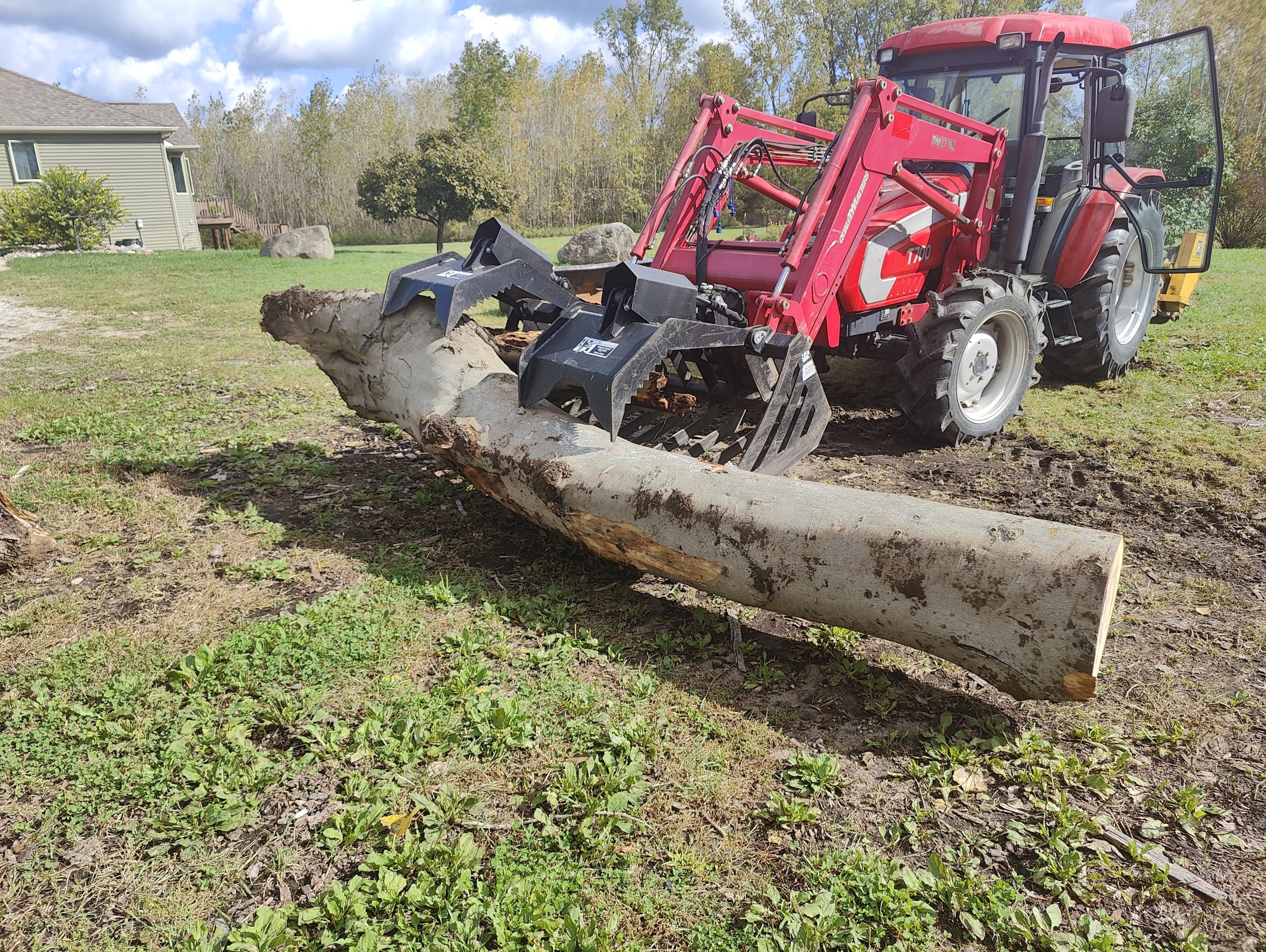

I posted this in another thread and then I found this thread and thought I would post it here. Should have seen the look on the guys face that was driving down the road when I was coming up it. Turned out it was my neighbor and we both had a chuckle.
