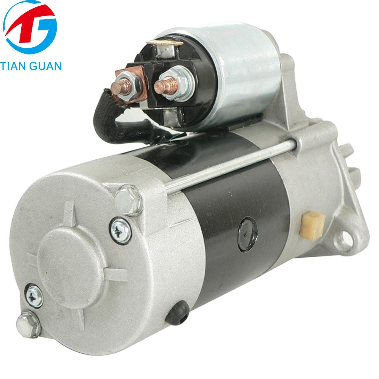

Is this what your starter and solenoid look like;

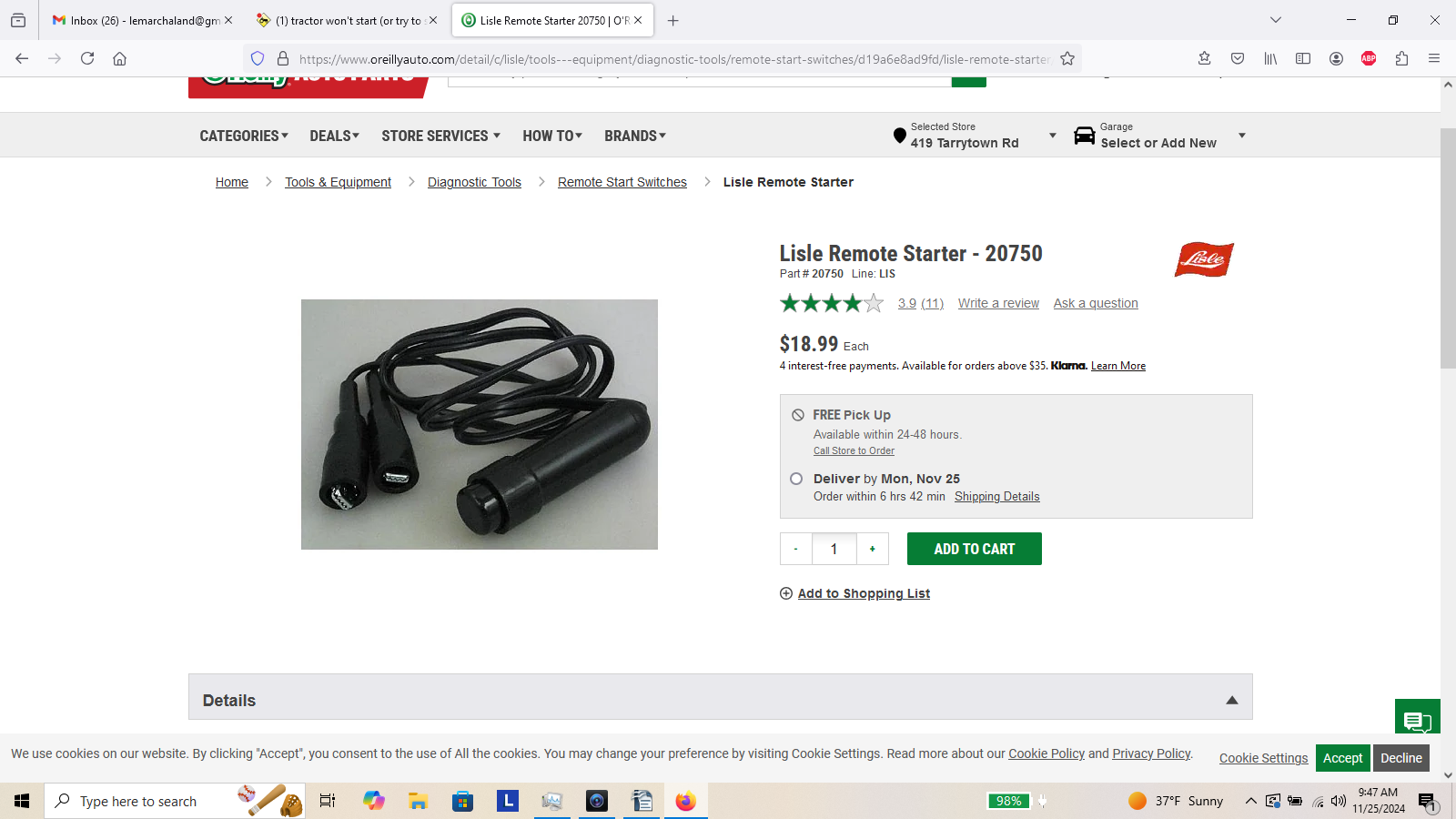

When you try and start it by "jumping" the solenoid if you are jumping across the two large posts the starter will just spin over. If you jump from the large battery stud to the smaller top flag type terminal it should crank over if your battery and cables are good.
The better way is with a remote starting switch.
Just be well aware that an engine can start using this at any time, in gear or not.
People have been hurt by getting run over.
Thank you. I was not trying to jump it right.
