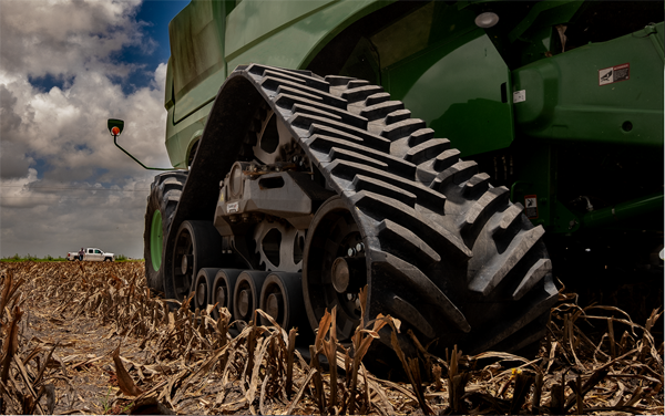

I have worked in many various off road environments for the past 30 years with all types of equipment. When conditions are such that you can sink lower ground pressure is key. We now primarily use rubber tracked machines with tracks 24" wide to reduce PSI. These machines weigh over 20k lbs and sink less in the mud than a person on foot.
So I guess to better answer your question soft can mean many things. If you can sink and get stuck then lightening your machine will help. If there is just a few inches of soft and a hard bottom then more weight might help you get around.
