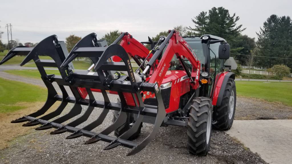

And the Massey Ferguson 4707 is 8600 pounds without weights or loader, 10,000 # with loader and weights
Provide MCKINNEY a ballpark price. He is only considering cab tractors.
   / TRACTOR WEIGHT as a SINGLE CRITERION IN TRACTOR SELECTION #77
New with self leveling loader, weights, Visio roof, Trellborg tires, deluxe cab, buddy seat, air ride seat, and 3rd function remote was $45000 20181026_114133.jpeg
