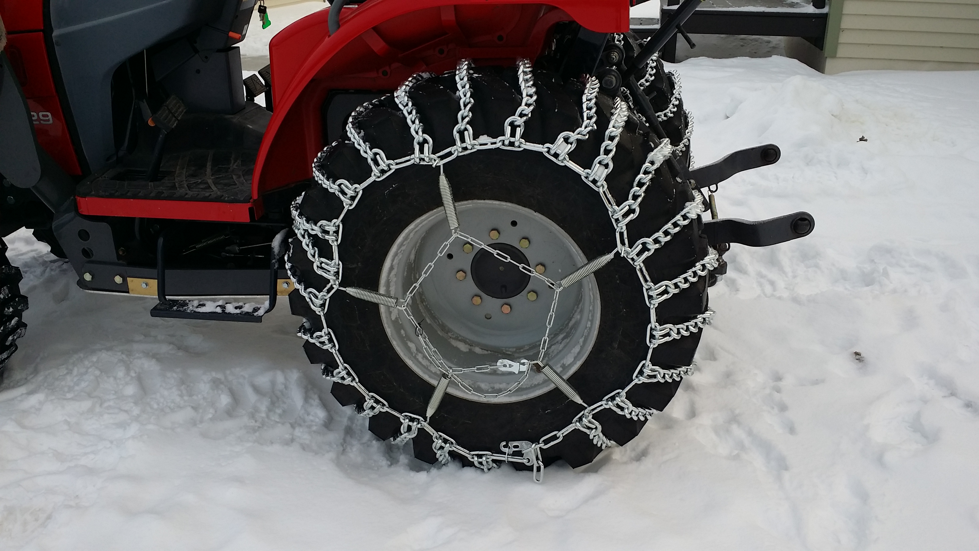

I picked these up in 2016 for my Massey 1529 which has R4 tires. Got them from tirechains.com The only reason I need them is for snow removal in my yard and driveway here in northern MN. I'm not doing field work in any kind of mud, etc. I occasinally am on the highway with them to drive to my neighbors to help them....they aren't the best for highway travel (kind of bumpy). I don't run chains on the front tires. For my needs, this setup works.
