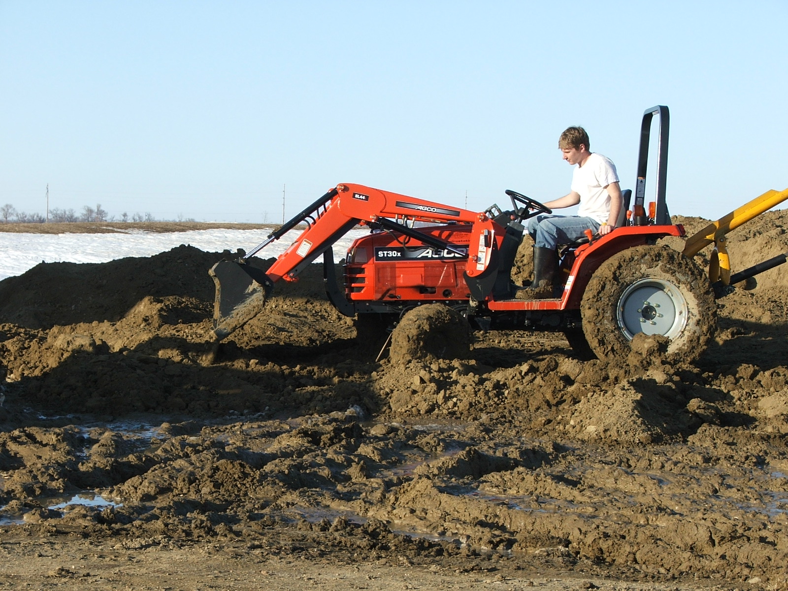

I use the FEL to get unstuck pretty often, although sometimes when i push the loader down into the mud suction is created, then when i try to pull the loader out of the mud it just pushes the front end down in the mud more. dont know if that makes any sense
