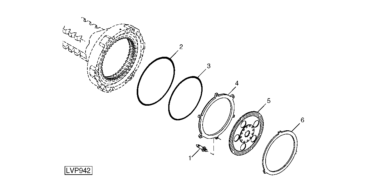

My JD 5203 tractor doesn't coast when I clutch. it doesn't coast even when it is in neutral. If you clutch and slip it out do gear -it stop- even if you are going down hill!
Is this a safety thing or is something wrong with my tractor? It's like the parking brake is like the parking brake is slightly engaged all the time. I am wondering if I am somehow powering through a brake.
I don't know if this has been like this all along or I am just now noticing it? I don't think so.
Any and all help appreciated.

I think your brakes are dragging and you need to correct that before you burn up your brakes. A geared tractor should coast just like a car when clutched or in neutral. HST is different but still will coast when in neutral. If you have a parking brake it could be adjusted too tight causing drag or the foot brakes might be hanging up, regardless the cause, you need to get it fixed.
   / Tractor stops when clutch depressed ... doesn't coast ... #3
JD 5000 series tractors such as your 5203 have a history of the brake pull off springs(parts key 1) weakening requiring R&R of rear axle housings.

Check out this thread under parts/repairs on this site. He did away with the springs.
JD 5300 Brake springs??? Help??
hookdrvr
   / Tractor stops when clutch depressed ... doesn't coast ... #6
yep..txjim nailed it..get busy with about 500 in parts..unless ya break the disc
