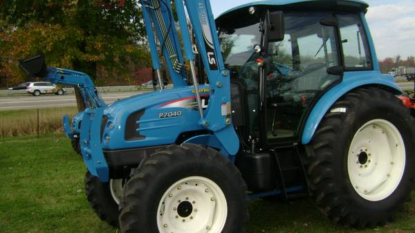

New LS 7040CPS tractor loader, 97hp
   / Tractor size advice needed #32
5K less than your quote.
New LS 7040CPS tractor loader, 97hp From the craigslist ad:
New LS 7040CPS tractor loader, 97hp - $49900 (284 E Six Mile Rd. Whitmore Lake MI)
Last of the tier III tractors, 4x4, Cab w/heat and AC, 40 forward speed transmission, 20 reverse, power shift, sterio, three remote hydraulics, 13.6x24 front tires, 18.4x34 rear tires, 85hp at pto, LL7101 self leveling loader, 136.4" lift, weight of loader is 2984lbs, lift capacity at piviot pins is 3,500lbs, lift capacity 3 point hitch is 6,173lbs,
00C0C_hvW8kIlP4vY_600x450.jpg00i0i_kWtC0uUkreS_600x450.jpg00q0q_13XG8gMeG3D_600x450.jpg00x0x_bEPbEiyhCPJ_600x450.jpg
Thanks, but I would not want it. It is huge! It won't go where or do what the Toolcat will go and do, with 27gpm High Flow Hydraulics, 61hp, independent suspension, 4 wheel steer, and 4 wheel drive.
I know there are a few things a tractor can do that a Toolcat can't do, but nothing that I need done on my place.
