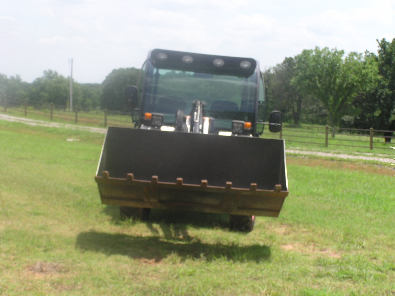

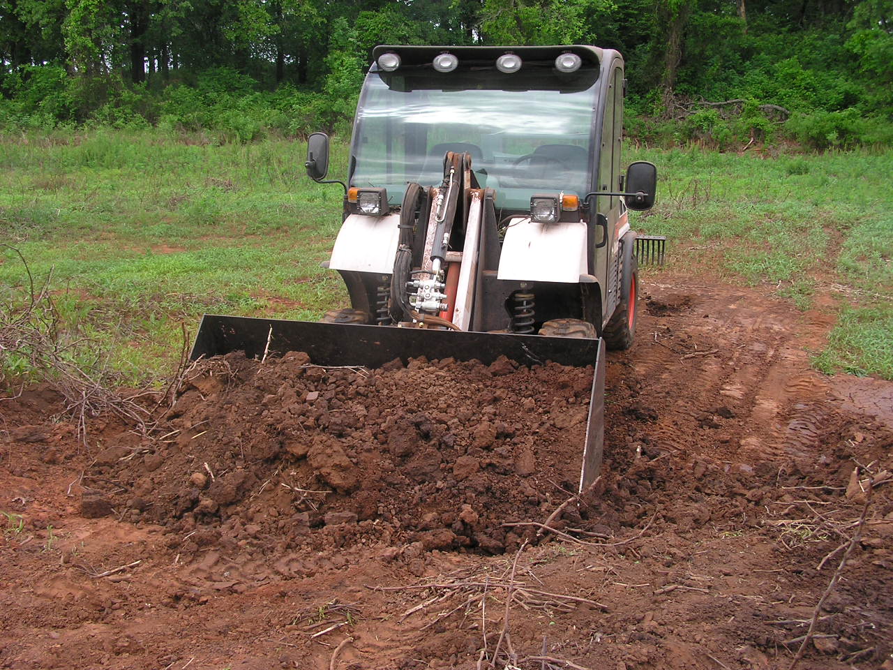

Does it have to be a tractor?

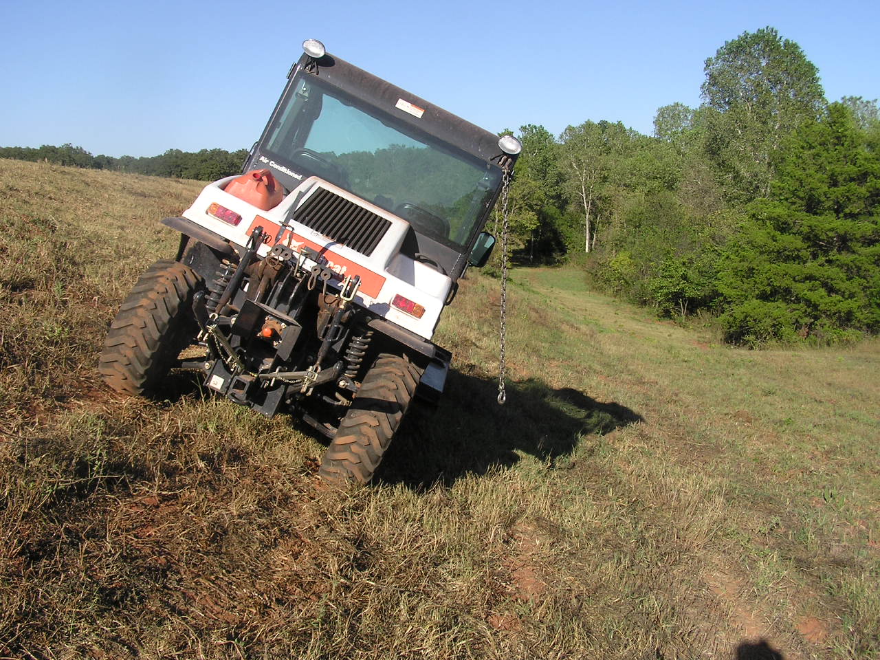

Here is a machine that costs more than tractors its size, but will do more and is great for plowing or blowing snow.
It has independent suspension, 4 wheel steer, 4 wheel drive, cab with heat, air conditioning and a passenger seat. It is 5' wide, Skid Steer Quick Attach (SSQA), 3 point and PTO.

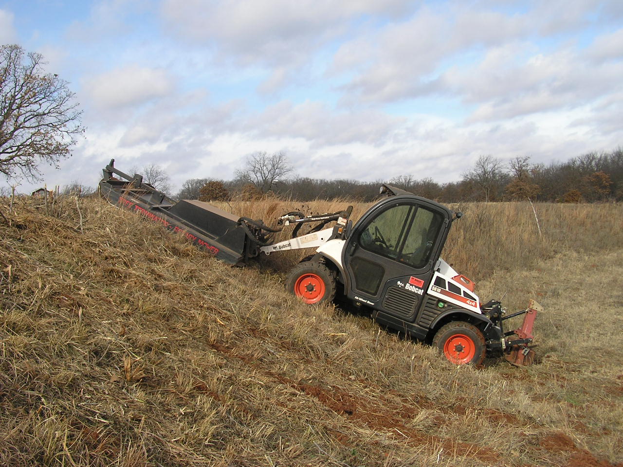

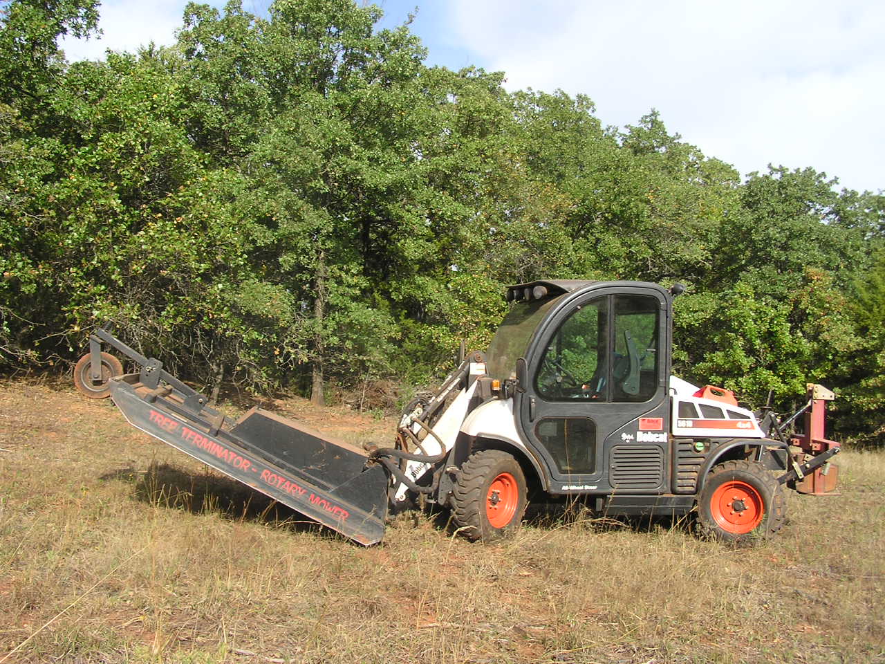

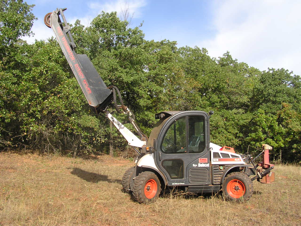

The 7' brush hog.

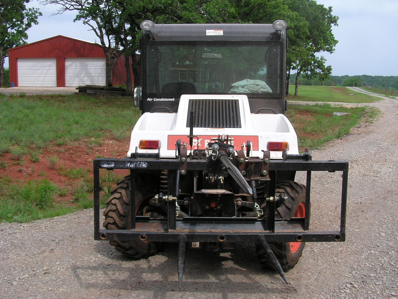

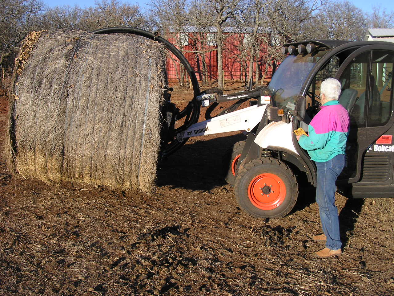

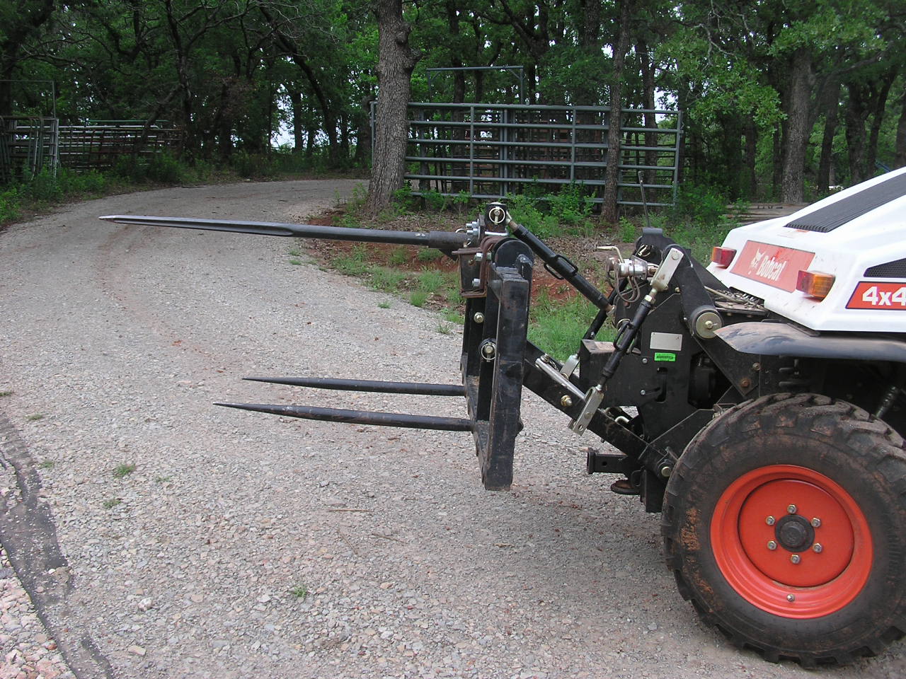

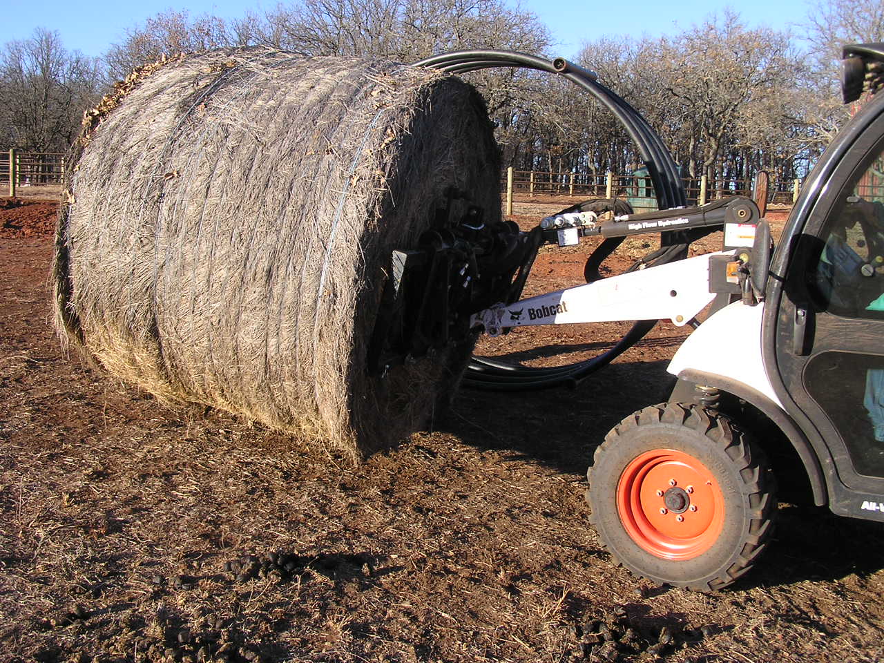

My wife setting out a 5x6 round bale and it will carry one on the back also.

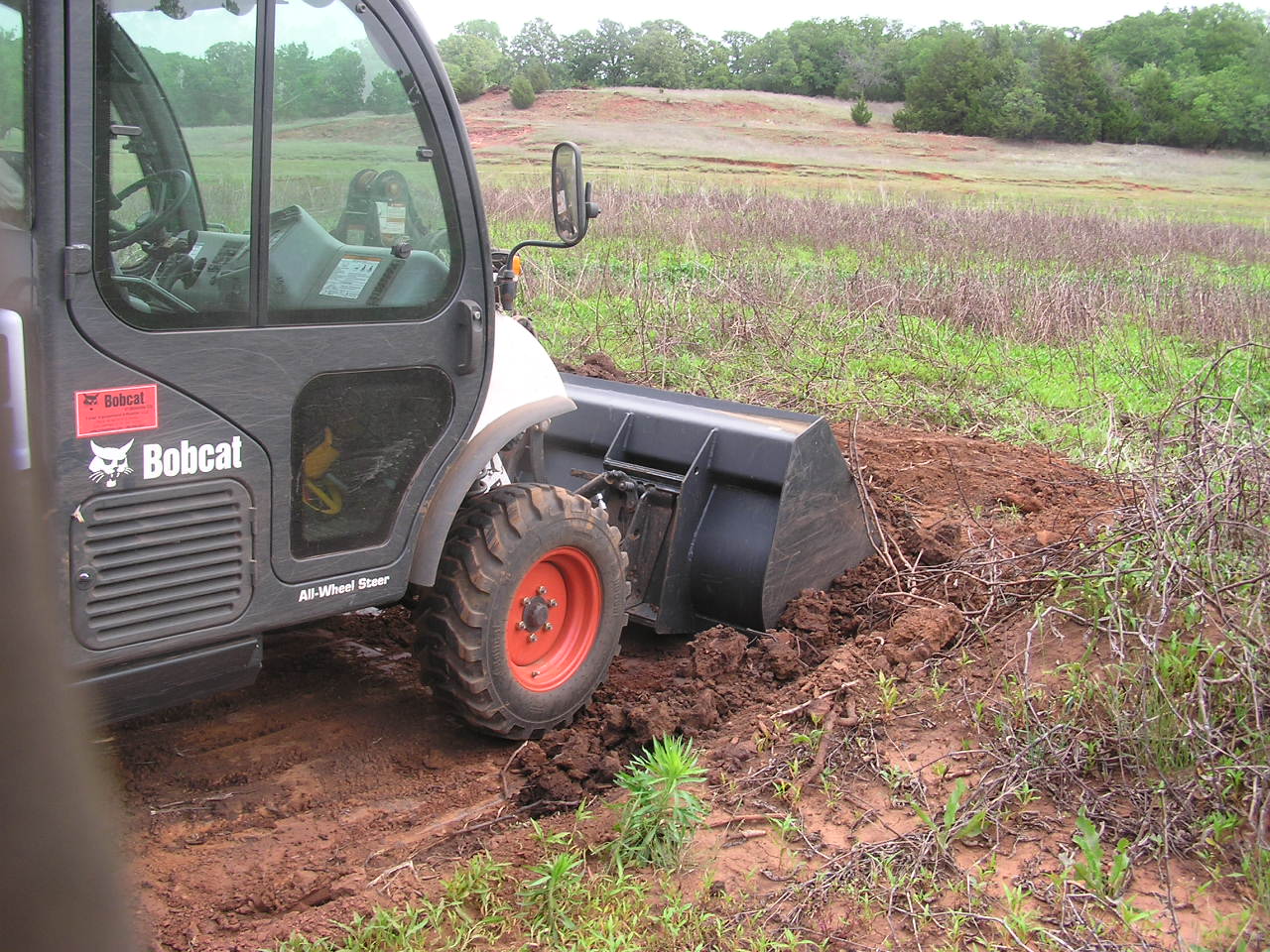

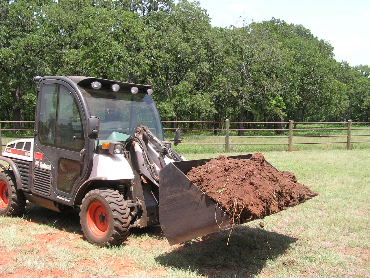

The 6' wide, one cubic yard bucket.
