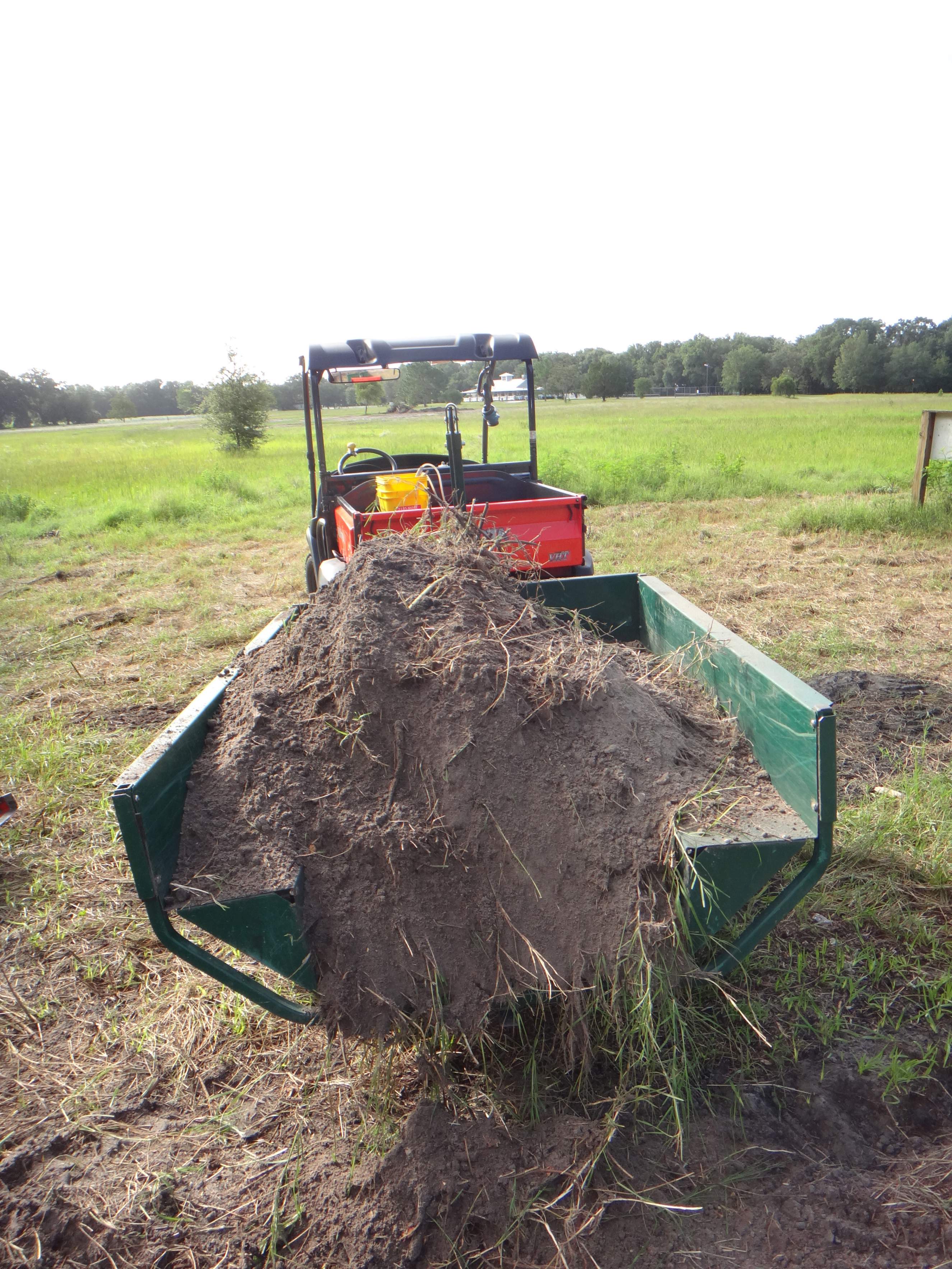

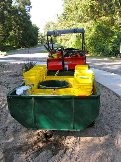

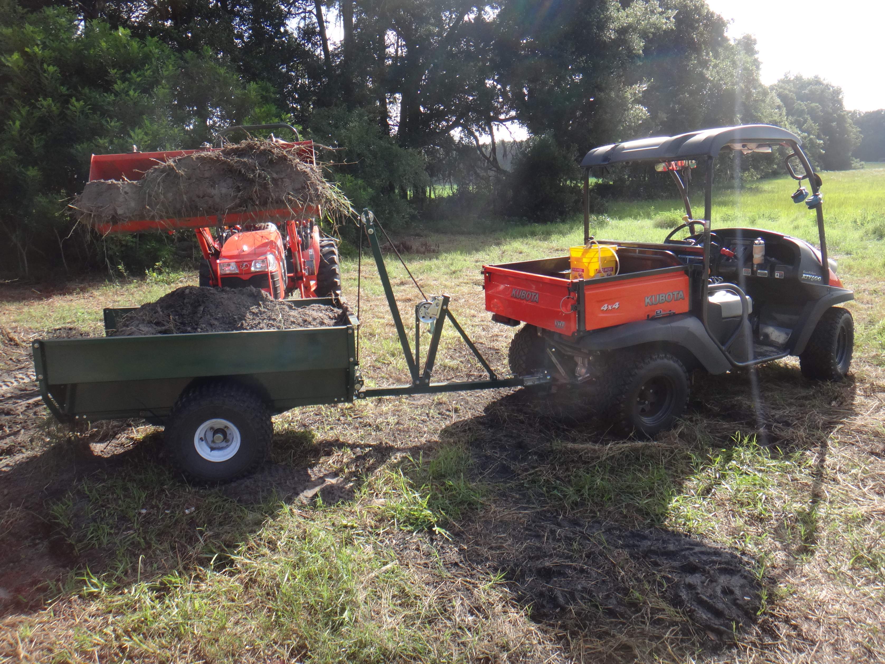

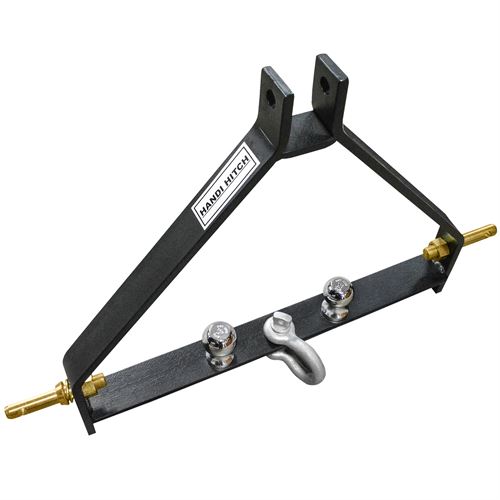

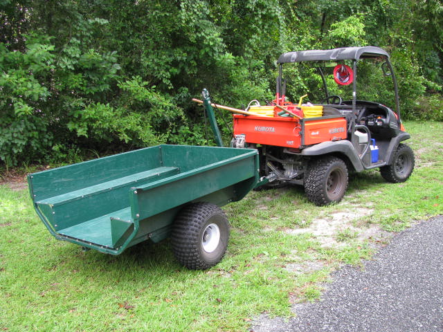

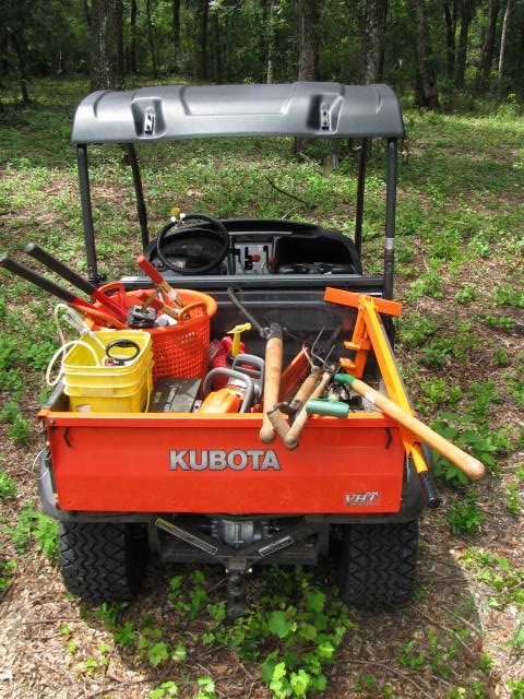

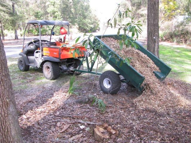

While you are at Kubota, check out the RTV500/HST.
The "best of class" all terrain dump trailer is the MUTS from Canada.
LINK: MUTS THE BEST ATV WORK TRAILER EVER!
However, as much as I use my RTV500, I recommend applying that $10,000 toward the $18,000 L2501 tractor/loader; much more "bang" for the buck in the L2501. Get the L2501 FIRST, add the RTV500 later. You can tow a trailer behind the tractor, using a Handi-Hitch or something similar. You run chain through the clevis shackle on the Handi-Hitch to pull trees, with the tree butts elevated.
