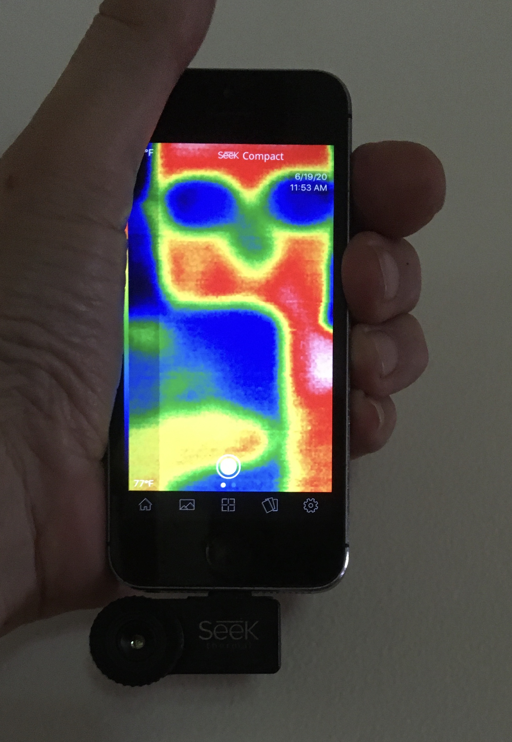

I'm using point & shoot digital thermometers less since getting thermal cameras. One was <$200 (Seek Thermal) and clips to my iPhone. (i5 S is a 'drone' sort of, has SIM card but is no longer 'activated')
The little 'Seek' is great for service work, finding hot wires or weak wall insulation, etc and crazy much under a hood. I can use a 'gun' to get actual temps but the cam shows me where to check and has color palette options to relate to surrounding components. Using Apple's 'lightning' it can be connected to face to front or back on the phone.
