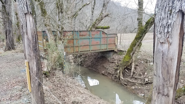

Here ya go..........:
Hard to see, but this bridge sits on one concrete 'pig' as abutments at each end. They are heavy, so you will need a backhoe or a large front end loader to move and set them.
   / Tractor over trail Bridge? #34
Is that an old truck bed of some kind?
