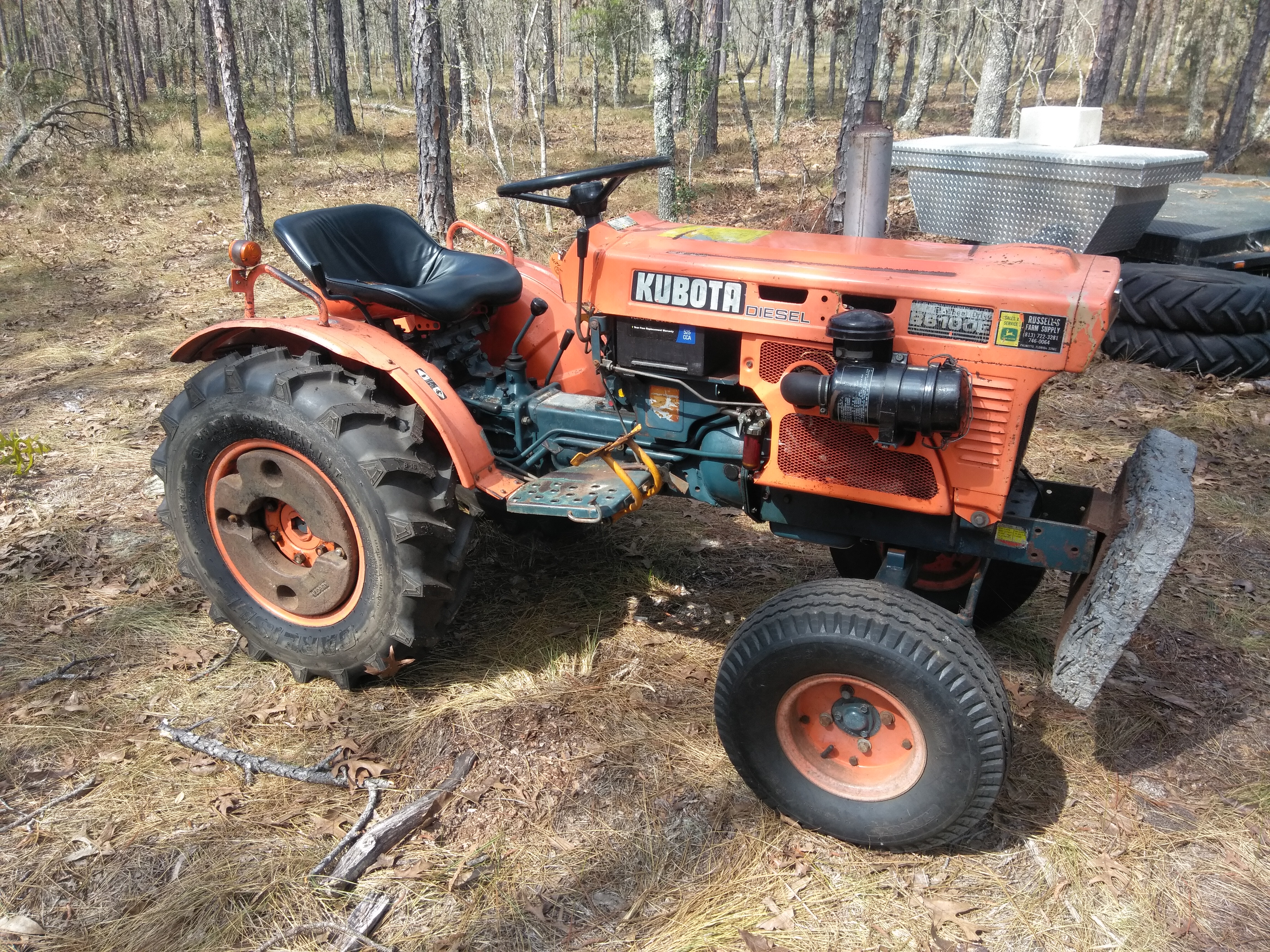

Is there an avail options list for Kubota L2501 tractor, Im wondering what my options are as far as I know there is a possibility of adding a brushguard, a more comfortable seat, maybe floormats are avail?
Id like to know what is avail and at what cost.
Im hoping to gather this info myself versus relying on the dealer to inform me.

Thanks, I seen a you tube video where he mentioned a more comfortable seat or deluxe seat with arm rests, I didnt see it on the Kubota site?
Also my B series has rear wheel weights, I think they are a big help in the sand I have to deal with, Kubota site mentions wheel weights but no picture, are these possibly the same and would you say they would be a wise choice?
It also is telling me that adding a front loader and grille guard isnt possible? I am pretty sure Ive seem it on You tube so Im assuming it has to be fact?
Can someone explain to me the rear remote hydraulic valves??? Would I already be getting these since Im ordering with a backhoe?
On the loader package they offer 2 options
1- HEAVY DUTY FRONT LOADER PACKAGE
2- HEAVY DUTY FRONT LOADER W/2-LEVER STYLE COUPLER
What are the differences? Im getting a quick disconnect bucket, safe to assume thats option 2?
Im also needing a grapler yet I see none listed?
On the backhoe they offer a rubber stabalizer, Im assuming that would be helpfull on a hard surface but useless on sand?

Weight is always a good thing when harrowing or pulling a turn plow or doing loader work where your bucket will be full of heavy material that you will be moving such as gravel or limerock, imho loaded rear tires usually do the trick for the loader work , for the other work mentioned wheel weights in conjunction with loaded tires is a bonus for traction when needed. Charlie.

If you opt for a Backhoe very few would also install wheel weights. Backhoe is 600 pounds, cantilevered well to the rear, with adjustable reach for additional counterbalance leverage if needed.
The Backhoe will only be off when you intend to mount a Three Point Hitch implement.
Personally, I would not "load" the rear tires with a Backhoe order. Others would. Too much weight for sand.

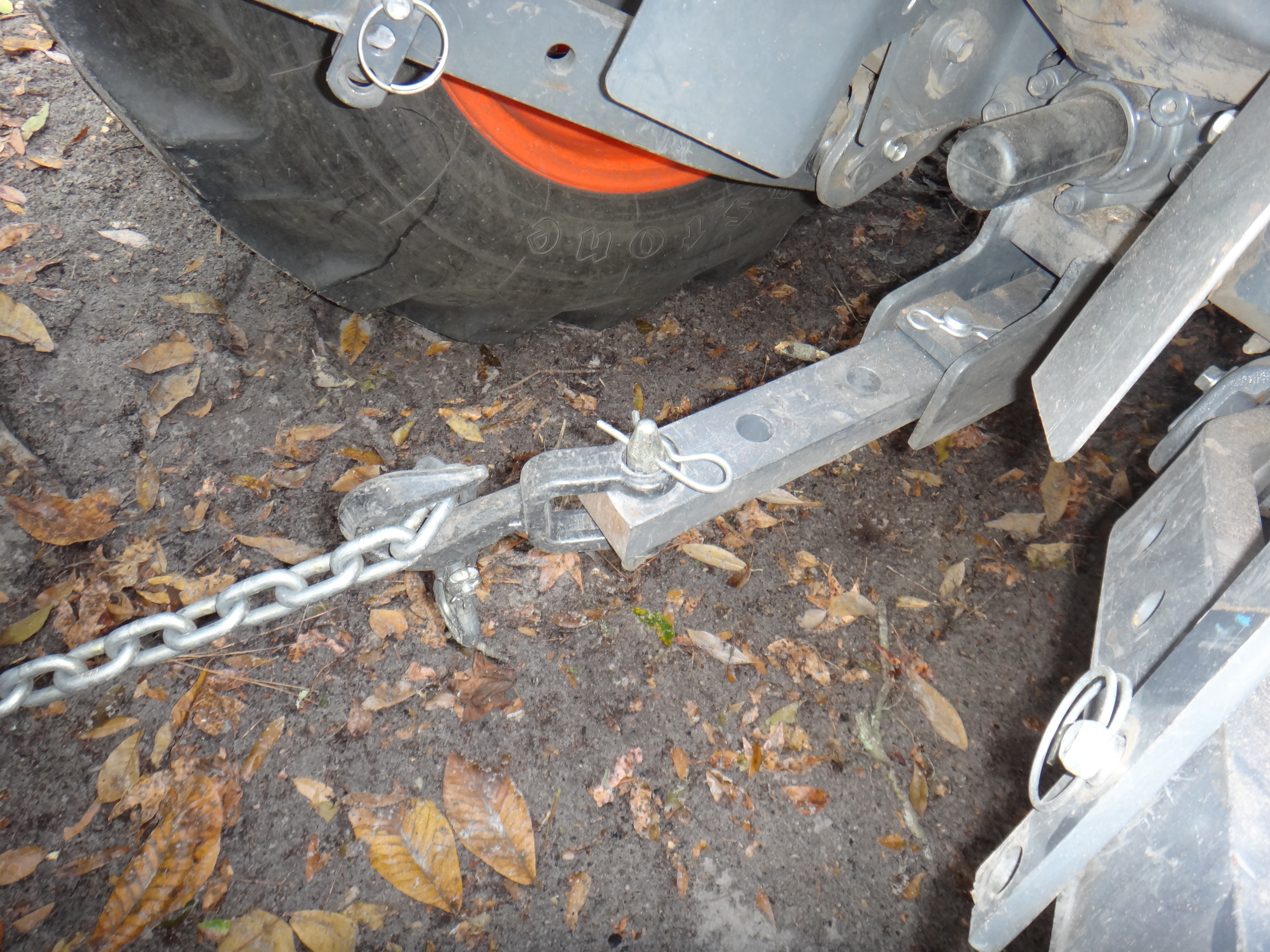

I suggest you order Kubota's rear/center drawbar for L2501 for dragging trees, etc.
Yes. Kubota terms industry standard SSQA "two-lever coupler".
