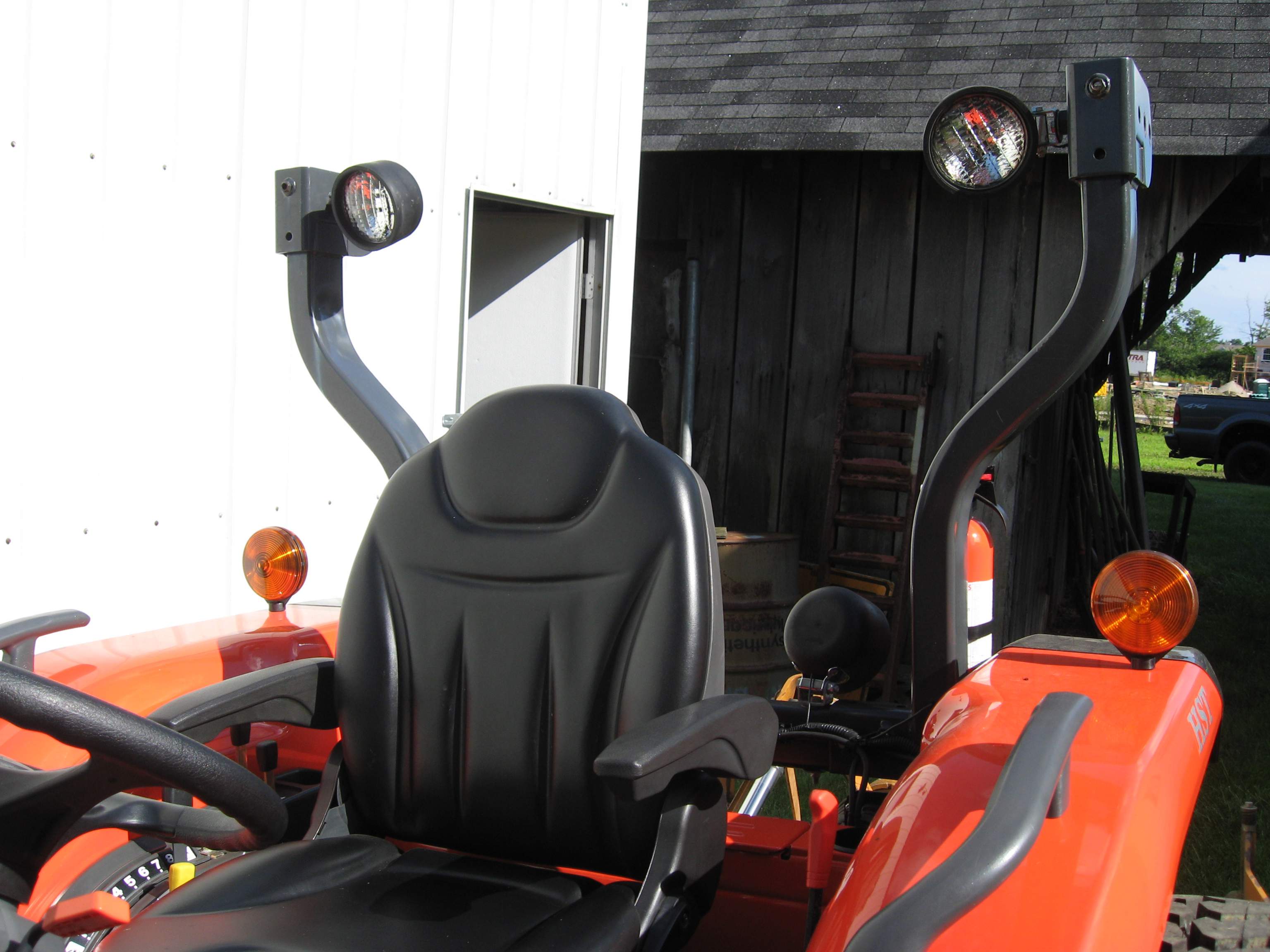

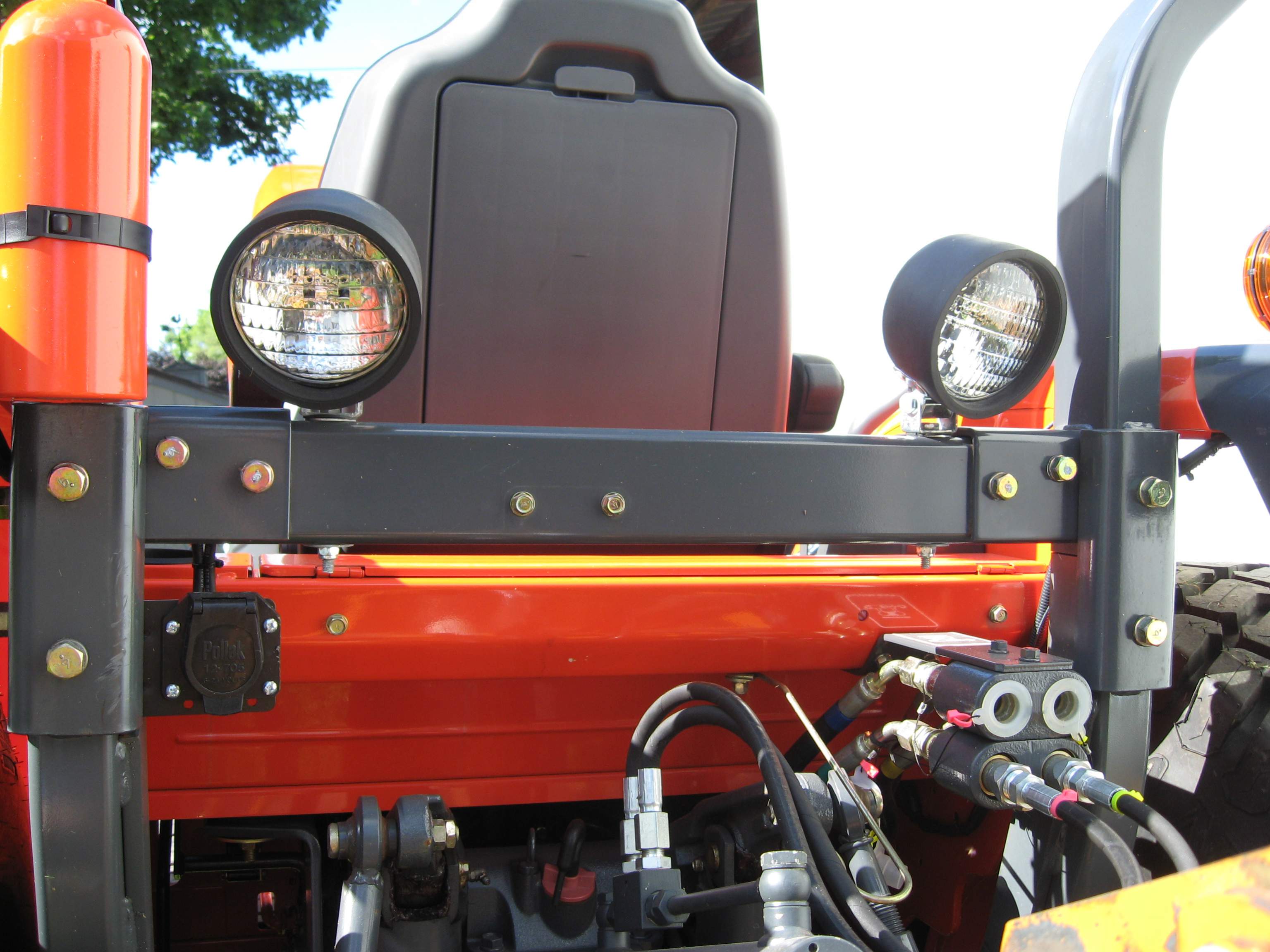

been meaning to ask this a while , issue is I have a front end loader and at night the lights are useless because of the bucket , raising it up is to dangerous , i just came down a long logging road at night and need to do something to where I can see at night , anyone come up with a genius workaround to this problem? , Im thinking somehow mount lights on the bucket frame

It would be better to mount the lights on a Canopy. The lights would most likely be damaged if mounted on the bucket itself.
ahah !, no canopy but I do think it would work under the ROPS bar angled down ahead , maybe some front and back , that's an excellent idea , thank you
/ Tractor Lights 3430 with front loader , useless #5
Here is what I did. Philip.
