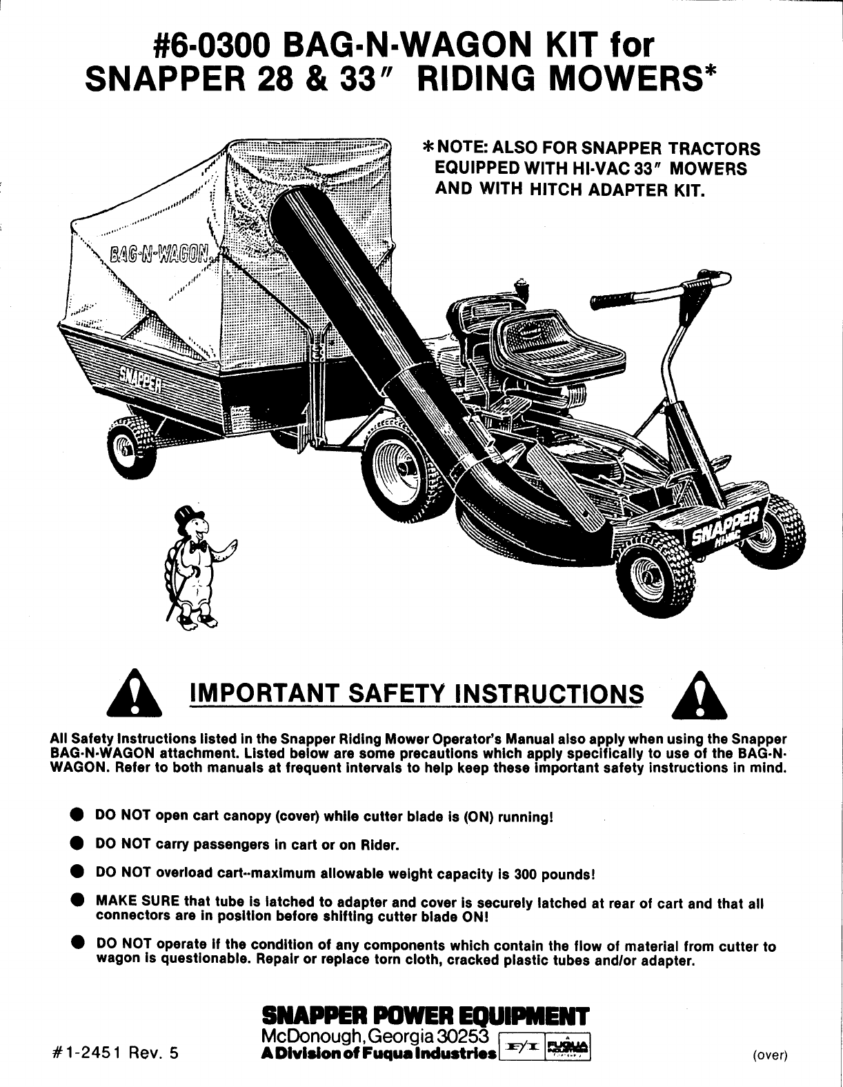

Or, you could make the tube completely rigid like snapper used to do on their bag n wagon....
485965d1477450448-tractor-leaf-pickup-leaf-blower-8e6c0279-cd37-fc74-8d45-7862b7ad0930

As that Snapper cart showed, they used a rigid tube and a fabric tent on the cart. The tent moves. The tube doesn't. That might be a cheaper alternative to flex tubing.
