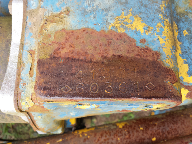

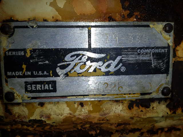

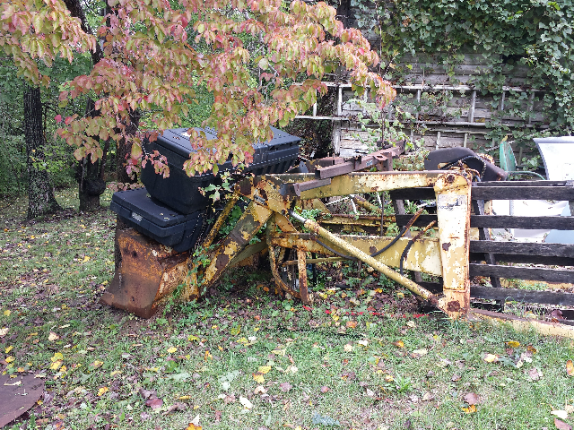

Was wondering if someone could help me identify this tractor. It looks like an 800 series industrial tractor from the 60's. Has loader/backhoe attachment all for $1500. Thanks in advance for any info.

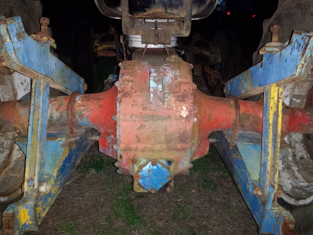

Based on this page, it's either a 2000 or 4000 built after 64 and a different rear on it. It doesn't have a pto or hydraulics even though the model number says it was equipped with a pto. Looks to have a Sherman backhoe. Just wondering if it's worth picking up at $1500 or less with the loader and hoe. I would get it if the power steering would swap over to my Ford 2600, but I doubt that would be the case.

I agree that this is a ford 2000 or 4000 industrial. based off of the size of the hoe it is a 4000. Is it worth 1500 is only a question you can answer for yourself.

How are you going to get the loader and backhoe home?
The tractor can be pulled / pushed on a trailer, but the loader and BH will need to be loaded.

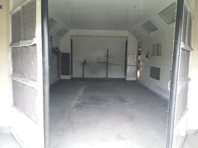

Thanks for the advice/info. I also felt it could potentially be a money pit. But if most of the other major things you mentioned are serviceable (cylinders/pump), the I too think it would be a cool project. It supposedly has a new clutch in it. I will be back down there Thursday and will look it over more closely. I may be able to get it for half that since I am family. The transport part is the most tricky part of all this, like you said. I may be able to come up with something. I'm buying the paint booth that is there for my buddy for $1500. I can get him to paint it for me. :)

1964 4000 series light industrial non-adjustable front axle and a 4-speed trans w/PTO

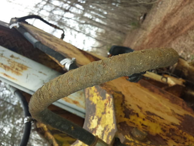

Yes its ugly, but if it is mechanically sound, and the hoe and loader dont have alot of rotted hoses and pitted cylinders, as ugly as it is, in working condition would fetch ~$3k-$4k around here. And 5k-6k for a good looking one that was also a good runner with no major issues

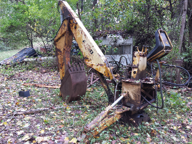

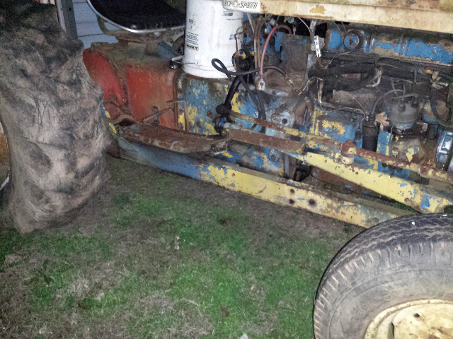

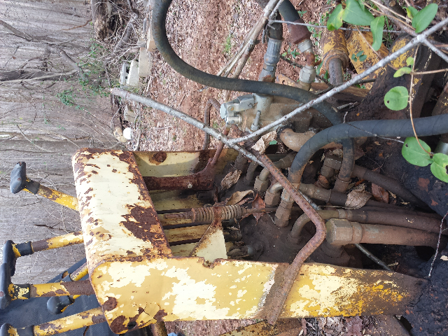

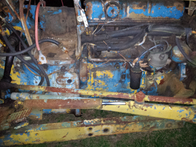

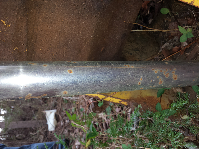

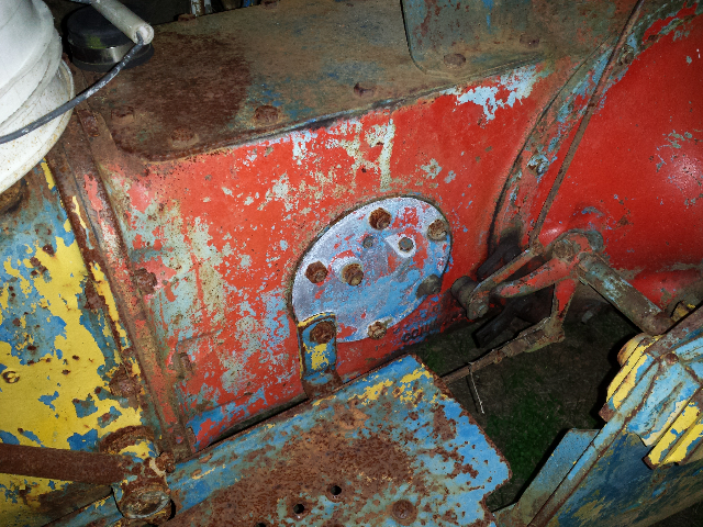

Got to take a better look at this bad boy today. Some of the hoses on the backhoe look like the will need to be replaced. Some of the cylinders have some nicks and a little pitting. Not real sure what to do with this thing. Might be able to get it for half of what they are asking (asking $1500). Anyway, here are some pics.

The model number indicates a 4000. The steering is of the 2000 style of the day and the next generation 2000 & 3000. The rear axle is agricultural red suggesting a replacement. The rust spots on the cylinder rods could be polished with crocus cloth to smooth them out to likely avoid damaging the rod seals. I can't tell if the backhoe is a 713 (10 ft.) or a 723 (13 ft.).
