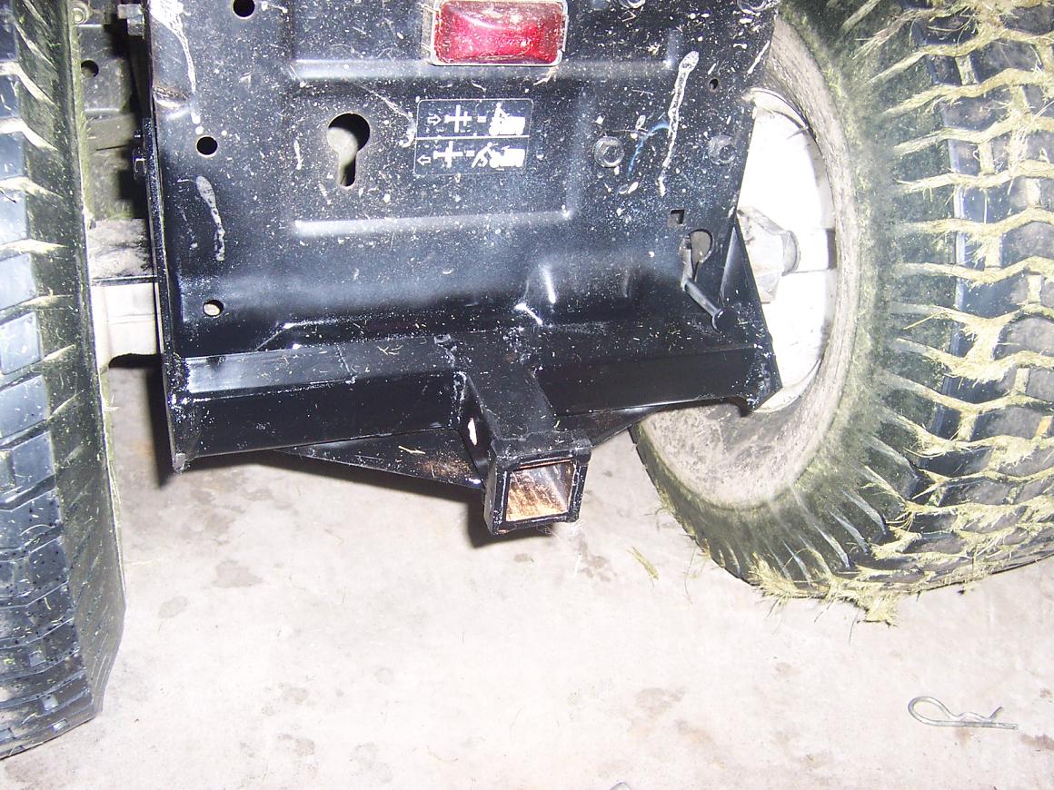

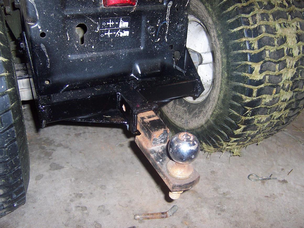

Hi,
Not a big deal when you consider some of the outstanding home built stuff shared on this site, but here's what I've been up to.
I have a lawn tractor that I use to de-thatch and aerate my lawn. Also have been wanting to use it to move my utility trailer around, but the trailer has a regular ball hitch on it. So I finally got around to building a receiver hitch for the tractor. It's a 1.25" receiver. I'm now in the process of make a mount that will allow me to use my regular tractor implements.
Here's a couple of pics. There's a bolt on each side connecting support straps to the frame of the tractor. There's also a bolt on the bottom of the hitch that goes through the stock tractor hitch. It's pretty solid.
Doug

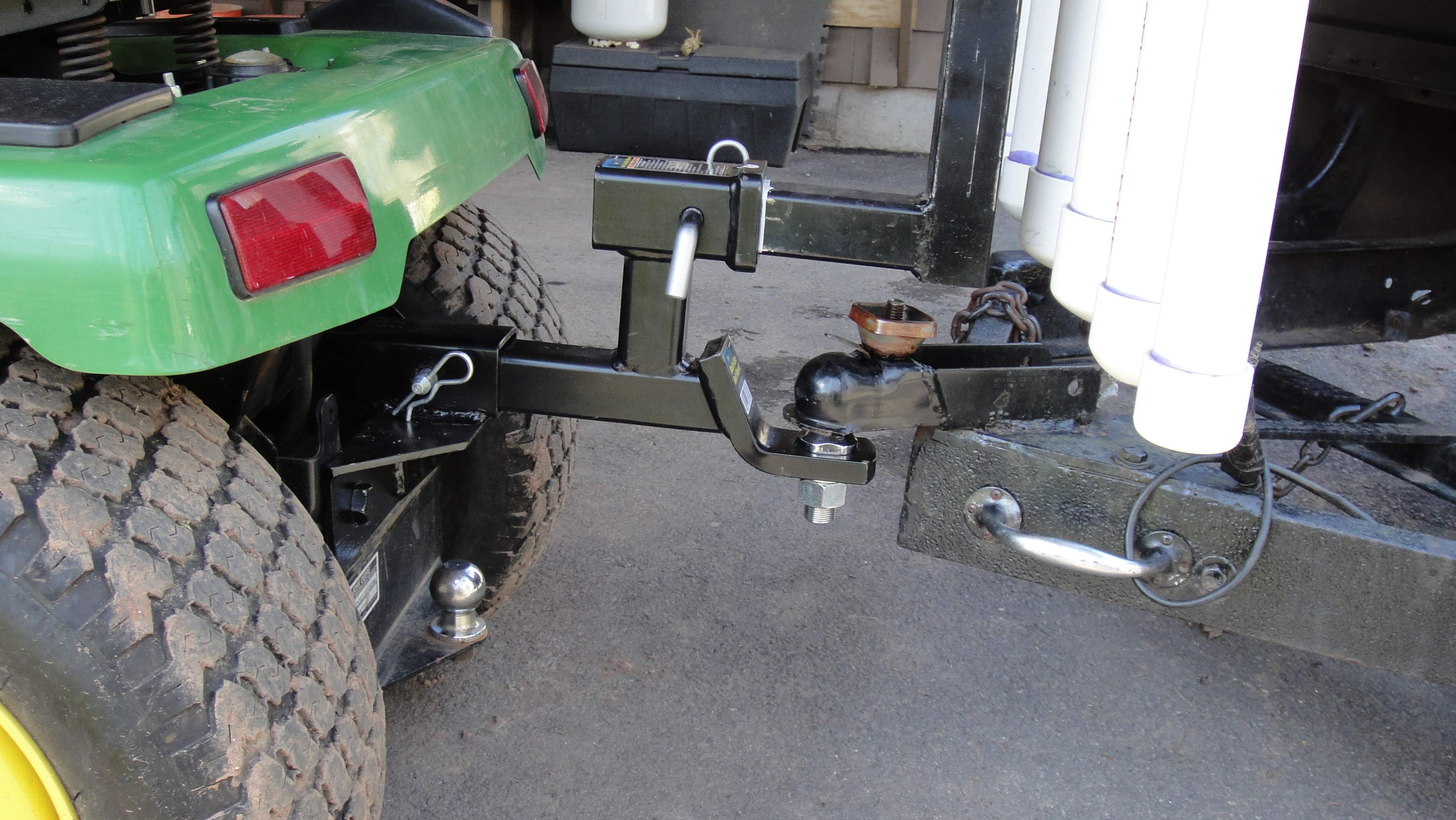

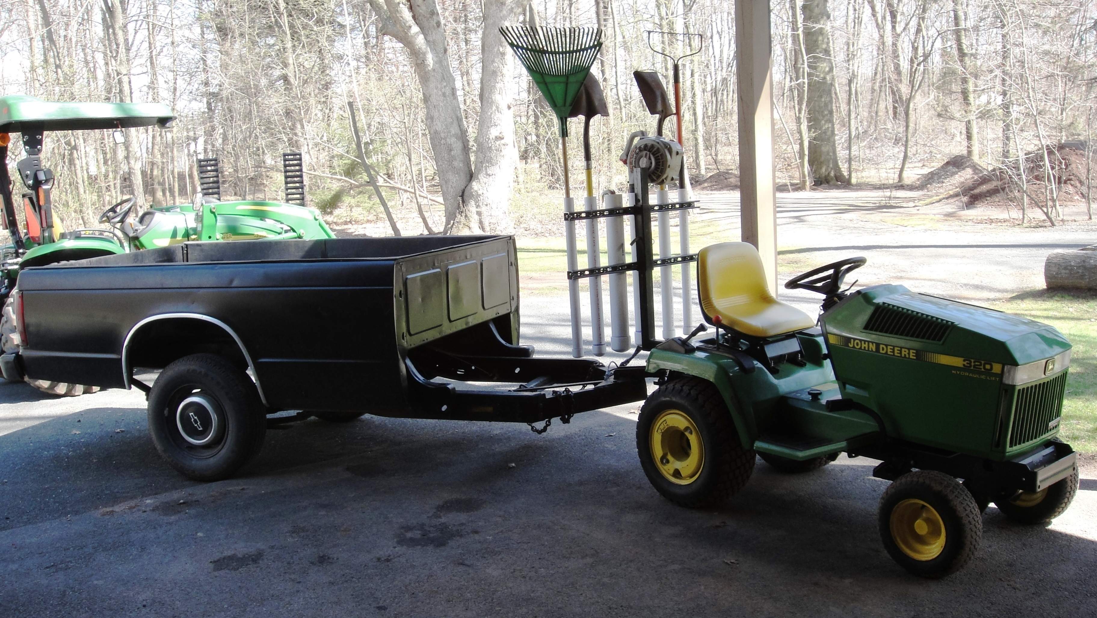

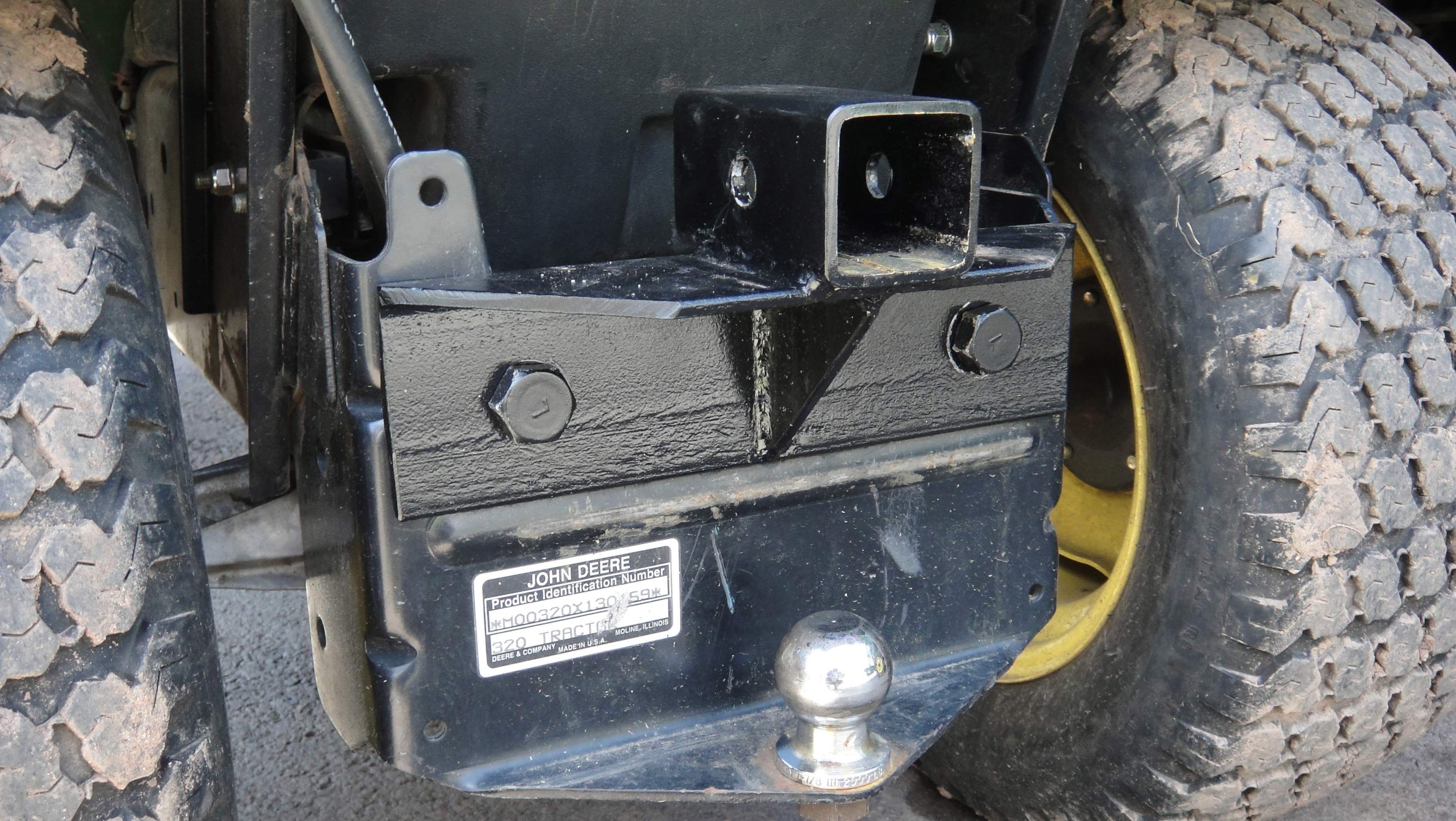

I did one recently myself, mine is a little higher. If yours is ever to low just flip the insert over and put the ball on top, you'll gain a couple of inches.
They are very useful for sure, you will be happy you did it. I only had the hole on the back for a ball but it was to low for my over the road utility trailer, It was only good for a lawn roller.
So I welded a 2 inch receiver to a piece of angle iron, and bolted that to existing holes on the back plate. I also made a contraption to hold tools, that slides into the hitch.

Don't go to far above axle. You will pull yourself over, that is why they are as low as they are.

Nice fab job. Just don't move the trailer up or down a significant grade. It's one thing to pull, but quite different to stop.
