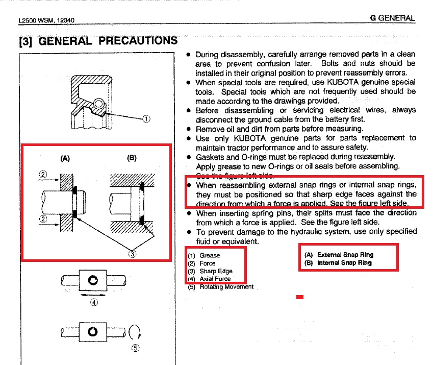

Do you know that circlips (spring clips) both internal and external need to be installed in one direction?
Installed the wrong way and there is a good chance they will come off.
This issue is so important all Kubota manuals include this info.
Dave M7040
Dave, just to follow up on this point, both my inner and outer circlips were symmetrical; no sharper edges or directionality that I could see. That said, I was able to discern which way they had been facing due to the wear marks or certain diameters, and reinstall them the same way.
