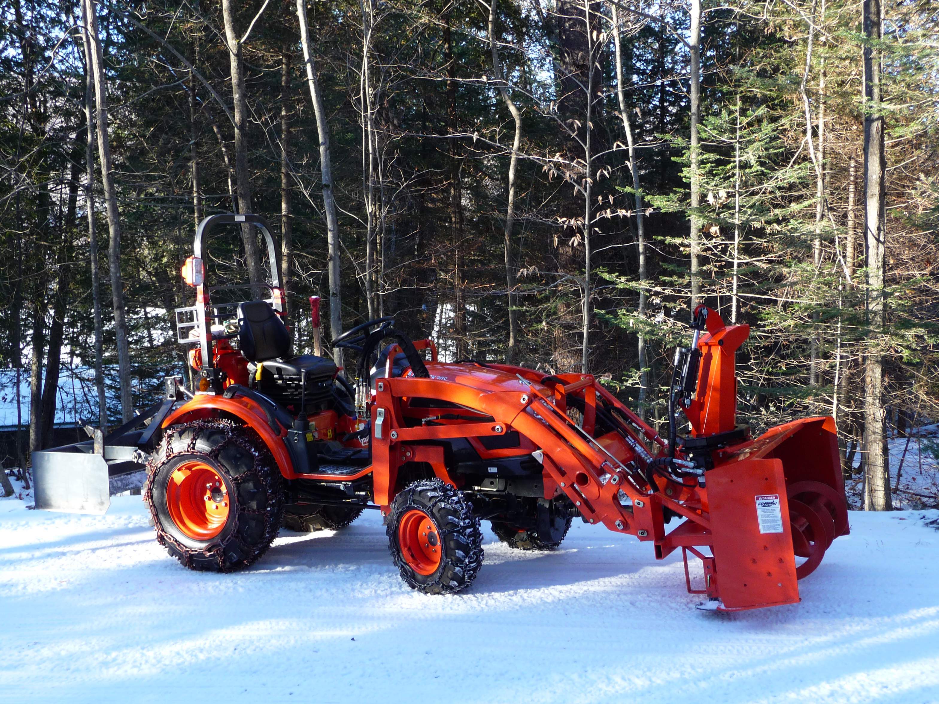

Minus the cab, I had to face about the same reality back here. Not so much experience also, I must say that the best advice I found here were:
1-Find a dealer you want to work with! A lot can go wrong (part of the fun I guess...)
2-Try it, see it, feel it, drive it!!!
3-On a personal note, a front mount is a bliss ti drive!
Best of luck finding a good dealer
Phil
