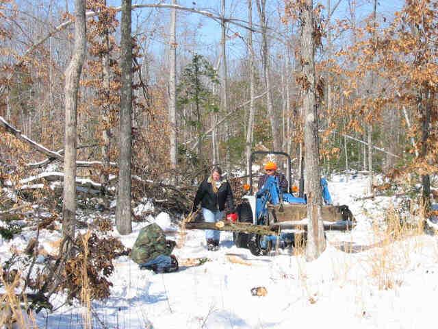

I really like my 4 in 1 bucket. If I ever buy another tractor, it will have one. I can use the jaws to grab stuff that won't fit in the bucket or would be a pain to have to wrap a chain around, like railroad ties, logs, stumps, etc. The attached picture shows using it to lift logs above the snow while cutting firewood - easier on the back of the sawyer and easier on chains. The dozer feature is also handy, even if you can't angle it like a snow plow. Not sure what your Dad will use the tractor for other than driving on the beach, but I am sure he would find the 4 in 1 bucket handy, if that is what it is. Let us know what he finds out.

I sure like the color of that tractor. I have a 7308 New Holland loader. I know I can add a bucket like that but I have two questions. How much for a bucket like that and do I need an auxillary hydraulic line for it. The auxillare line I want to get anyway so that isn't a big deal. Also I am sure I can't convert my existing bucket.
Murph
   / Tractor for Dad #30
Murph-
Since my tractor already had the 4 in 1 on it, I am not sure what is involved to add it. I know there is a separate control valve mounted below the joystick for the other bucket functions (perhaps a "power beyond" situation?). Then there are hydraulic lines running forward to the two pistons that operate the jaws of the bucket.
I think I have seen ads for Long (brand) 4 in 1 buckets. I know Carter offers them, and I am sure others could order and install them, but I have no real idea what they cost. You might run a search on 4 in 1 buckets. I know they have been discussed in other threads.
I also know, that even if it added $2000-3000 to the cost of a new tractor, I would add it because I have found it so useful. I would probably also try to add a skid steer type quick attach system that would allow me to easily switch to other buckets, forks or a grapple for handling brush. The 4 in 1 doesn't handle liquids well, cause they leak out the bottom, but I have had no problem with anything else I have used it on.
