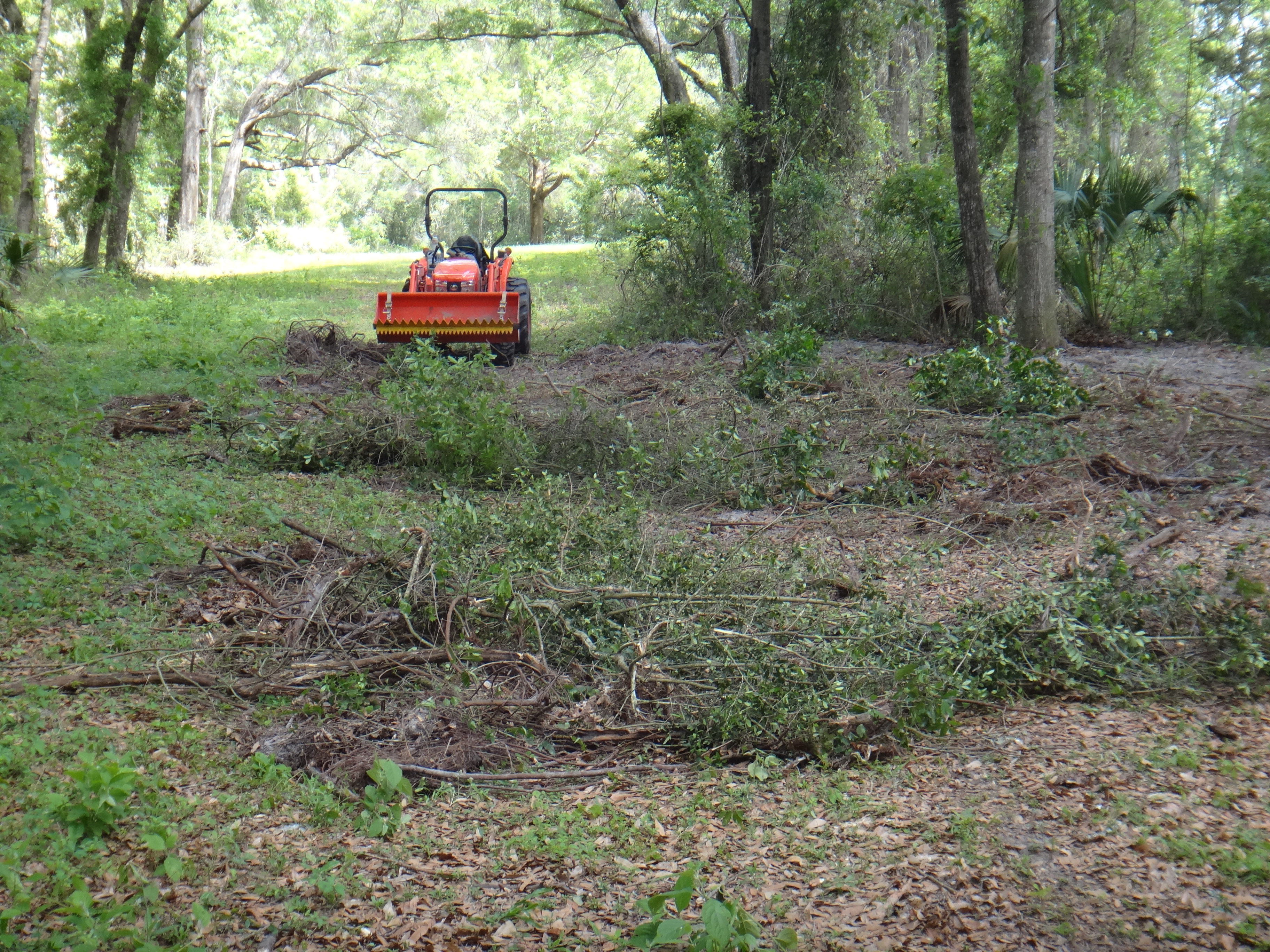

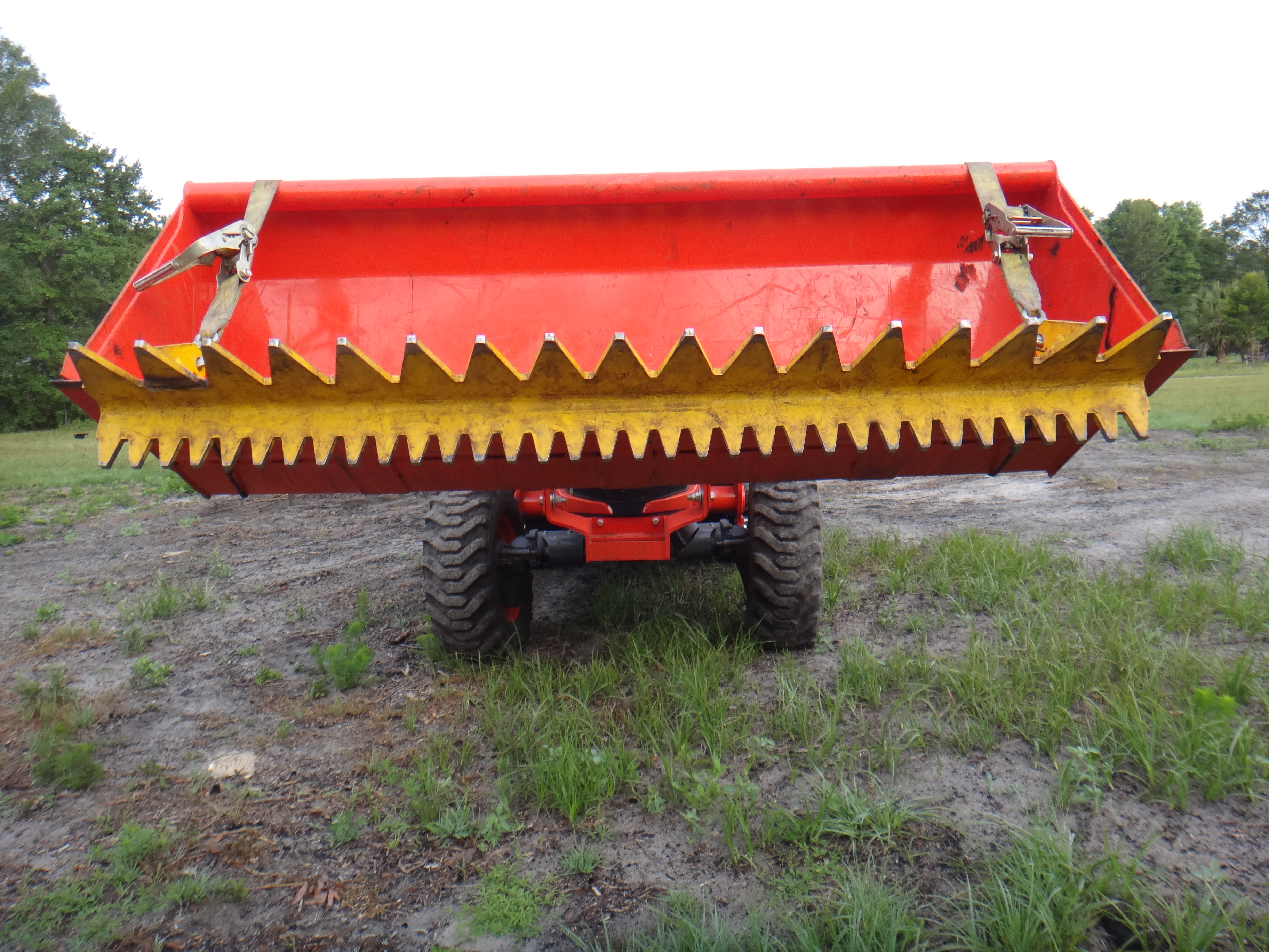

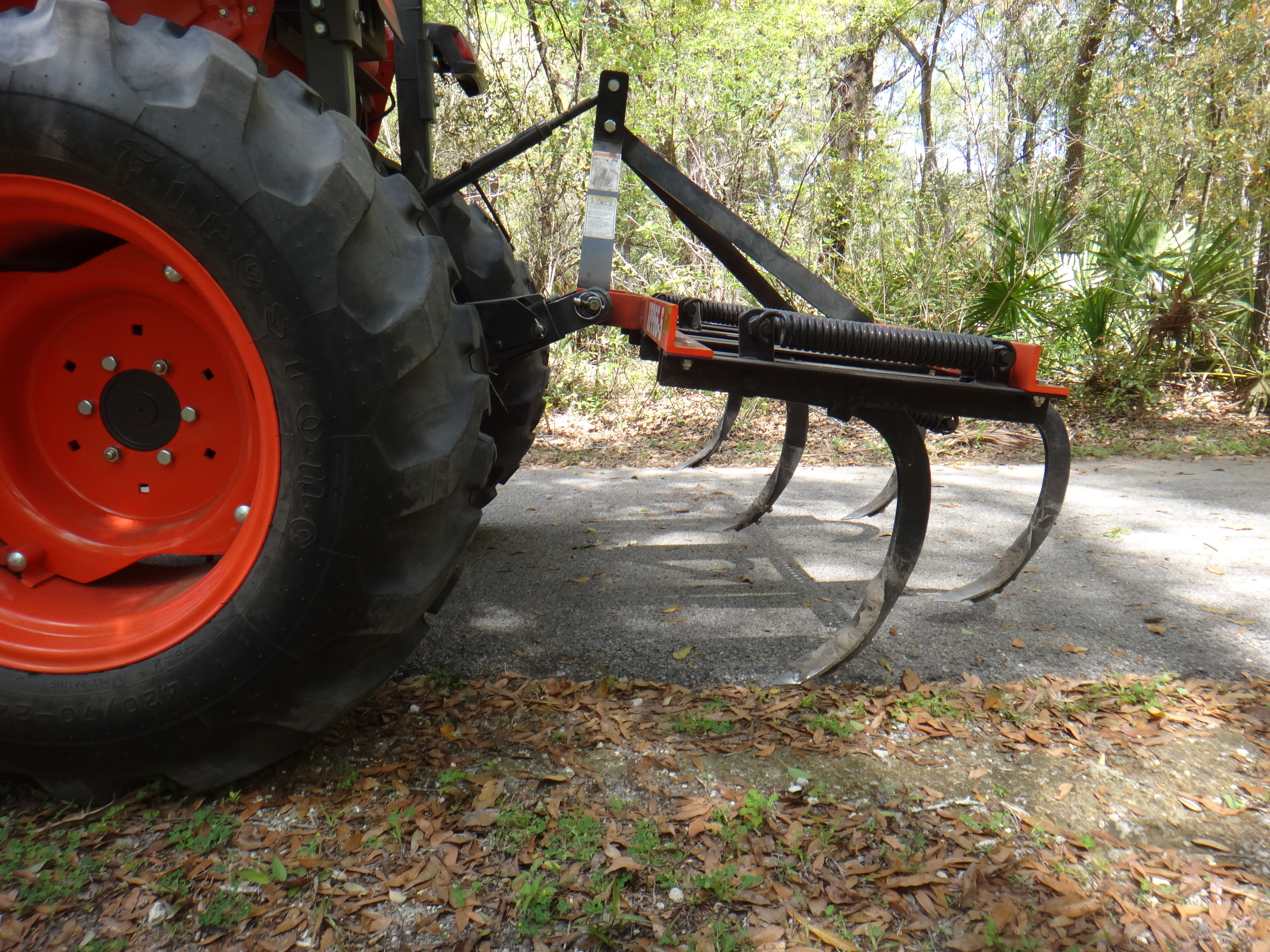

I do this work regularly, concentrating on one acre at a time. I have been at it years during which I have tested many implements.
The simplest rig consists of a 4-WD tractor with a minimum bare weight of 3,500 pounds. An FEL, and optional heavy-duty bucket will yield an operating weight of 5,000 pounds to 6,000 pounds. Example would be one of the utilitarian Kubota MX series.
Tractor weight is the key metric for ground contact work, NOT horsepower. Every tractor brand has offerings in this weight.
KUBOTA: http://www.kubota.com/product/MX4800/MX4800.aspx

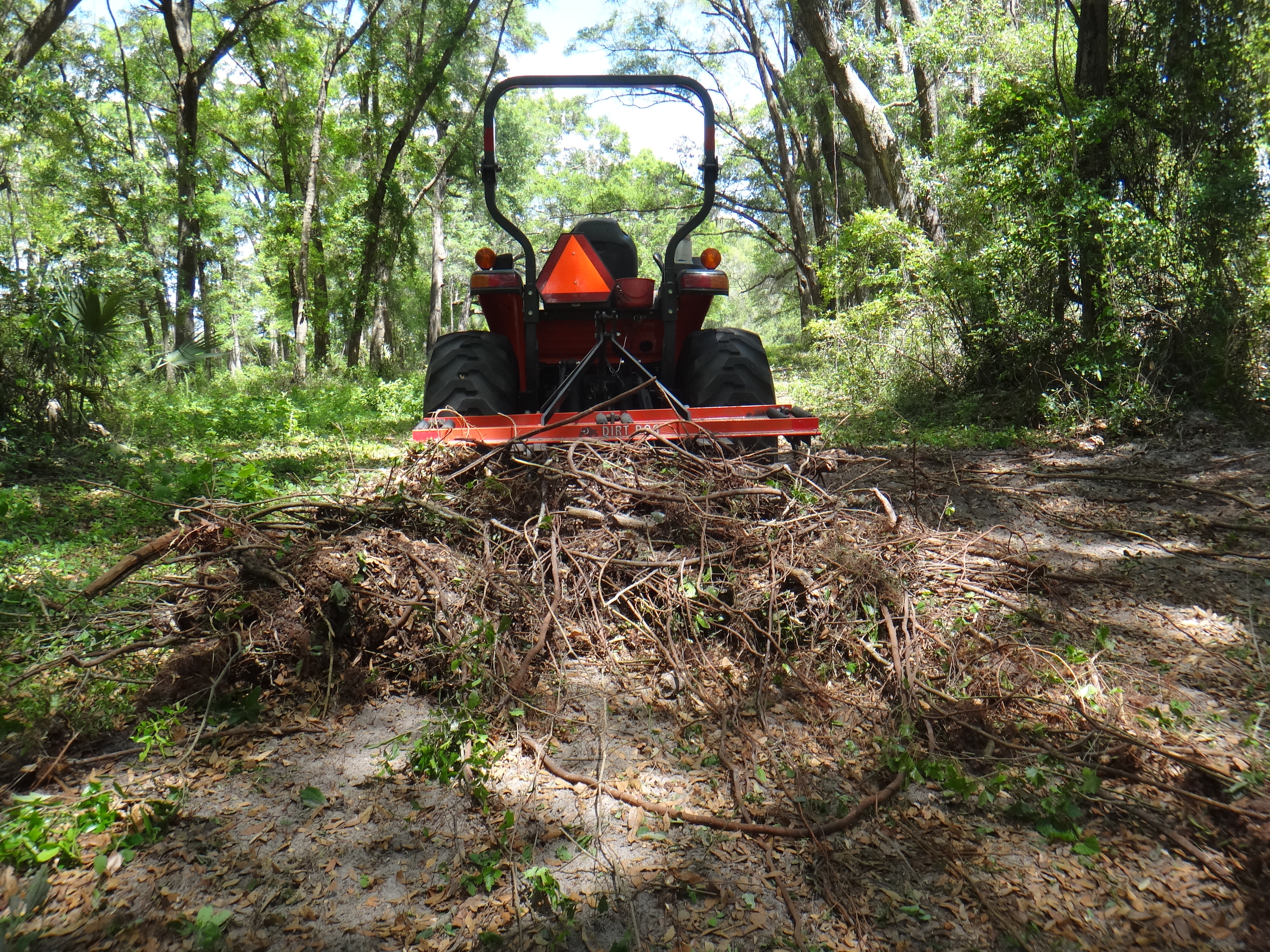

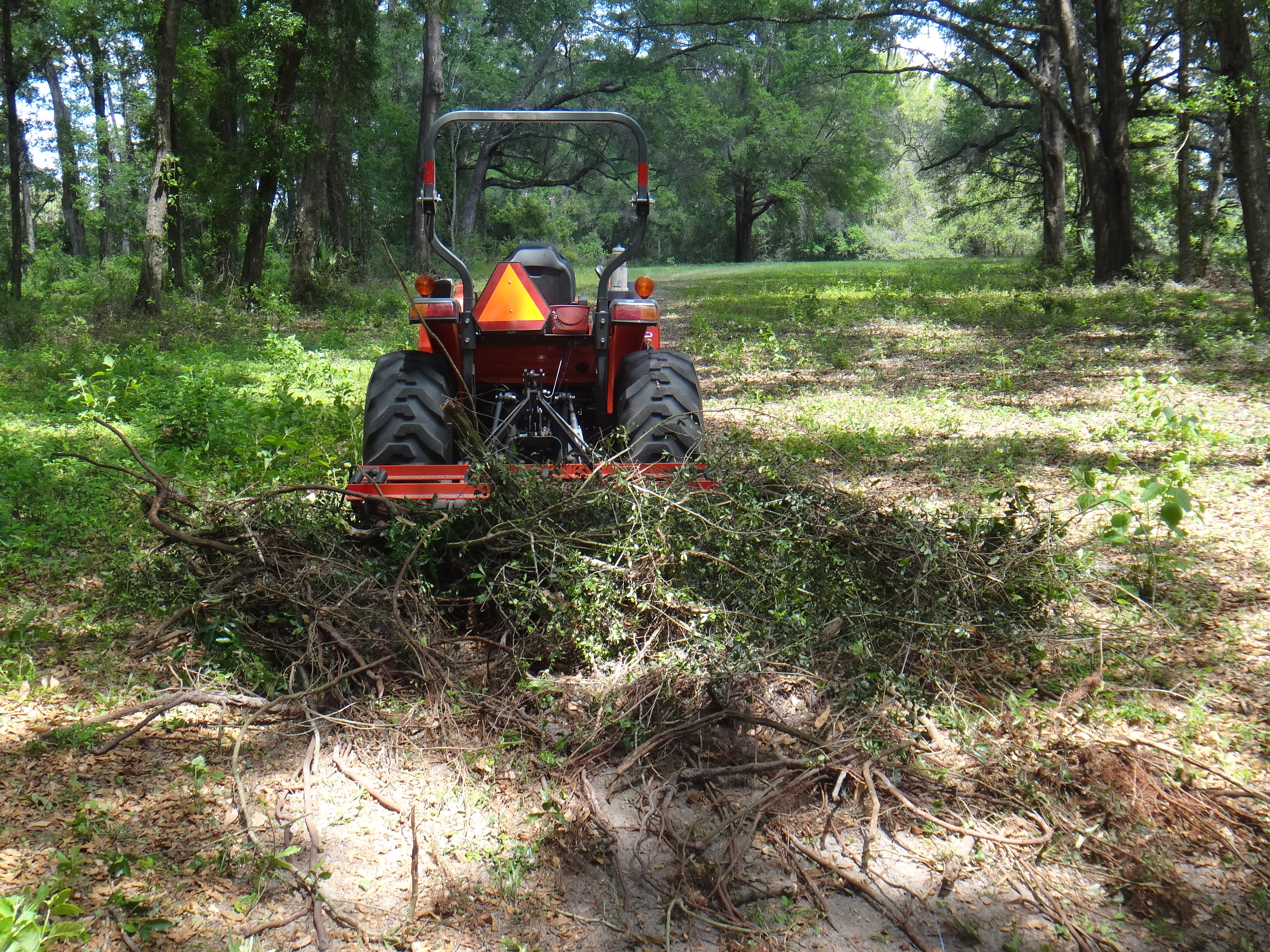

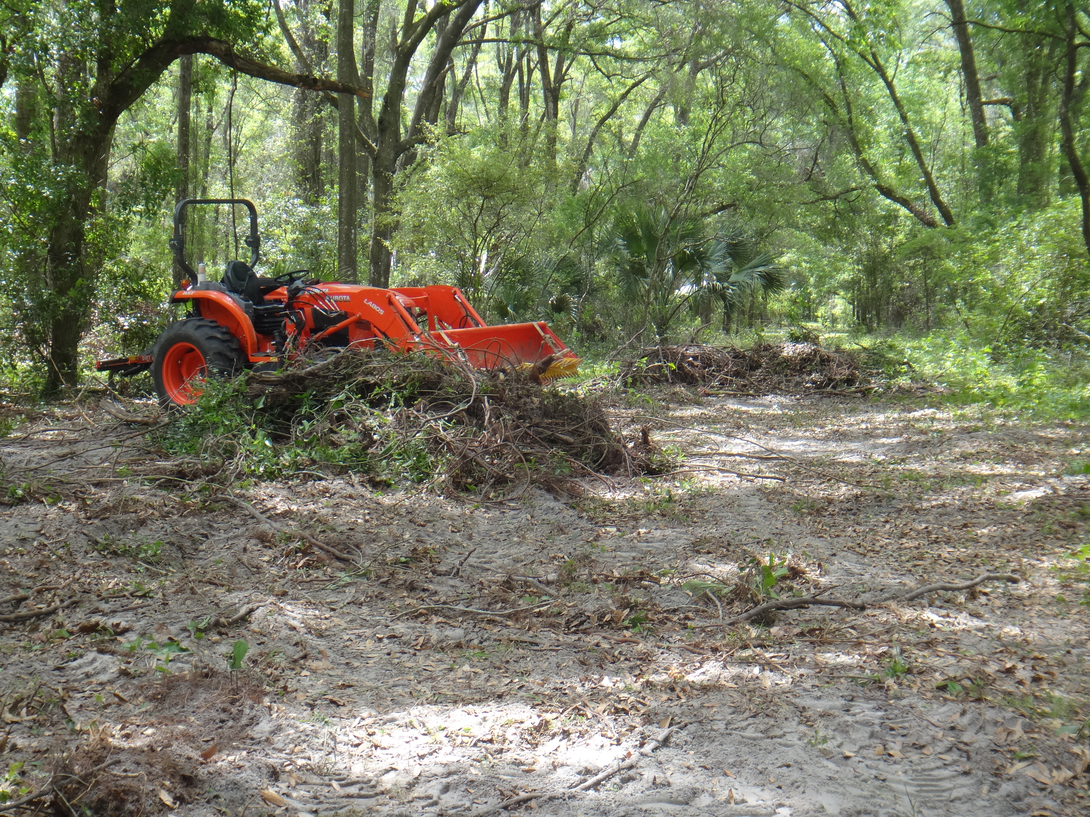

Add a $400 Ratchet Rake bucket attachment to the front, mount a $900 spring-protected Field Cultivator on the Three Point Hitch. Have at it.
http://www.tractorbynet.com/forums/attachments/339095-dirt-dog-all-purpose-plow.html?highlight=
The Ratchet Rake tears out brush. It pulls vines from trees. Later, it piles debris pulled up by the Field Cultivator. Ratchet Rake is functional for penultimate grading after drawing the Field Cultivator over your ground. VIDEO: ratchet rake brush clearing - YouTube
Field Cultivator pulls out subsurface roots and corms. Usual working depth is ten inches. With experience Field Cultivator can be adjusted to rip/collect at fourteen inches. Later, Field Cultivator hooks into debris piled by the Ratchet Rake and pulls debris to your burn pile. Field Cultivator fairly smooths your work area. VIDEO: How to Use a Ripper / Field Cultivator - Gardening Series - YouTube
The Ratchet Rake and Field Cultivator have short learning curves. Both are easy to attach/mount to the tractor. Significant benefits for tyro tractor owners. I remember how I struggled to mount and operate a heavy Box Blade efficiently for road maintenance after I purchased my first new Kubota.
A heavy Landscape Rake WITH GAUGE WHEELS is good for ultimate smoothing. A Chain Harrow WITH FRAME LIFT would be equally good.
Now you are ready to seed, then roll/firm seed to soil with a Three Point Hitch mounted Cultipacker.
With exception of Photo #1, photos taken during past four days.
