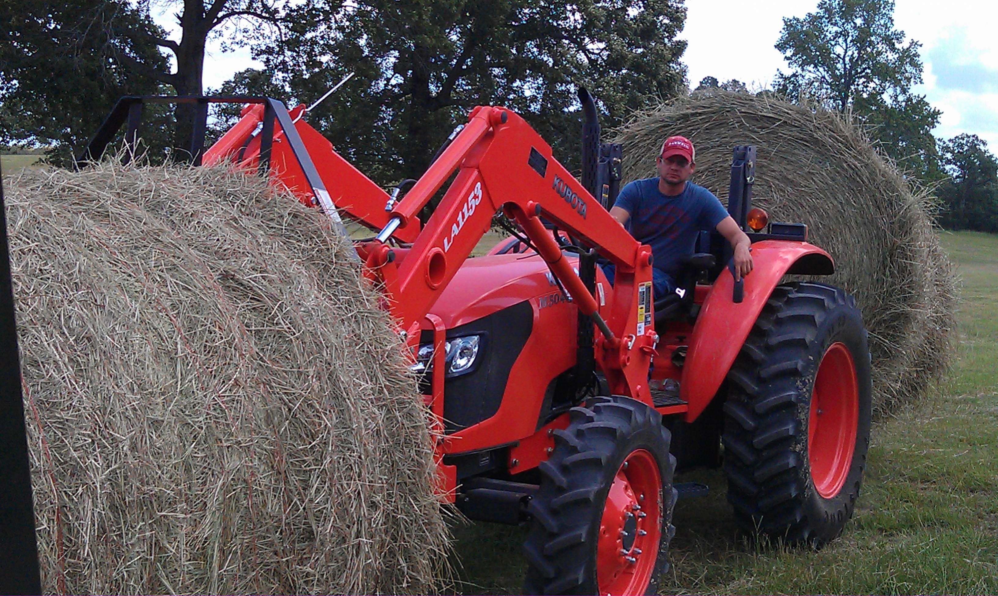

Yes.....I am getting some great advice. About a month ago I was able to sit down at the Case dealership and wouldn't hesitate to purchase from them. I have been leaning towards the Farmall C series with cab because they are a low profile which will help around my trees. I think I will concentrate more on the 85+HP range as I will probably be moving larger round bales in the future. We will move onto the property in about 5 weeks so I still have some time to research and learn from this site.
tractor1 (ADQ v1).jpg Thats my 50HP moving 5x6 bales

I think you are on the right track here. Heavier is better when moving bales. While many of the smaller tractors will do it as evidenced by the photo of the the kubota above, a larger tractor will do it better and will hold up better over time. You are going to want a fairly powerful tractor for haying as well. I do believe that your dealers are correct on saying that 75 hp is the minimum. Sure you can run a round baler with less hp. I ran a 5x5 baler in a pinch with a 3020 jd and it did ok. Seventy hp or so worked, 85 made it work pretty good and the hundred and five hp of the white that I owned at the time made it talk real sweet.
A few years later I now have a more than enough tractors to choose from and all different hay equipment. Running to 4020 JD's a Ford 3000 (which it pretty much going to be relegated to dragging my riding arena now) and just bought a year old TD5050 New Holland. I am also in that market for another loader tractor right at the moment as I just closed the deal on another farm bringing me up to three places.
The 95c will pull a medium sized disc moco fairly well, and will run most big round balers pretty decently. At the moment I run a shade over a hundred pairs, four bulls, and between my horses and the boarders horses I have around 20 horses at any given time. I could if they were all at the home place get away with running just the TD5050 which is nearly identical to the farmall 95 without issue though I would keep a second loader tractor in reserve just in case of a break down, because no matter what the critters still need to be fed. Being that I have three places spread over ten miles and will be working up to 300 plus pairs I need a bit more equipment.
