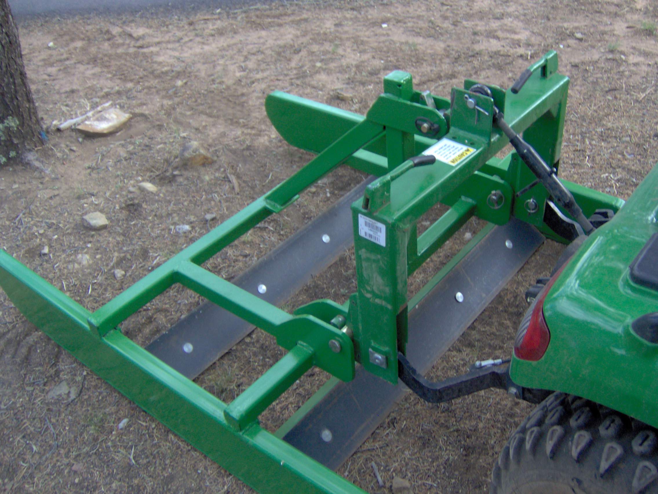

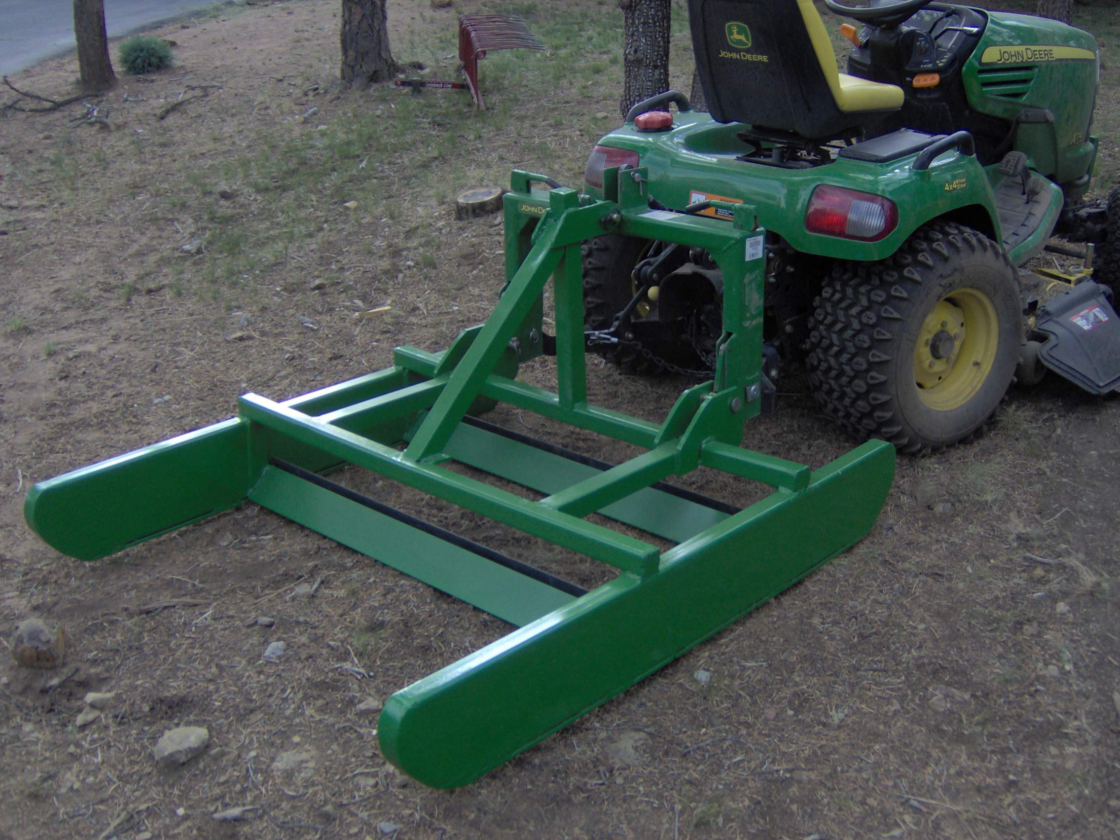

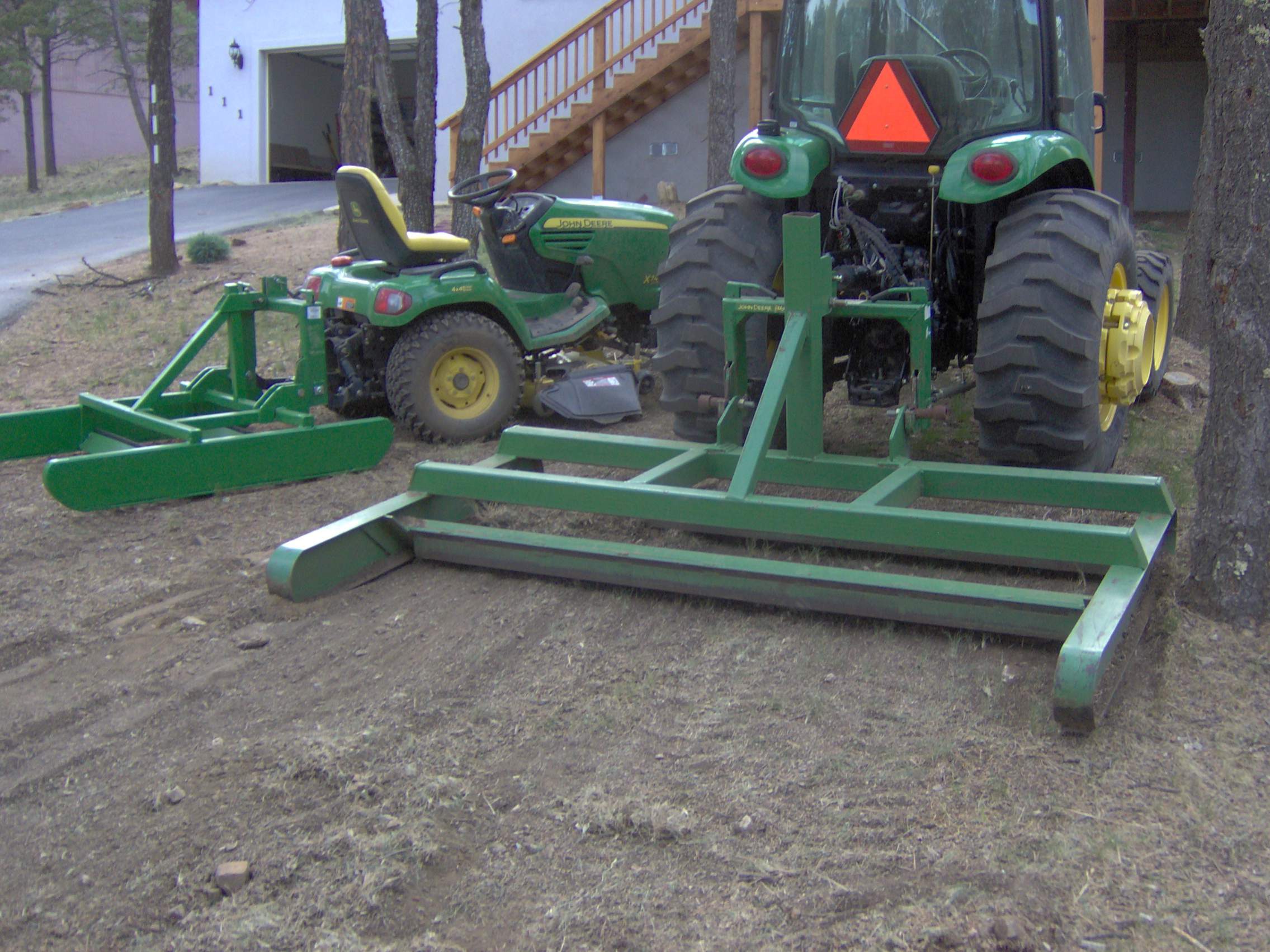

Just a suggestion but a large landplane would be easier and cheaper to build and would yield good results. Not familiar with standard implements in the UK but here in the US I would consider a landplane grader blade for your 200 hp McCormick to be 14' wide with 10' skids. With large grader blades and stout frame it should weigh in about 1 1/2 to 2 tons. With a 10 foot running surface and 14 foot width this would give you a very smooth surface.
Several members here have built their own landplane grader blades with great success and the designs vary a little but all seem to work. You might wan't to look at some of the threads on the forum as there are many. Here are two that I built, one 4' and one 8'.

Nice builds, what wall tube did you use on the smaller one?
I wonder if adding some longer runners to my box blade would be of benefit.
   / Tractor drawn grader #7
Don't remember the exact thickness, but heavy wall 3/16" or better. More to add weight than strength or rigidity, total weight is about 420lbs. These were drops purchased from my steel supplier. When I built the skids I used 3/8" flatbar welded to the running surface and wrapped this around the open ends to close the tubing.
About adding skids to a box blade, I suspect it would help quite a lot with finish smoothing. If I were to add skids I would have a pivot point located directly over the blades and set the depth flush. Stops in the front to allow some limited tilt or oscillation yet provide alignment for the front of the skids. You could have three sets of holes in the rear to allow for depth adjustment and a vertical slot in the front to allow tilt and oscillation. I should mention that I suggest using bushings welded in place to allow an inch of clearance and prevent wallowing the holes.
This way you can weld nuts on the box blade sides and use bolts of the proper length making it easily removed or installed depending on the box blade use. When not used you would only have the four nuts sticking out on the sides about four inches above the ground. I haven't done it yet but do have the plans on the back burner now.

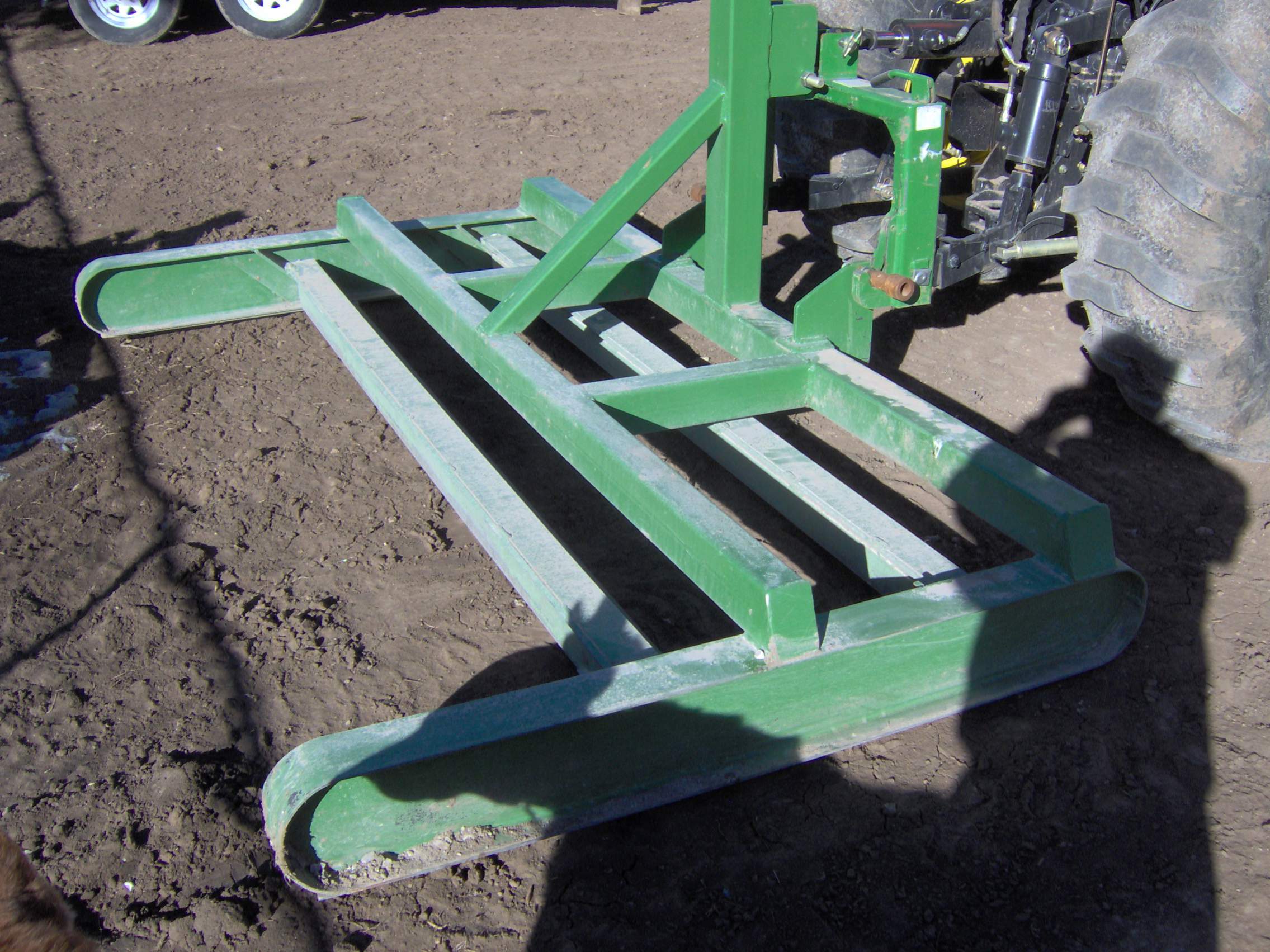

The easiest way to do it would be a drag. Google arround for "King road drag" or "split log drag".
I made one to put crown on a dirt(not gravel) road. Will try to get a pic of it tommorow. I also built a pull type grader, but without any turntable or tilt ability. See my first post for pics of that one.

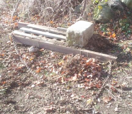

   / Tractor drawn grader #12
I forgot to take a pic while I was using it, so you can't see the hardened cutting edge on the bottom edge of the leading 18"-20" of the front blade. It is welded on about 1/2" below the bottom of the front blade. That cutting edge goes on the ditch side of the road and scrapes up a little dirt. The dirt flows to the middle of the road, but without a hard cutting edge on the rest of the blade, the dirt goes under the blade and is pushed into the road surface.

   / Tractor drawn grader #14
That's almost an exact copy of the King Road Drag.
