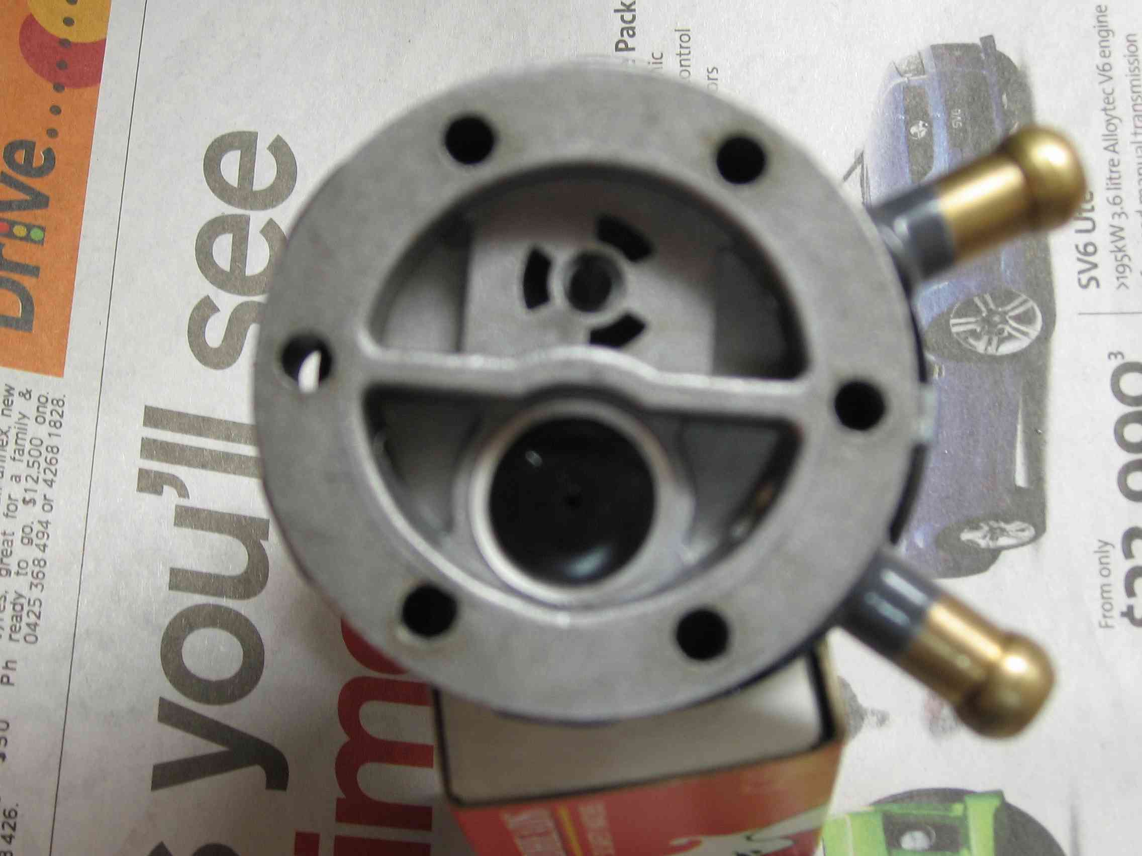

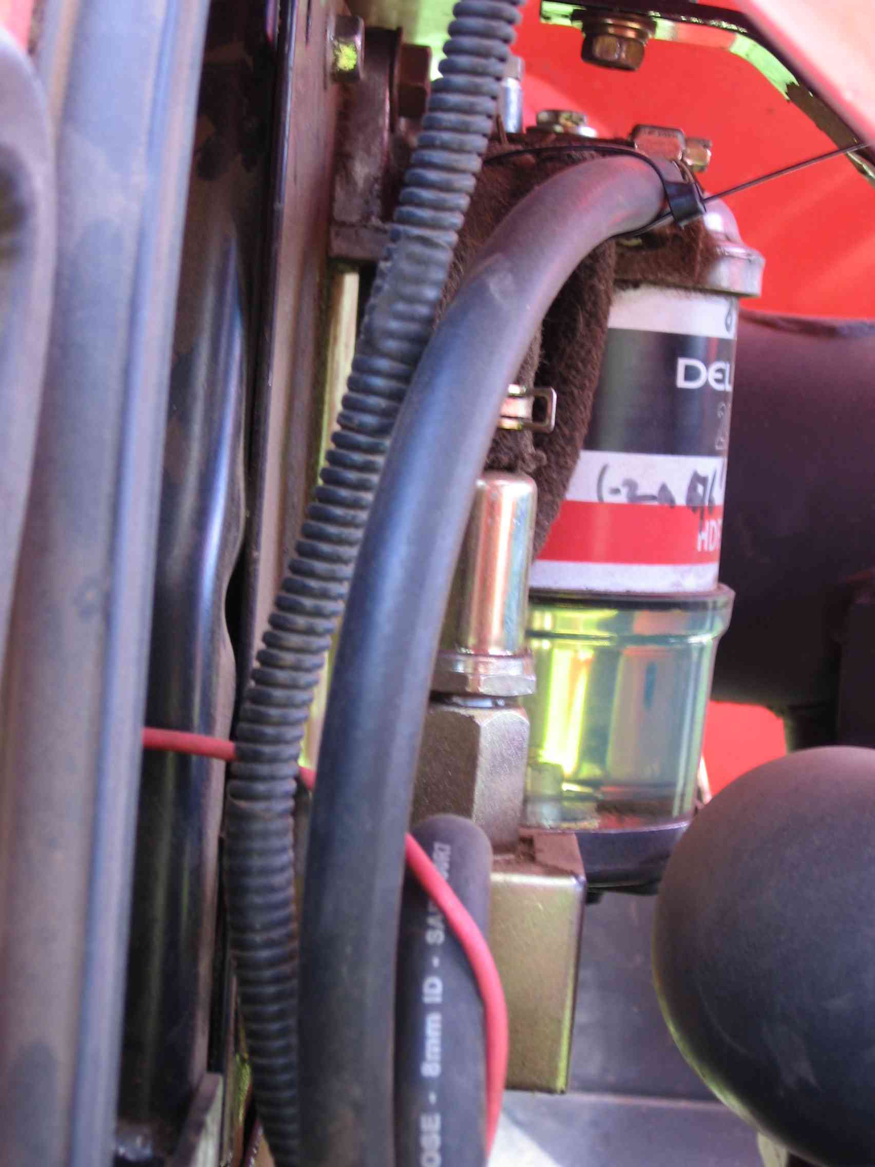

I have the DK501 (Australia) I had a similar problem with it 3 months ago
Turned out to be 2 things
1- one glow plug burnt out
2- the fuel lift pump check valves hardened
I replaced all 4 glow plugs, the tractor had 160 hrs on the meter
With the fuel pump I tried to get replacement check valves (told by local dealer that pump not a service item - new pump required $140 AUD + postage)
I sourced a electric lift pump for $120 AUD and also fitted a suction filter seperator The electric lift pump alows me to prime the fuel system before the glow, so I now turn the switch to assessories - fuel pump runns wait 3 seconds then turn to run position wait 6 seconds for glow then start.
This proces has allowed first start every time, and allows fuel mfilter changes/inspections then priue
Tractor now has 210 hrs and no further problems
