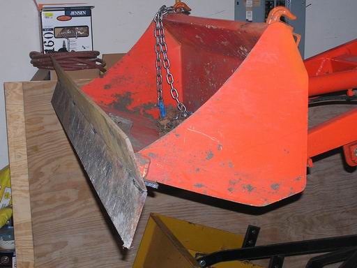

Here's my alternative to a bota front blade.
Since I had the left over steel, all I have invested is my time and a few $$$ for welding it up.
I did a job where I needed to push some loose dirt, and level it out. Figured something like this would work faster than just using the FEL.
FYI, it's 3/8 x 4 strap. Held to the bucket with two 1/2" bolts, so it goes on/off easy.
Enjoy.
