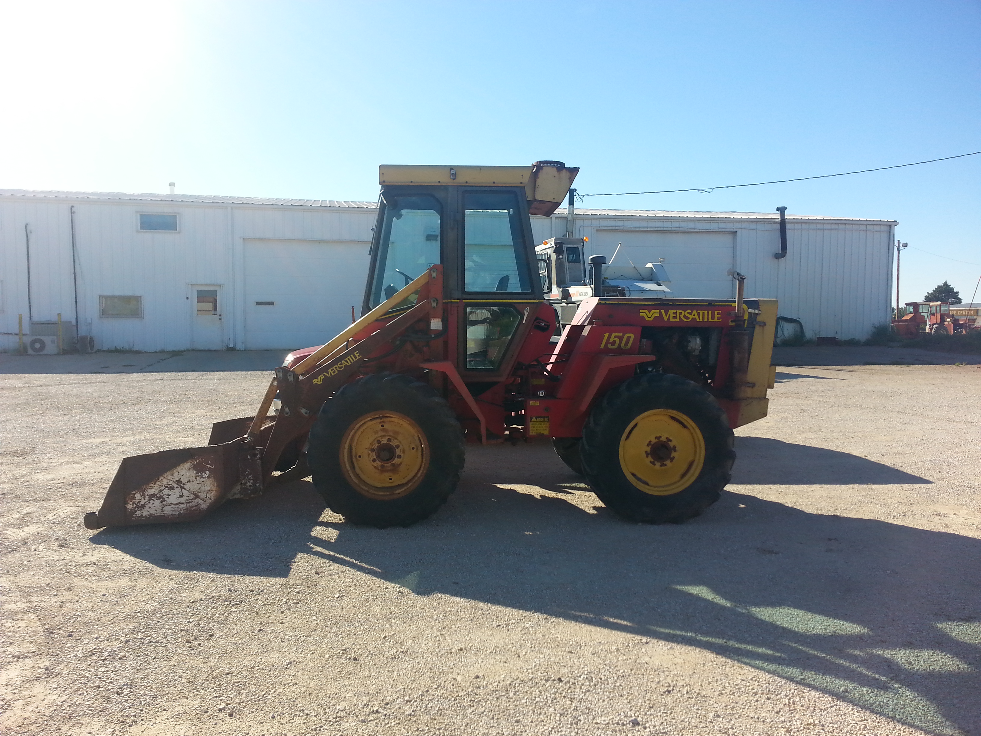

I just had to do it a Versatile 150 Bi-Directional. Now I have joined the world of hydrostatic as well as articulated.
I am not sure of the year. This model was built 77-81 but it only has 3900 hours and has not been used hard. It has set outside though and so it needs some TLC. I can't wait to play with it!
I know the rules - no pic it didn't happen!
Hello, just wanted to give a shout out to a fellow 150 owner. I've owned one for about 4-1/2 years as a loader tractor on my acreage and the main reason was to run a snow blower. Really like it for that.
About two years ago I purchased a skid steer mount conversion for the loader, now I can use most of the skid steer attachments on it, to date I only own a bucket and a set of forks, a grapple will be next.
Yours is a nice looking machine, mine is a little more weathered, a 1977 model, yours is later 80 or 81, the glass in the lower door tells that, the early ones were sheet metal there.
I think you'll find it a very handy machine (probably already have!)

Thanks for introducing yourself! I know mine is a Series II so I figured it was at least a '79. I am not tuned into the changes by year. I have found it very useful thus far although it does sink into the lawn more than I thought it would.
I can certainly see getting an SSQT setup for it and some forks and a grapple. It was pretty cool the other day pulling up to a downed tree with the bucket and working underneath it, then chaining it up, and lifting it a little. Then turning the seat around and pulling it about a 1/4 mile to my burn pile. the front of the log was off of the ground so it did not dig. I was able to see very well while getting into it and also not having to back up all that way.
Today I used for it work platform to get on the roof of my house and barn to do some repair.

My seat is facing the loader, have been reluctant to turn it as I worry all those 40 year old wires and hyd hoses to the console don't have many twists and turns left in them before they give trouble, looks like a real major project to replace any of those, tilting the cab up would be required the way it looks.
They are hard on the lawn, especially turning with no differential between the front and rear drive shafts causes wheel churn, mine is compounded by having the no-slip (locking) rear end on the engine end, great during snow removal, a detriment for most other tasks, especially hard on the lawn, limiting tight turning helps. Really wish this locking rear end was like many of the farm tractors where it could be locked in or out but near as I can research this is or is similar to a Detroit Locker used in trucks.
Overall it's a hard setup to beat, especially on the snow blower which is the main reason I purchased one, not sure there's a better setup for that, certainly nothing in the same price range.
