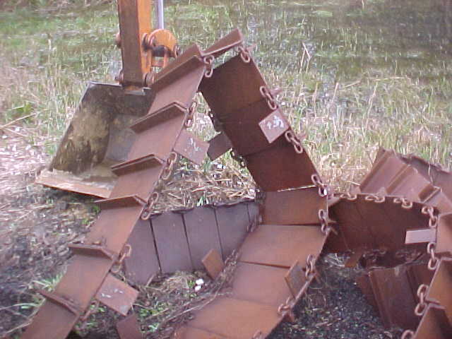

Hi,very interesting project.How much do those babies weigh?How do they work driving thru mud/snow?Do you tend to sink down or do they support the tractor better in the mud and snow?I was thinking of something similar but not sure if i'll have the fender clearance.
Mike
/ tracks #22
Looks like it would be a bumpy ride with those tracks. The traction difference must be pretty substantial too.
/ tracks
#23
I have been in Alaska since last April so I have been away from computers. to answer you about a bumpy ride, actually they are smooth as the tire flexes and takes the pump of the pads coming down out. The traction and floatability is highy increased. They make no noise as the tire keeps them tight. They are a heavy, but you don't notice that at all except for enhanced stability. The tractor is not carrying them like added on weight. Being they are on the tires, there is no added stress on the axles, no different than adding calcium to the tires.

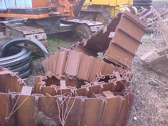

I'm still hoping to see a picture of these "road warrior" tracks.
/ tracks
#29
here you go. I didn't button them together, but you can get the idea by these pics. There is a smaller set for the front and I always widen out the tires to give me fender and turning room when I put them on for real. As you can see the tractor takes on a whole new attitude.

Man, what a great idea. I know for sure after yesterday, brush cutting I punctured the front tire with a stop. Fortunately just a small plugable hole. Unfortunately, I'm not capable of making these tracks, but I sure could use some. When are you going into business making these? thanks for sharing with us, John
/ tracks
#32
Kioti
The feeling of a stob going through a tire is heart wrenching, I know the feeling. These have worked very well for me. I could knock out some, but the frieght would be horrendous unless a person lived close to me.
/ tracks #33
LOL, freight's out of the question as is living close. I can't get much further away from you in this country, being in Florida! I thank you for sharing those tracks though. Maybe I can get my brother to try making them. He's a "fair" welder so I'm not sure what he can do. I know I sure hate that I'm going to keep getting flats! John
/ tracks #34
I'd like to thank you for taking the trouble of setting the track up so we could get a good idea of what you built.
