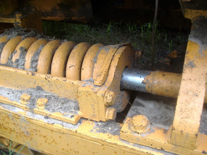

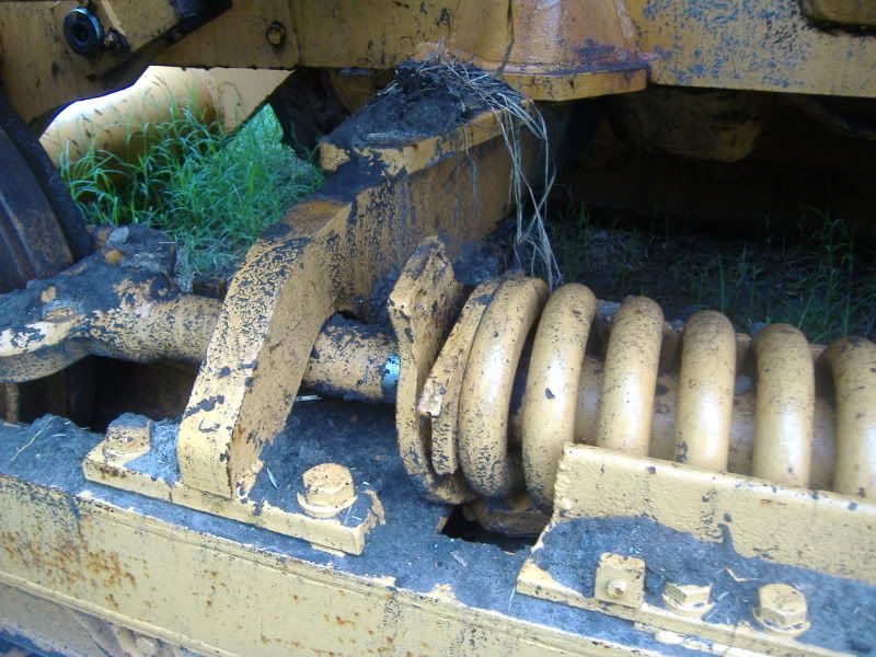

Below are pics of the spring cap I was talking about. It appears that the reason the left track has no slop/droop is because the track tension spring is further expanded due to a broken bracket which the spring cap is supposed to bolt to. The spring cap on the left side is just sliding loose on the idler wheel piston.
http://i20.photobucket.com/albums/b249/dcara/Springcaploose.jpg
As can be seen in the pic of the right side, the spring cap is bolted to a bracket on the end of a piece of angle iron which is bolted to a support member.
http://i20.photobucket.com/albums/b249/dcara/Springcapbolted.jpg

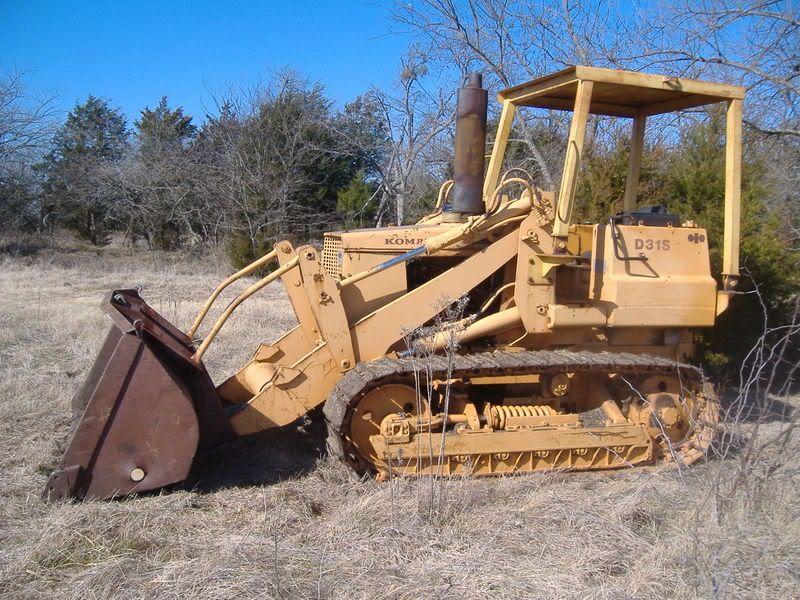

Here's a full pic of my D31 showing track tension, spring etc.
http://i20.photobucket.com/albums/b249/dcara/Loaderleft.jpg
I think I can weld the broken left side bracket but I have to first compress the spring about 2 inches to get the cap into the proper position.
Anyone have an idea on how I can compress the spring?
   / Track Tension #4
take a couple of round STEEL pins and put them into the sprocket back the machine up and the spring will compress right back do NOT loosen the grease fitting in the track first though as that will push all the grease out of the adjuster and you will not be able to pull the spring back far enough
   / Track Tension
Do you mean to put the pins in the valley of a couple of rear sprocket teeth so that the pins will be between the track and sprocket when I start to back up? Then as I backup to where the pins are in the 3 o'clock position the track will pull the idler wheel piston back into the jack?
I see how that forces the idler wheel piston back into the jack, but what is pushing on the spring to compress it? Also, is it possible to damage the rollers on the track this way?

The pin in the sprocket idea works great! I was able to compress the spring enough to fish out the broken bracket shown below. Since there is still free room between the end of it and the end of the cavity it appears that the spring is completely uncompressed now (and always has been) after I took the pins out of the sprocket. The spring and jack assembly appear to be bolted to the track frame via the angle piece that broke where the spring cap bolts to. I was thinking I wanted remove the angle piece to weld the spring cap back on it but am concerned that there mightbe still some compression in the spring. Any thoughts on the best way to weld the angle piece back together?
Also, the 2 bolts holding the spring cap the the broken angle piece are currently frozen in place. They appear to be 15/16 six sided heads. Any suggestions on the some ways I might try to get them off? I was thinking about heating up the bolts with my torch to see if that might loosen them.
